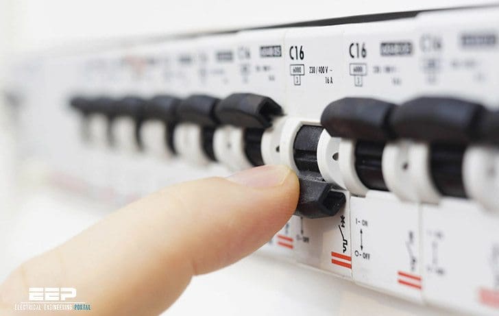

What Would Be The Worst Type Of Three Phase Faults And Why It Happens (photo credit: everreadyelectric.com)
It must be noted that in a majority of cases, the fault current calculation required for the selection of interrupting and withstand current capabilities of equipment is the three phase bolted fault with zero impedance.
