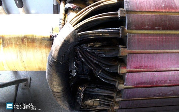

When a 3-phase motor expirience phase failure, what a mess…
When a 3-phase motor expirience phase failure, what a mess… (photo credit: mawdsleysber.co.uk)

    To whom it may concern,
    The lead picture depicts the brush pattern of a Direct Current machine not a Three Phase Induction Alternating Current machine
    See
    https://www.google.com.au/search?hl=en&site=imghp&tbm=isch&source=hp&biw=1247&bih=597&q=three+phase+motor&oq=three+pah&gs_l=img.1.3.0i10i24l5.2333.12742.0.17178.20.12.8.0.0.0.335.2724.2-10j1.11.0..2..0…1.1.64.img..1.19.2765.ZxidnFS9SPg
    Regards
    Derek Bailey
      Edvard
      Feb 15, 2016
      Thanks for noticing Derek, pic replaced with correct one.
