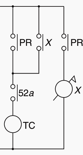

2.1 Shunt Tripping Scheme
This is the most commonly used tripping scheme. The protective relay (PR) contact is arranged directly to trip the circuit breaker and it simultaneously energises an auxiliary unit X which then reinforces the contact that is energising the trip coil. The scheme is shown in Figure 1.
All the above-mentioned tripping schemes envisage the use of separate DC supply for tripping. An alternative scheme using the fault current to trip the circuit breaker is called a series tripping scheme.
Shunt tripping scheme
Figure 1 – Shunt tripping scheme

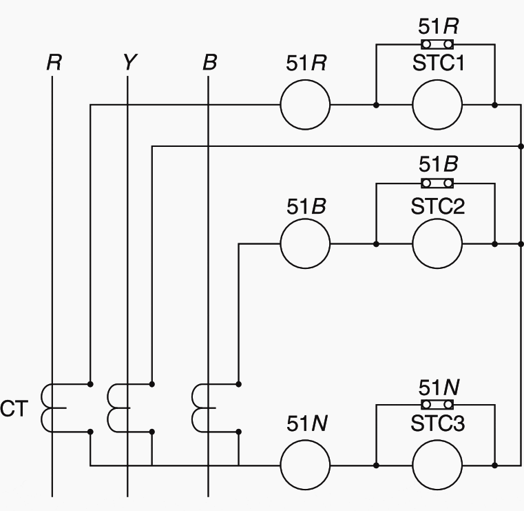

2.2.1 Using Relays
Here the series trip coil is normally kept shorted through the NC contacts of the series tripping relays. The trip coil comes into the circuit and trips the circuit breaker when the relay contact opens at fault.
The circuit is shown in Figure 2.
Series tripping scheme
Figure 2 – Series tripping scheme

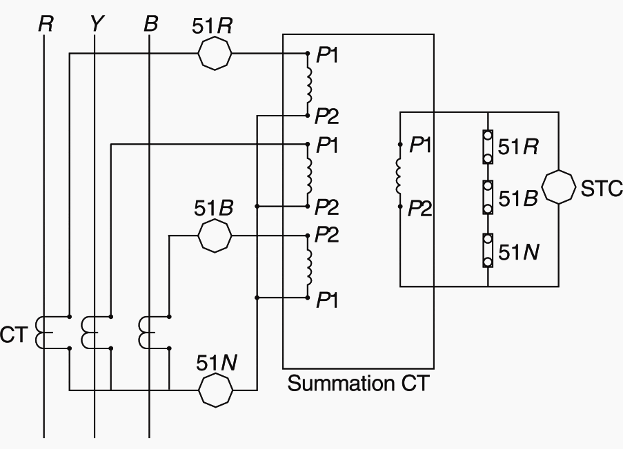

2.2.2 Using Summation CT
This scheme is similar to the one using relays but here a summation CT is used to summate the current of all the three phases, thereby minimising the requirement of three series trip coils to one.
The summation CTs are LT CTs which sum up the secondary current output of HT CTs of three phases and provide a proportional single-phase output.
The series trip coil is connected to the output of the summation CT and normally shorted through relay NC contacts. The scheme is shown in Figure 3.
Series tripping using summation CTs
Figure 3 – Series tripping using summation CTs

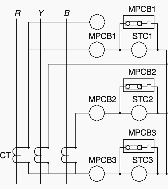

2.2.3 Using Motor Protection Circuit Breaker (MPCB)
MPCBs are manual motor starters with thermal and electromagnetic trip features. Normally the trip coil is kept shorted through the MPCB. The MPCB blows off during a fault, and thereby pushing the fault current through the trip coil which, in turn, trips the circuit breaker.
This process is shown in Figure 4 below.
Series tripping using MPCBs
Figure 4 – Series tripping using MPCBs

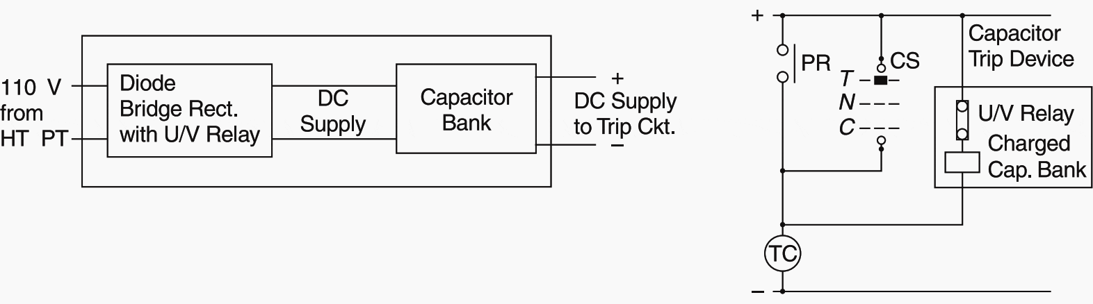

2.3 Capacitor Tripping Scheme
For installations where DC supply is not available or where it is uneconomical to provide battery / battery charger for DC supply or where the stations are unattended and battery maintenance cannot be guaranteed, a circuit using capacitor banks is employed to provide tripping energy to the breaker trip coil.
It employs a three-phase full wave rectifier bridge with diodes for DC output and capacitive circuit for storing energy. The diode rectifier bridge is powered by the secondary of the HT PT.
In normal service, tripping on faults is done through the diode bridge rectifier’s dc supply. In abnormal conditions of failure of HT PT supply, the tripping energy is derived from energy stored in the charged capacitor banks. Normally the capacitors are rated to store energy for two trip and one close operation.
The scheme is shown in Figure 5.
Capacitor trip circuit
Figure 5 – Capacitor trip circuit

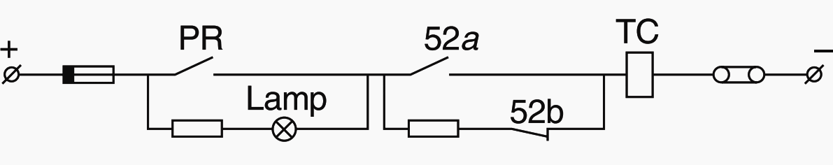

The simplest arrangement contains a healthy trip lamp, as shown in Figure 6.
Supervision while circuit breaker is closed
Figure 6 – Supervision while circuit breaker is closed
The resistance in series with the lamp prevents the breaker from being tripped by an internal short-circuit caused by failure of the lamp. This provides supervision while the circuit breaker is closed.

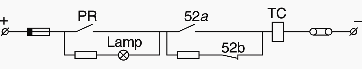

Figure 7 shows how, by the addition of a normally closed auxiliary switch and a resistance unit, supervision can be undertaken while the breaker is both open and closed.
In either case, the addition of a normally open push button contact in series with the lamp will make the supervision indication available only when required.
Supervision while circuit breaker is open or closed
Figure 7 – Supervision while circuit breaker is open or closed

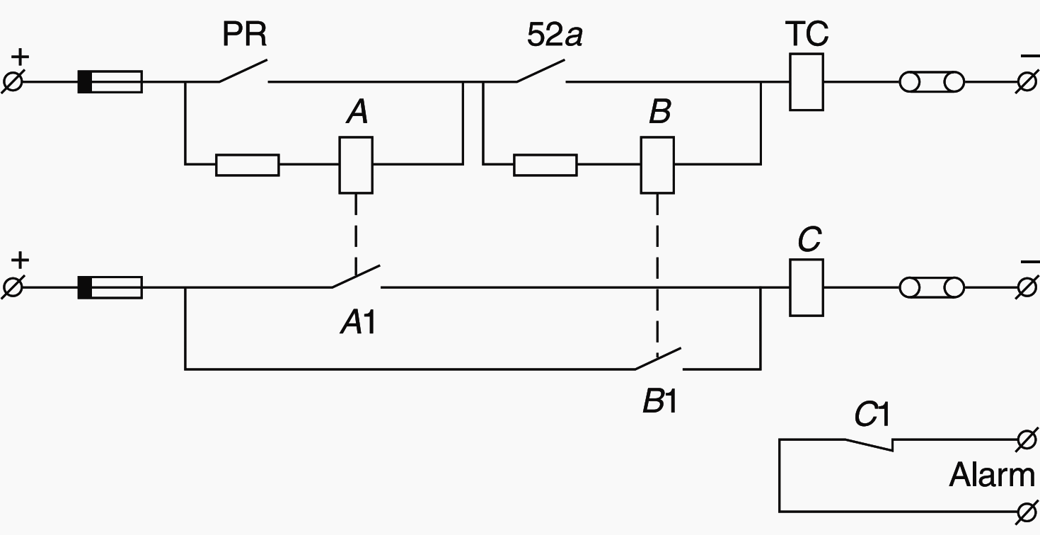

Figure 8 illustrates such a scheme, which is applicable wherever a remote signal is required.
Supervision while circuit breaker is open or closed with remote alarm
Figure 8 – Supervision while circuit breaker is open or closed with remote alarm
Scheme working principle
Under healthy conditions with the circuit breaker closed relays A and C are energized. If the trip circuit opens or the trip supply fails, relay A drops off and opens contact A1 to de-energize relay C. When the circuit breaker is open, relay B is also energized via the normally closed auxiliary switch of the circuit breaker and relay C is held in by contact B1.
Relay B will detect trip circuit abnormalities with the circuit breaker open in a similar manner as relay A with the circuit breaker closed.
Relay C is time delayed on drop-off by means of an RC circuit for a total time of 350 to 800 milli-seconds, to prevent a false alarm due to voltage dips caused by faults in other circuits or during a normal tripping operation, when relay A is momentarily short-circuited by the self re-set tripping relay contact.
If the trip relay fails to re-set, possibly due to the failure of the circuit breaker tripping mechanism, the alarm is initiated.
The alarm supply should be independent of the tripping supply so that an indication will be obtained in the event of the failure of the tripping battery.

  5. David Renshaw
    Oct 08, 2018
    Edvard,
    Good article; one slight glitch: fig. 6 is identical with fig. 7, but they describe different situations. Fig. 6 was presumably not intended to have the n/c auxiliary contact (52b).
