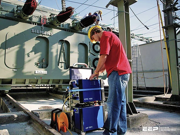

Once oil filling is completed, various pre‐commissioning checks and tests are performed to ensure the healthiness of the transformer (or reactor) prior to its energization. Various electrical tests must be performed and their significance and short description are given below.
Transformer pre-commissioning tests and after-receipt checks you MUST perform
Transformer pre-commissioning tests and after-receipt checks you MUST perform (photo credit: Omicron)
Let’s start with transformer pre-commissioning checks and tests and later on with after-receipt checks:

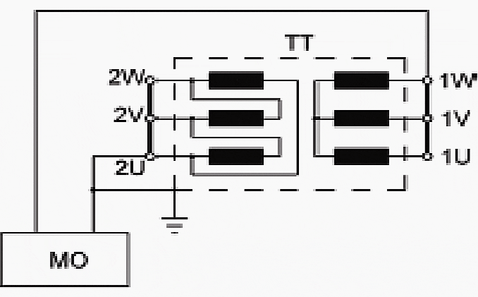

Principal measuring circuit for the insulation resistance measurement
Figure 1 – Principal measuring circuit for the insulation resistance measurement
The test is conducted with the help of mega‐ohmmeter. IR is proportional to the leakage current through/over the insulation after capacitive charging and absorption currents become negligible on application of DC voltage.
Insulation resistance shall be measured after the intervals of 15 sec, 60 sec and 600 sec.
The polarization index (PI) is defined as the ratio of IR values measured at the intervals of 600 and 60 seconds respectively. Whereas, the dielectric absorption is the ratio of IR values measured after 60 sec and 15 sec.
IR is normally measured at 5 kV DC or lower test voltage, but the test voltage should not exceed half the rated power‐frequency test voltage of transformer windings.

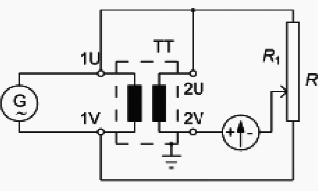

1.6 Turns ratio (Voltage ratio) measurement
To determine the turns ratio of transformers to identify any abnormality in tap changers/ shorted or open turns etc.
Measurement of turn ratio is based on, applying a phase voltage to one of the windings using a bridge (equipment) and measuring the ratio of the induced voltage at the bridge. The measurements are repeated in all phases and at all tap positions, sequentially.
During measurement, only turn ratio between the winding couples which have the same magnetic flux can be measured, which means the turn ratio between the winding couples which have the parallel vectors in the vector diagram can be measured.
Theoretical turn ratio = HV winding voltage / LV winding voltage
The theoretical no‐load turn ratio of the transformer is adjusted on the equipment by an adjustable transformer. It is changed until a balance occurs on the % error indicator. The value read on this error indicator shows the deviation of the transformer from real turn ratio as %.
% Deviation = 100 x ((Measured TR) ‐ (Designed TR)) / (Designed TR)
Where TR is turn ratio. The % deviation of the turn ratios should be ≤ 0.5 %.
Basic circuit ratio bridge
Figure 2 – Basic circuit ratio bridge

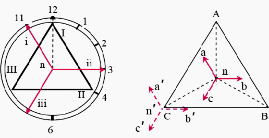

1.7 Vector Group and Polarity
This test is used to determine the phase relationship and polarity of transformers. Depending on the type of the transformer, the input and output windings of a multi‐phase transformer are connected either as star (Y) or delta(D) or zigzag(Z).
The phase angle between the high voltage and the low voltage windings varies between 0⁰ and 360⁰.
Representing as vectors, the HV winding is represented as 12 (0) hour and the other windings of the connection group are represented by other numbers of the clock in reference to the real or virtual point.
For example, in Dyn 11 connection group the HV winding is delta and the LV winding is star and there is a phase difference of 330⁰ (11×30⁰) between two windings. While the HV end shows 12 (0), the LV end shows 11 o’clock (after 330⁰).
Determining the connection group is valid only in three phase transformers. The high voltage winding is shown first (as reference) and the other windings follow it.
If the vector directions of the connection are correct, the bridge can be balanced.
Also, checking the connection group or polarity is possible by using a voltmeter. Direct current or alternating current can be used for this check. The connections about the alternating current method are detailed in standards.
An example of this method is shown on a vector diagram below.
Connection group representation and measuring
Figure 3 – Connection group representation and measuring

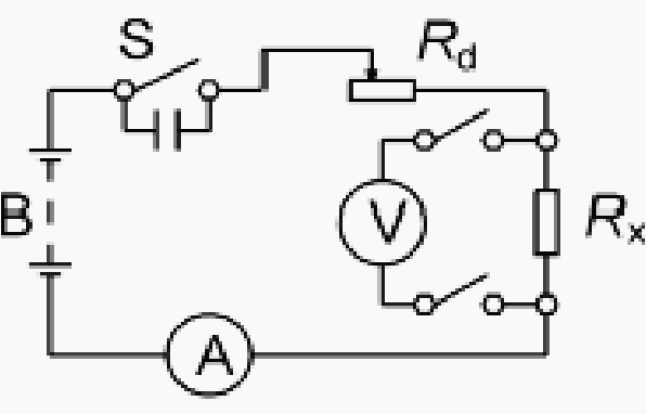

“Voltmeter‐ammeter method”
The measurement is carried out using DC current. Simultaneous readings of current and voltage are taken. The resistance is calculated from the readings in accordance with Ohm’s Law. This measurement may be performed using conventional analog (rarely used nowadays) or digital meters.
However, today digital devices such as Data Acquisition Systems (DAS) with direct resistance display are being used more and more.
The measuring circuit is shown in figure 4.
Voltmeter ‐ ammeter method measuring circuit
Figure 4 – Voltmeter ‐ ammeter method measuring circuit
Where:
  • RX = Unknown resistance (transformer under test)
  • Rd = Regulating resistor
  • S = Circuit breaker with protective gap
  • B = DC source
Resistance RX is calculated according to Ohm’s Law:
R= U / I
The advantage of this method is the simplicity of the test‐circuit. On the other hand, this method is rather inaccurate and requires simultaneous reading of the two instruments.

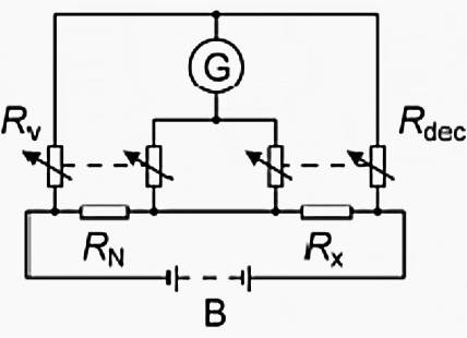

Resistance measurement using a Kelvin (Thomson) Bridge
This measurement is based on the comparison of two voltage drops: namely, the voltage drop across the unknown winding resistance RX, compared to a voltage drop across a known resistance RN (standard resistor), figure 5.
Kelvin (Thomson) Bridge method
Figure 5 – Kelvin (Thomson) Bridge method
Where:
  • RN = Standard resistor
  • Rdec = Decade resistor
  • RV = Variable resistor
  • G = Galvanometer
  • B = DC source
DC‐current is made to flow through RX and RN and the corresponding voltage drops are measured and compared.
The bridge is balanced by varying the two resistors Rdec and RV, which have relatively high resistance values. A balanced condition is indicated when the galvanometer deflection is zero, at which time the following relationship holds: RX = RN × Rdec / Rv
The influence of contact resistances and the connection cable resistances (even of the connection between RX and RN) can be neglected.

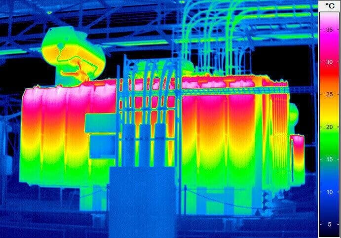

1.19 Thermovision infra‐red scanning (IR thermography)
A thermo vision Camera determines the temperature distribution on the surface of the tank as well as in the vicinity of the Jumper connection to the bushing.
The information obtained is useful in predicting the temperature profile within the inner surface of tank and is likely to provide approximate details of heating mechanism.
Thermovision scanning of transformer to be done at least after 24 hours of loading and repeated after one week.
Thermography inspection of the power transformator
Figure 6 – Thermography inspection of the power transformator

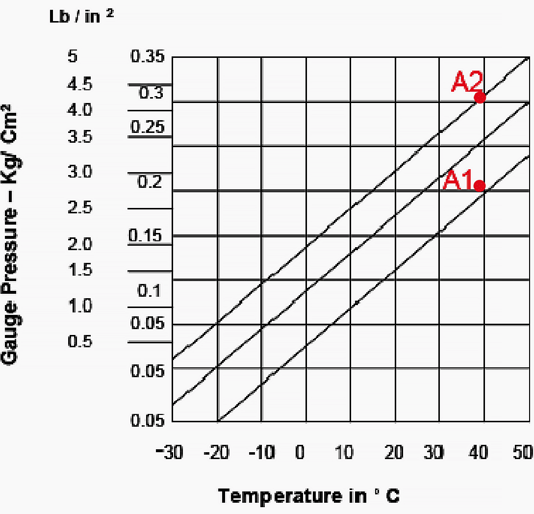

N2 pressure and Dew point to be checked after receipt of transformer at Site. It should be within permissible band (as per graph provided by manufacturer and given below in Figure 7).
Below graph shows variation of pressure v/s temperature of gas-filled unit during transport or storage.
Graph depicting variation of N2 gas pressure w.r.t. temperature
Figure 7 – Graph depicting variation of N2 gas pressure w.r.t. temperature
Example – For 40°C temperature (depending upon the pressure of gas at the time of filling):
  • Minimum pressure of gas can be 0.185 kg/cm2 at point A1
  • Maximum pressure of gas can be 0.32 kg/cm2 at point A2

    • Madhav
      Jan 04, 2019
      There is a certain procedure and criteria for evaluation for vector group identification.. e.g. here in our country most of the dist, tfs are having vector group Dyn11.. for identification of this vector group normally the following checks are performed-
      connect (short) the HV R terminal (1U) and LV R terminal (2U) together…
      apply some voltage from HV side (say 400V) and then verify the following conditions:
      Voltage between the terminals ( HV terminal: 1U,1V 1W and LV terminal: 2U, 2V, 2W)
      1) 1V2W = 1V2V
      2) 1U2N+1V2N = 1U1V and
      3) 1W2W < 1W2V
      Hope this will help you,
      Sincrely,
      Madhav.
