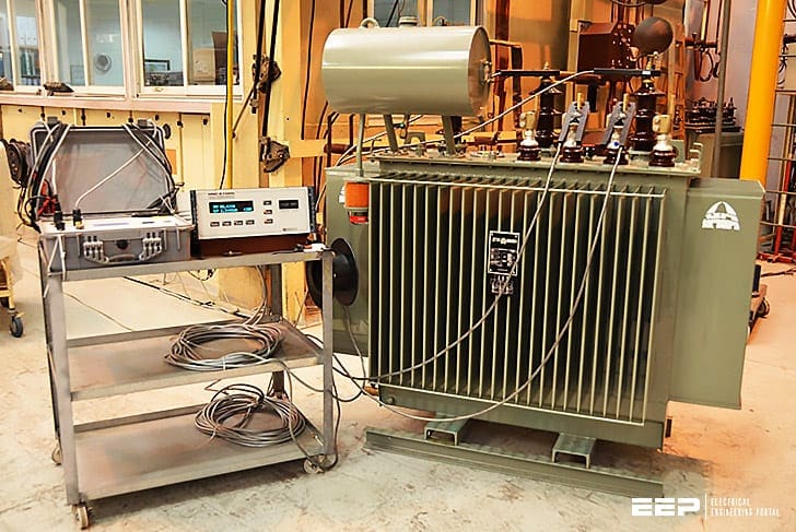

Transformer no-load loss and excitation-current measurements (photo source: ardantrafo.com)
Maximum values of the no-load loss of transformers are specified and often guaranteed by the manufacturer. No-load-loss measurements are made to verify that the no-load loss does not exceed the specified or guaranteed value.

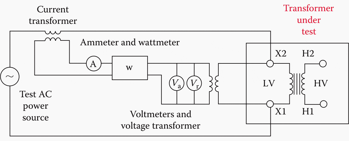

The measurement of no-load loss, according to the average-voltage voltmeter method, is illustrated in Figure 1. Voltage and current transformers are required to scale the inputs for voltmeters, ammeters, and wattmeters.
Three-phase no-load-loss measurements are carried out the same way, except that three sets of instruments and instrument transformers are utilized.
Test circuit for no-load-loss measurement
Figure 1 – Test circuit for no-load-loss measurement
The test involves raising voltage on one winding, usually the low-voltage winding, to its rated voltage while the other windings are in open circuit. Two voltmeters connected in parallel are employed.
The voltmeter labeled Va in Figure 1 represents an average-responding, rms-calibrated voltmeter. The voltmeter labeled Vr represents a true rms-responding voltmeter.
Harmonics in the impressed voltage will cause the rms value of the waveform to be different from the average-absolute (rms-scaled) value, and the two voltmeter readings will differ. When the voltage reading, as measured by the average-responding voltmeter, reaches a value corresponding to the rated voltage of the excited winding, readings are taken of the rms current, the rms voltage, and the no-load power.
The ratio of the measured rms current to the rated load current of the excited winding, expressed in percent, is commonly referred to as the percent excitation current. The measured no-load loss is corrected to a sine-wave basis by a formula given in the mentioned IEEE test code, using the readings of the two voltmeters.
The correction is shown below. The corrected value is reported as the no-load loss of the transformer.
