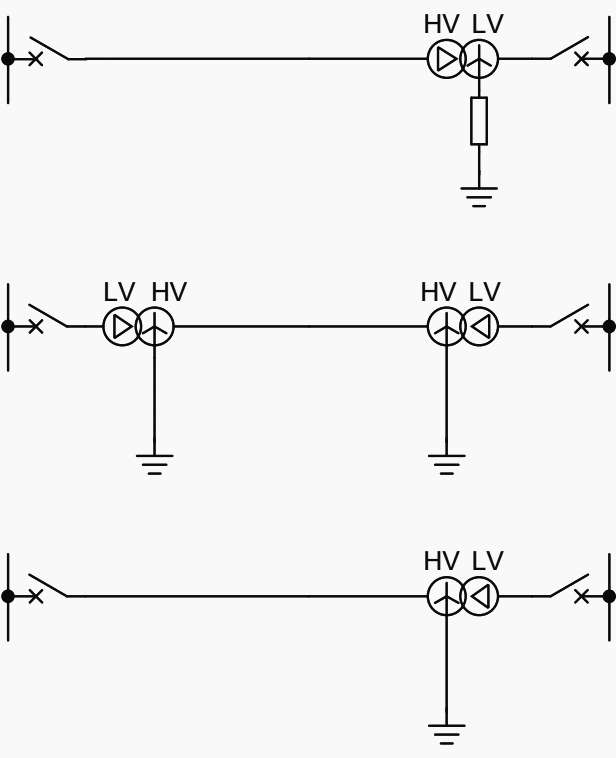

Typical transformer-feeder circuits
Figure 1 – Typical transformer-feeder circuits
In the latter case, the separate protections can both be unit type systems.
An adequate alternative is the combination of unit transformer protection with an unrestricted system of feeder protection, plus an intertripping feature.

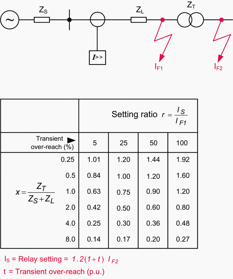

1.2 Feeder phase faults
A distance scheme is not, for all practical purposes, affected by varying fault levels on the high voltage busbars and is therefore the best scheme to apply if the fault level may vary widely.
In cases where the fault level is reasonably constant, similar protection can be obtained using high set instantaneous overcurrent relays.
These should have a low transient over-reach (t), defined as:
Low transient over reach (t)
where:
  • Is = setting current
  • IF = steady state r.m.s value of the fault current, which when fully offset, just operates the relay.
The instantaneous overcurrent relays must be set without risk of them operating for faults on the remote side of the transformer.
Referring to Figure 2, the required setting to ensure that the relay will not operate for a fully offset fault IF2 is given by:
Setting current
Where IF2 is the fault current under maximum source conditions, that is, when ZS is minimum, and the factor of 1.2 covers possible errors in the system impedance details used for calculation of IF2, together with relay and CT errors.
As it is desirable for the instantaneous overcurrent protection to clear all phase faults anywhere within the feeder under varying system operating conditions, it is necessary to have a relay setting less than IF1 to ensure fast and reliable operation.
Let the setting ratio resulting from setting Is be:
Setting ratio
Therefore,
r F1
Hence,
Setting ratio
where:
Feeder phase faults formulae
Over-reach considerations in the application of transformer-feeder protection
Figure 2 – Over-reach considerations in the application of transformer-feeder protection
It can be seen that for a given transformer size, the most sensitive protection for the line will be obtained by using relays with the lowest transient overreach.
It should be noted that where r is greater than 1, the protection will not cover the whole line. Also, any increase in source impedance above the minimum value will increase the effective setting ratios above those shown.

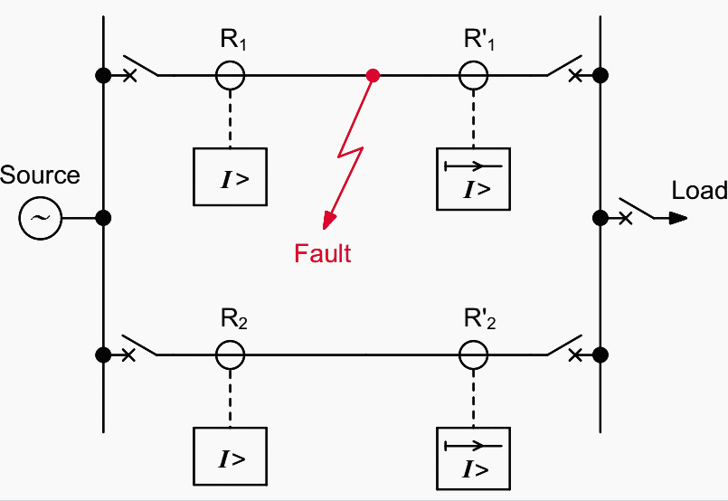

In the case of parallel transformer-feeders (figure 3), it is essential that the overcurrent relays on the low voltage side be directional, operating only for fault current fed into the transformer-feeder.
Directional relays applied to parallel feeders
Figure 3 – Directional relays applied to parallel feeders
If non-unit, non-directional relays are applied to parallel feeders having a single generating source, any faults that might occur on any one line will, regardless of the relay settings used, isolate both lines and completely disconnect the power supply.
With this type of system configuration, it is necessary to apply directional relays at the receiving end and to grade them with the non-directional relays at the sending end, to ensure correct discriminative operation of the relays during line faults.

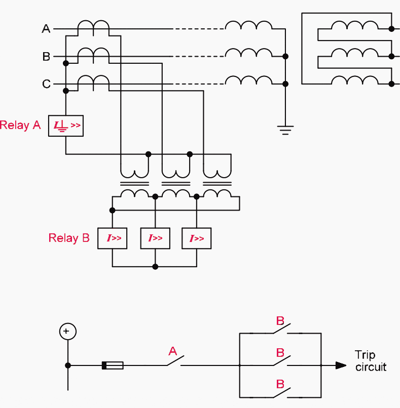

When the supply source is on the high voltage star side, an alternative scheme that does not require a voltage transformer can be used.
The scheme is shown in Figure 4. For the circuit breaker to trip, both relays A and B must operate, which will occur for earth faults on the feeder or transformer winding.
Instantaneous protection of transformer-feeder
Figure 4 – Instantaneous protection of transformer-feeder
External earth faults cause the transformer to deliver zero sequence current only, which will circulate in the closed delta connection of the secondary windings of the three auxiliary current transformers. No output is available to relay B.
Through phase faults will operate relay B, but not the residual relay A. Relay B must have a setting above the maximum load.
As the earthing of the neutral at a receiving point is likely to be solid and the earth fault current will therefore be comparable with the phase fault current, high settings are not a serious limitation.

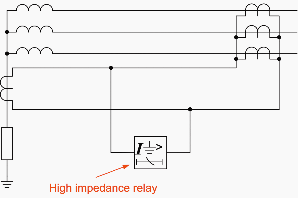

Earth fault protection of the low voltage winding will be provided by a restricted earth fault system using either three or four current transformers, according to whether the winding is delta or star-connected.
Restricted earth fault protection for a star winding
Figure 5 – Restricted earth fault protection for a star winding

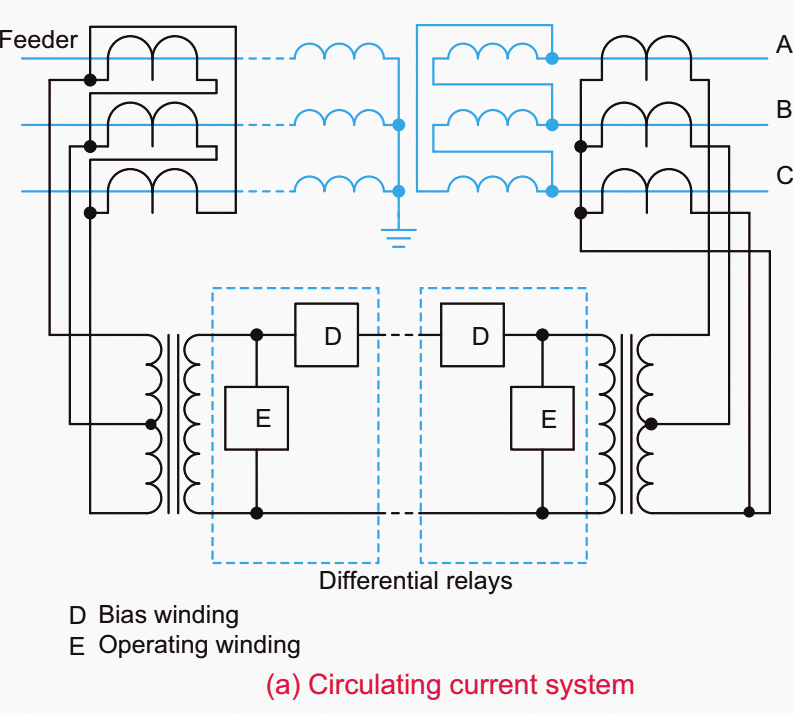

2. Unit Schemes
The basic differences between the requirements of feeder and transformer protections lie in the limitation imposed on the transfer of earth fault current by the transformer and the need for high sensitivity in the transformer protection, suggesting that the two components of a transformer-feeder should be protected separately. This involves mounting current transformers adjacent to, or on, the high voltage terminals of the transformer.
Separate current transformers are desirable for the feeder and transformer protections so that these can be arranged in two separate overlapping zones.
The use of common current transformers is possible, but may involve the use of auxiliary current transformers, or special winding and connection arrangements of the relays.
Intertripping of the remote circuit breaker from the transformer protection will be necessary, but this can be done using the communication facilities of the feeder protection relays.
Although technically superior, the use of separate protection systems is seldom justifiable when compared with an overall system or a combination of non-unit feeder protection and a unit transformer system.
An overall unit system must take into account the fact that zero sequence current on one side of a transformer may not be reproduced in any form on the other side.
Methods of protection for transformer-feeders using electromechanical static technology - Circulating current system
Figure 6a – Methods of protection for transformer-feeders using electromechanical static technology – Circulating current system
This represents little difficulty to a modern numerical relay using software phase/zero sequence compensation and digital communications to transmit full information on the phase and earth currents from one relay to the other.
However, it does represent a more difficult problem for relays using older technology.
The line current transformers can be connected to a summation transformer with unequal taps, as shown in Figure 6(a). This arrangement produces an output for phase faults and also some response for A and B phase-earth faults.
However, the resulting settings will be similar to those for phase faults and no protection will be given for C phase-earth faults.

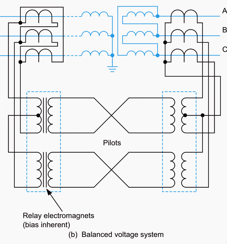

Methods of protection for transformer-feeders using electromechanical static technology - Balanced voltage system
Figure 6b – Methods of protection for transformer-feeders using electromechanical static technology – Balanced voltage system
An alternative technique is shown in Figure 6(b). The B phase is taken through a separate winding on another transformer or relay electromagnet, to provide another balancing system.
The two transformers are interconnected with their counterparts at the other end of the feeder-transformer by four pilot wires.
Operation with three pilot cores is possible but four are preferable, involving little increase in pilot cost.

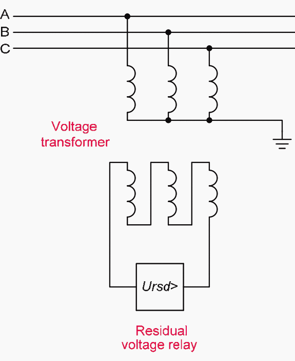

An alternative to intertripping is to detect the condition by measuring the residual voltage on the feeder.
An earth fault occurring on the feeder connected to an unearthed transformer winding should be cleared by the feeder circuit, but if there is also a source of supply on the secondary side of the transformer, the feeder may be still live.
The feeder will then be a local unearthed system, and, if the earth fault continues in an arcing condition, dangerous overvoltages may occur.
A voltage relay is energized from the broken-delta connected secondary winding of a voltage transformer on the high voltage line, and receives an input proportional to the zero sequence voltage of the line, that is, to any displacement of the neutral point.
See Figure 7.
Neutral displacement detection using voltage transformer
Figure 7 – Neutral displacement detection using voltage transformer
The relay normally receives zero voltage, but, in the presence of an earth fault, the broken-delta voltage will rise to three times the phase voltage.
Earth faults elsewhere in the system may also result in displacement of the neutral and hence discrimination is achieved using definite or inverse time characteristics.
