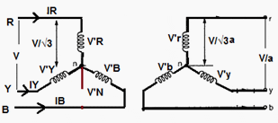

1. Star-Star (Y-y) Connection
Star-Star (Y-y) Transformer Connection
In Primary Winding Each Phase is120°electrical degrees out of phase with the other two phases.
In Secondary Winding Each Phase is120°electrical degrees out of phase with the other two phases.
Each primary winding is magnetically linked to one secondary winding through a common core leg. Sets of windings that are magnetically linked are drawn parallel to each other in the vector diagram. In the Y-Y connection, each primary and secondary winding is connected to a neutral point.
The neutral point may or may not be brought out to an external physical connection and the neutral may or may not be grounded.

Y-Y  Connection with Grounded Neutral
Figure below shows the situation where the primary neutral is returned to the voltage source in a four-wire three-phase circuit. Each of the magnetizing currents labeled IR, IY, and IB contain the 60 Hz fundamental current and all of the odd harmonic currents necessary to support sinusoidal induced voltages.
Transformer Y-Y  Connection with Grounded Neutral
The zero-sequence magnetizing currents combine to form the neutral current IN, which returns these odd harmonics to the voltage source. Assuming that the primary voltage is sinusoidal, the induced voltages VR, VY and VB (in both the primary and secondary) are sinusoidal as well.
The connection of primary neutral to the neutral of generator has an add advantage that it eliminates distortion in the secondary phase voltages. If the flux in the core has sinusoidal waveform then it will give sinusoidal waveform for the voltage. But due to characteristic of iron, a sinusoidal waveform of flux requires a third harmonic component in the exciting current. As the frequency of this component is thrice the frequency of circuit at any given constant. It will try to flow either towards or away from the neutral point in the transformer windings.
With isolated neutral, the triple frequency current cannot flow so the flux in the core will not be a sine wave and the voltages are distorted. If primary neutral is connected to generator neutral the triple frequency currents get the path to solve the difficulty. The alternative way of overcoming with this difficulty is the use of tertiary winding of low KVA rating. These windings are connected in delta and provide a circuit in which triple frequency currents can flow. Thus sinusoidal voltage on primary will give sinusoidal voltage on secondary side.
