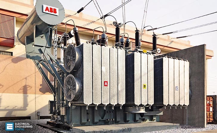

When a transformer is first energized or reenergized after a short interruption, the transformer may draw inrush current from the system due to the core magnetization being out of sync with the voltage. The inrush current may approach short-circuit levels, as much as 40 times the transformer’s full-load current.
Beware Of Transformer Inrush Current
Beware Of Transformer Inrush Current (photo credit: transformers-magazine.com)

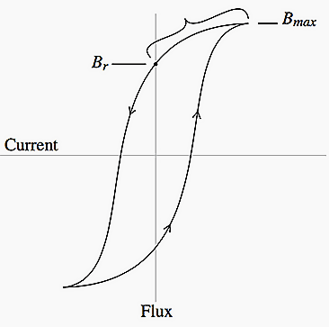

Attempted interruption anywhere here leaves Br on the core.
Hysteresis curve showing the residual flux during a circuit interruption
Figure 1 – Hysteresis curve showing the residual flux during a circuit interruption
The worst inrush occurs with residual flux left on the transformer core.

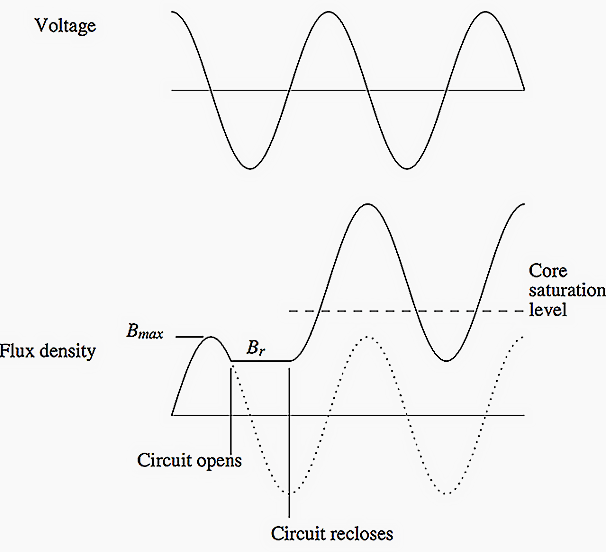

Consider Figure 1 and Figure 2, which shows the worst-case scenario. A transformer is deenergized near the peak core flux density (Bmax), when the voltage is near zero.
The flux decays to about 70% of the maximum and holds there (the residual flux, Br). Some time later, the transformer is reenergized at a point in time when the flux would have been at its negative peak. The system voltage is crossing through zero and rising positively.
Voltage and flux during worst-case inrush
Figure 2 – Voltage and flux during worst-case inrush
The positive voltage creates positive flux that adds to the residual flux already on the transformer core (remember, flux is the time integral of the voltage!).
This quickly saturates the core. The effective magnetizing branch drops to the air-core impedance of the transformer.

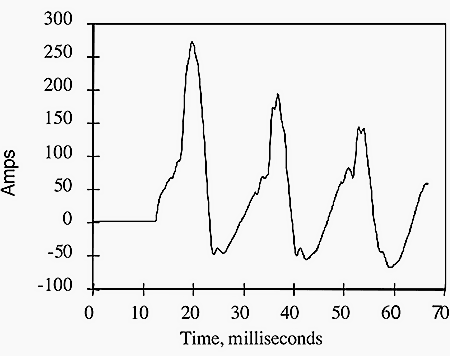

Figure 3 shows an example of inrush current following a reclose operation measured at the distribution substation breaker.
Example inrush current measured at a substation (many distribution transformers together)
Figure 3 – Example inrush current measured at a substation (many distribution transformers together)
