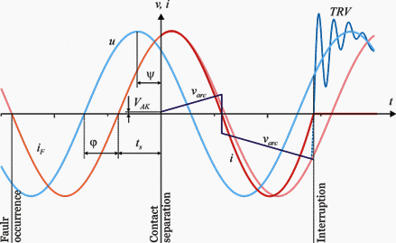

1. Short-circuit interruptions
All circuit breakers are designed to interrupt rated short-circuit currents. The number of short-circuit interruptions seen in the life of a circuit breaker depends on its location in the system, quality of the system design, environmental conditions, etc.
In countries like India, where most of the distribution is by means of overhead lines (except in the case of large urban cities where underground cable networks are used), the distribution switchgear is subjected to a large number of short-circuit interruptions.
This is due to bird hits, snapping of lines, thunderstorms, etc.
Vacuum switchgear, which can interrupt rated short-circuit current up to 25 kA 100 times without requiring maintenance, is the obvious choice for this application as compared to other circuit breakers which can do so for only 15-20 operations.
The other important criterion to be considered in distribution through overhead lines is the auto-reclosing feature required due to the transient nature of the faults.
The VCBs are ideally suited for auto-reclosing duties because they act fast and can be reclosed with a minimum time interval between two closings as cooling of the dielectric is not involved.

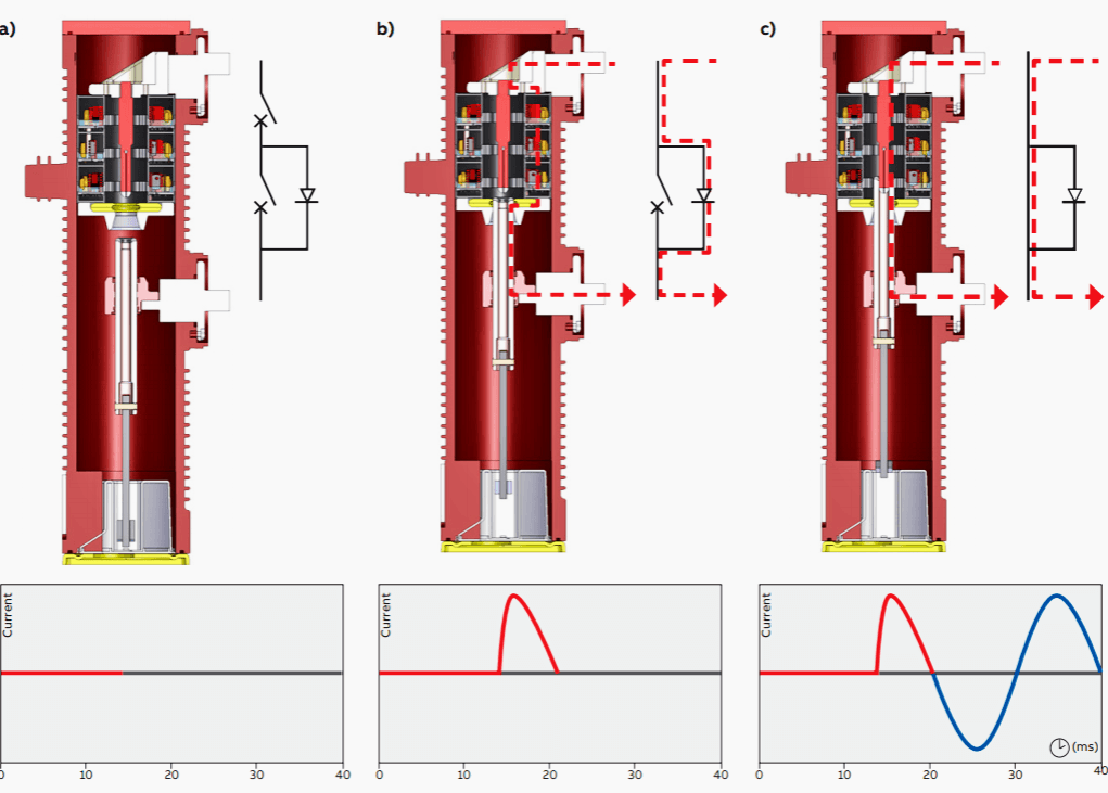

Synchronous switching devices
These apparatuses are classified by Standard IEC 62271-103 High-voltage switchgear and controlgear – Part 103: Switches for rated voltages above 1 kV up to and including 52 kV, as “special purpose switches” for switching class C2 capacitor banks.
Tests for switching capacitive currents have been conducted in accordance with Standard IEC 62271-100, since the test conditions defined by this Standard are more demanding than IEC 62271-103. These tests are comparable to those required by Standard IEEE C37.09a.
Even though modern circuit breakers are designed to minimize the possibility of multiple electric arc restrikes, the statistical probability of occasional restrikes in the case of frequent switchings of capacitive loads exists.
Use of traditional methods for limiting the effects of transients generated in this way (such as filters or surge arresters) is unable to completely resolve the problem and in any case, does not deal with its root cause. This risk can be eliminated by adopting controlled switching techniques, such as synchronized closing or opening.
In practice, the closing and opening operations of the switching apparatus are synchronized so that the contacts make or break in the optimal instant, in relation to the phase angle.
Complete closing of a MV circuit breaker
Figure 1 – Complete closing of a MV circuit breaker
In these cases, many manufacturers has a special switching device and for example ABB has a capacitor switch type ‘DS1’. With reference to figure 1, before the capacitor bank is energized, the apparatus is in situation a), with the switch open and the bank isolated from the grid.
After this, as shown in b), the moving contact connects the diodes and the bank is naturally supplied at voltage zero.
Lastly, as shown in c), after a quarter of a cycle, the moving contact closes the switch and allows current to flow without losses.

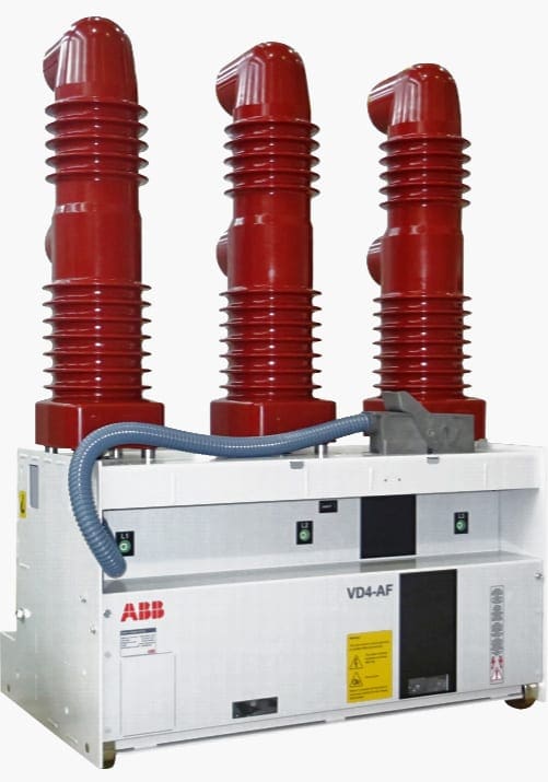

4.1 Arc Furnace Applications
Electric arc furnaces with ratings up to 100 MVA generally employ special circuit breakers, for which purpose air blast circuit breakers have been used till now.
In this application, the falling scrap in the furnace causes short-circuits between the electrodes during the melting process, and the currents to be switched lie between zero and 1-8 times the rated current of the furnace transformer. The frequency of switching can be as high as 100 operations per day with rated currents up to 2000 A.
Normal oil, air and SF6 circuit breakers are found to be unsuitable for this application. Special air circuit breakers are very expensive due to stringent requirements for relatively small quantities.
The standard vacuum circuit breaker offers an economical and reliable solution for this application.
Circuit breaker forsteel furnace operation type ABB VD4-AF
Figure 3 – Circuit breaker forsteel furnace operation type ABB VD4-AF

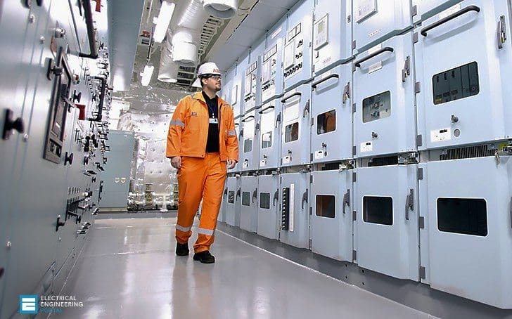

4.3 Use on Ships
Circuit breakers meant for use on ships have to fulfill the following special requirements:
  1. They must remain operational even in an inclined position; and
  2. Circuit breakers used on ships are subjected to vibrations in actual use.
Circuit breaker manufacturers are able to comply with these requirements more easily in the case of vacuum circuit breakers.
