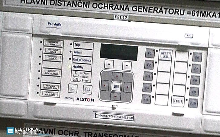

This technical article will cover the gathering of information needed to calculate protective relay settings, the setting calculations for the various protective functions, typical generator/turbine withstand times for abnormal operating conditions, and the math associated with various types of impedance elements.

A good starting point is to compile the data needed for setting the various generator protective functions.
Figures 1, 2, and 3 provide examples of organizing and massaging or converting the information to a more useful form for generators, step-up transformers, and their associated electrical systems. The information is for a 578.6 megavolt-amp (MVA), 24 kilovolt (kV) generator that is connected to the 765 kV bulk power transmission system.
Organizing the data in this manner will save significant time in developing and documenting the basis for the relay settings.
