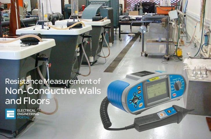

Resistance Measurement of Non-Conductive Walls and Floors
Resistance Measurement of Non-Conductive Walls and Floors (photo credit: geckospecialcoatings.com.au)
