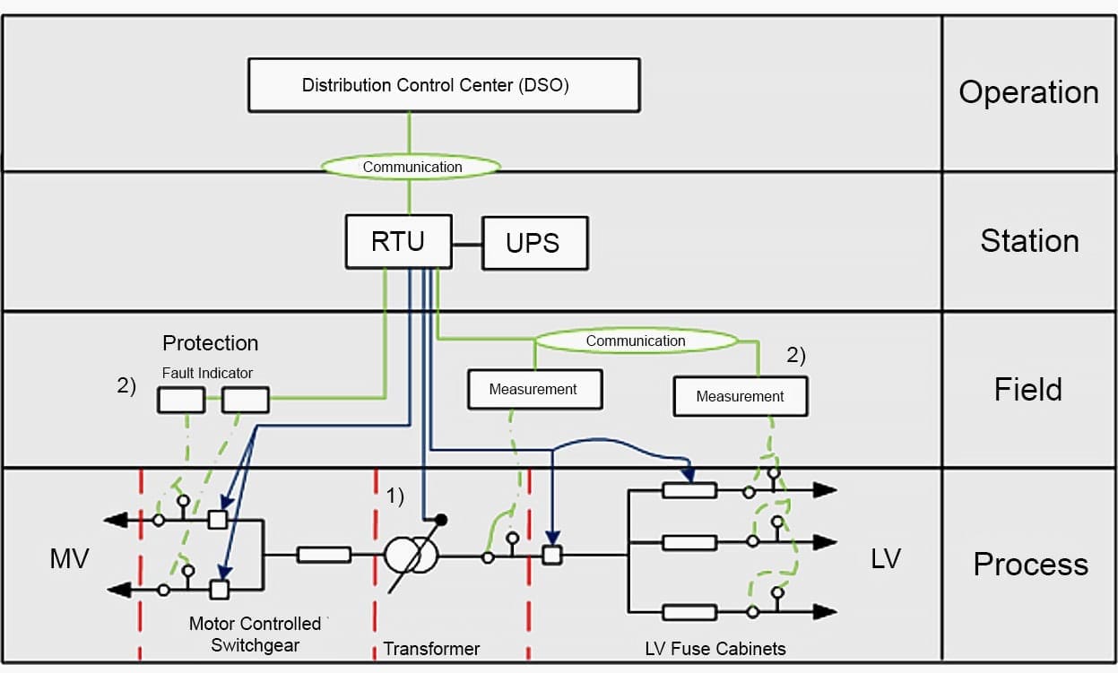

Elements of the intelligent secondary substation
Figure 3 – Elements of the intelligent secondary substation

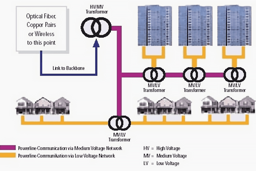

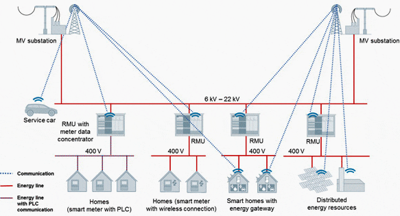

2.3 PLC/BPL
PowerLine Carrier (PLC) or Broadband over PowerLine (BPL) uses the energy grid for communication.
Usually, the data from the secondary substation are communicated over the MV network to a primary substation from where they are communicated through a different technology.
Powerline communication in MV network
Figure 4 – Powerline communication in MV network

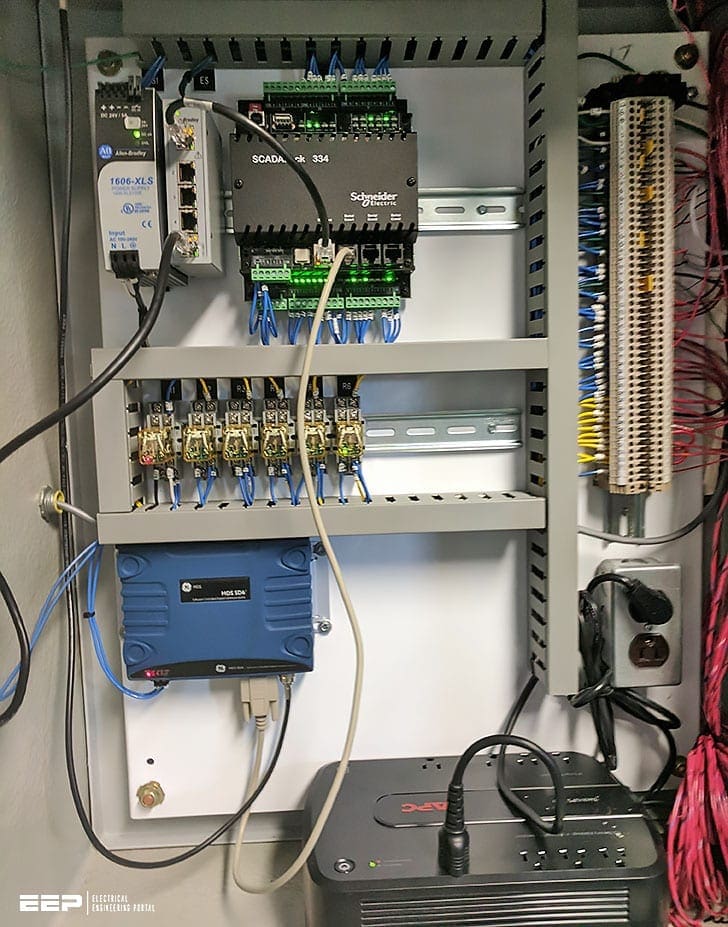

3. RTU
The expectations and tasks to be performed by RTU have increased over the years as result of Smart Grid requirements. Traditionally, it secures collection of analog and digital inputs, provision of commands and, on top of that, communication through standard protocol to the SCADA system.
Besides these traditional tasks, it may also perform other important tasks, e.g., communication with IEDs (Intelligent Electronic Device), integration of automation functionalities or just communication gateway securing data processing of independent metering and control units.

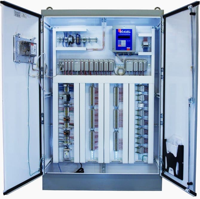

The usual RTU has modular architecture with several cards securing specific functionalities in order to be scalable.
In general, we can see modular or integrated RTUs depending on customers’ requirements in terms of functionalities and needs and also with in-build or external communication.
SCADA RTU panel
Figure 6 – SCADA RTU panel (photo credit: oempanels.com)

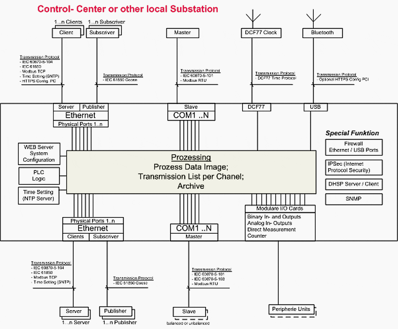

Network topology and block diagram of a RTU
Figure 7 – Network topology and block diagram of a RTU

3.2 Flexible I/O card and communication interface

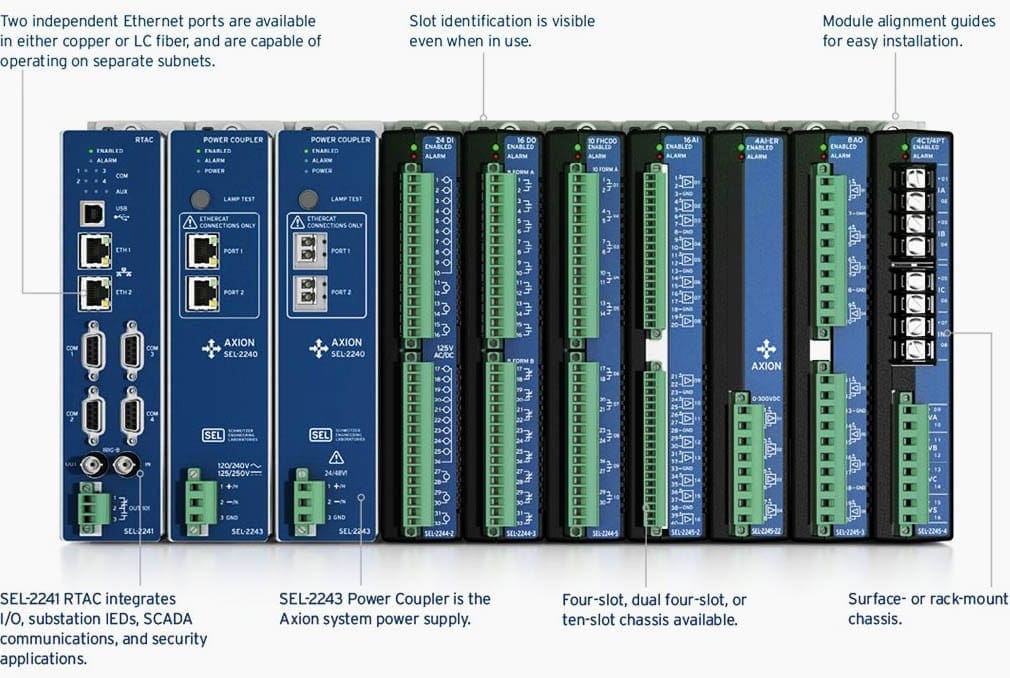

In order to meet the needs of today’s energy supplier, a Remote Terminal Unit is required with a modular system platform. This system platform should have an open scalable architecture that is easy to adapt to future requirements without any hardware upgrade.
The RTU should have at least the following physically separate communication interfaces:
  • 2 Ethernet Ports RJ45 (Full or half Duplex Communication Ports)
  • 2 COM Ports RS232 and / or RS485 (RS422)
In addition to the described communication interfaces, the RTU has more interfaces for the direct detection of signals like single and double points, counter and transformer tap position, measured values or the outputs of commands and set points.
This also includes modules for the direct measurement of current and voltage in the medium and low voltage.
The SEL-2240 Axion is a fully integrated, modular input/output (I/O) and control solution ideally suited for utility and industrial applications.
FIgure 8 – The SEL-2240 Axion is a fully integrated, modular input/output (I/O) and control solution ideally suited for utility and industrial applications.

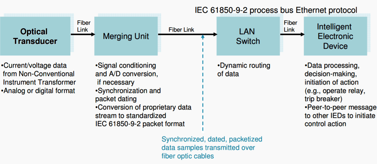

3.4 Internal communication
The state of the art of the infrastructure into the substation is a communication per Fieldbus RS485 via Modbus or IEC 60870-5-103.
In the future, we might see the internal communication LAN inside the secondary substation via Ethernet (TCP IP, UDP protocols IEC61850). A  communication switch is then needed to enable LAN inside secondary substation.
Another possibility might be external router used not only for RTU communication, but also for other devices.
3.5 External communication
The state of the art of the infrastructure from substations to superior systems is a communication per Ethernet or RS232 interfaces using IEC 60870-5-101, IEC 60870-5-104.
In the future, we might see the communication with IEC 61850 more often using it as a communication to control centre and between the secondary substations as a very quick way to share grid status.
3.6 Serial (RS-232, RS-485), Modbus, IEC 101-103
The requirements of the serial communication ports are presented in Table 2.
Table 2 – Requirements of the serial communication ports
Protocol Port Baud-Rate Function
IEC60870-5-101 RS232 50… 38k4 Bit/s unbalanced / balanced
IEC60870-5-103 RS485 9k6 or 19k2 Bit/s unbalanced
Modbus RTU RS485 50… 38k2 Bit/s unbalanced
3.7 Ethernet (network equipment), IEC 104, IEC 61850
The requirements of the Ethernet communication ports are presented in Table 3 below.
Table 3 – Requirements of the Ethernet communication ports
Protocol Function Port Virtual Connection
IEC60870-5-104 Client
Server
RJ45 or Fiber full or half Duplex Communication with 10/100 Mbyte/s 1…N
1
Modbus TCP Client
Server
RJ45 full or half Duplex Communication with 10/100 Mbyte/s 1…N
1
Time Setting SNTP Client
Server
RJ45 or Fiber full or half Duplex Communication with 10/100 Mbyte/s 1…4
1
HTTPS Client USB or RJ45 for Service and Engineering from Local or Remote 1…N

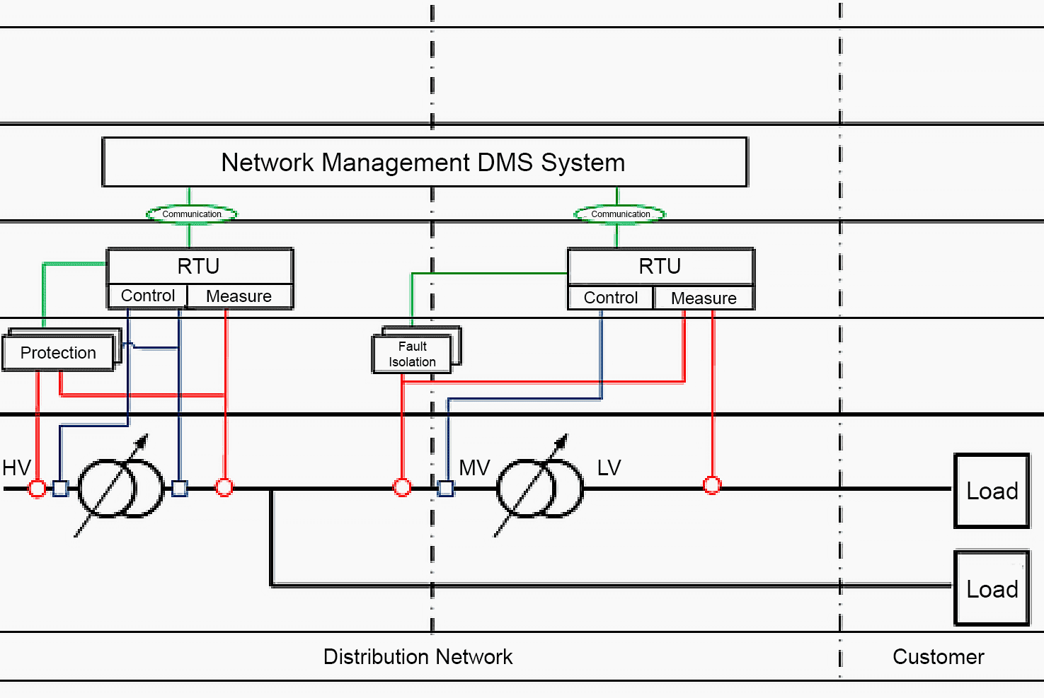

4. Measuring, Monitoring and Control

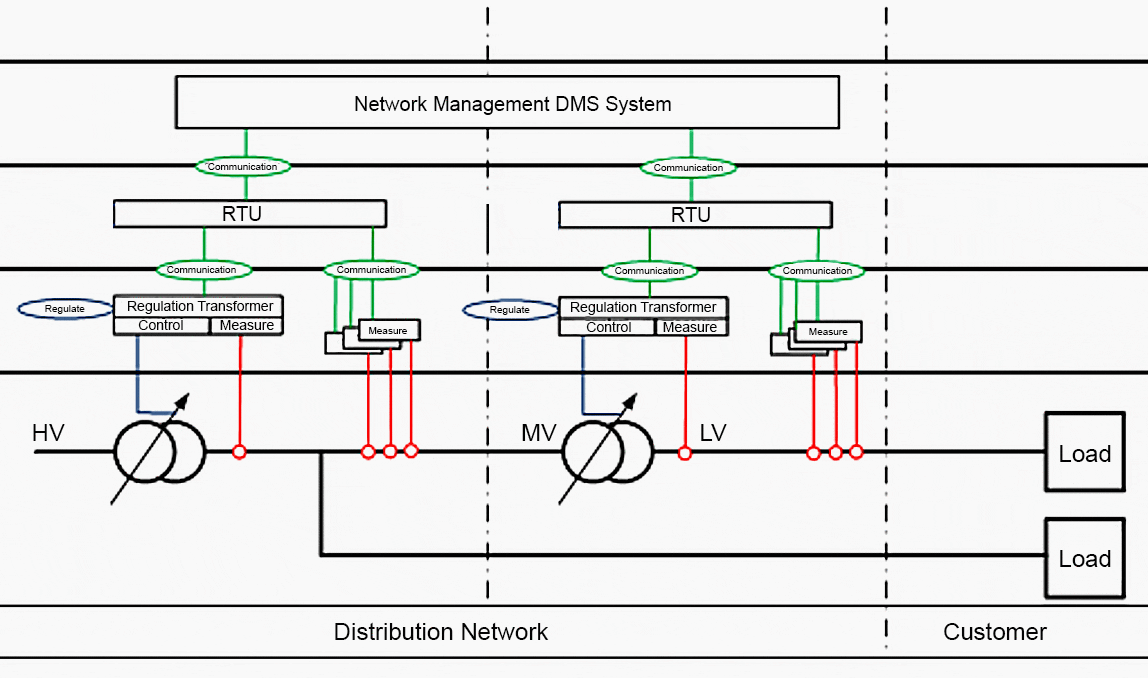

The essential function of the RTU is used for the monitoring the Distribution Grid –  Grid monitoring: Short-circuit and earth fault detection and monitoring of switch status and device condition (e.g., loss of SF6 pressure).
Voltage regulation and flow control in the distribution network
Figure 9 – Voltage regulation and flow control in the distribution network

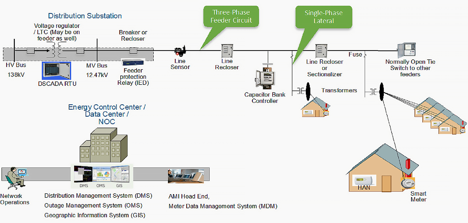

4.1 PLC (logic function)
RTU is the first level of the transformation of a substation into a smart secondary substation. For higher-level automation, signals can be processed inside, using a Programmable Logic Function, which is typically named after former additional processor needs PLC (programmable logical controller).
Algorithms written with the PLC function can be part of automated switching solution or Volt/VAR control applications and make operation therefore independent of superior systems.
Connection and disconnection of network equipment by remote control
Figure 10 – Connection and disconnection of network equipment by remote control
Automated switching for Fault Isolation and Service Restoration:
  1. Derive necessary action to isolate faulty section
  2. Execute close command on normal open point to restore power
  3. Reconfigure to normal after fault clearance
Voltage stability:
  1. Voltage regulator in the distribution substation or in-phase regulator in the field
  2. Active and reactive power control for decentralized generating plants and loads
  3. Wide-area control for transformer and in-phase regulator
Load and Flow Control:
  1. Load flow control based on the overall grid state

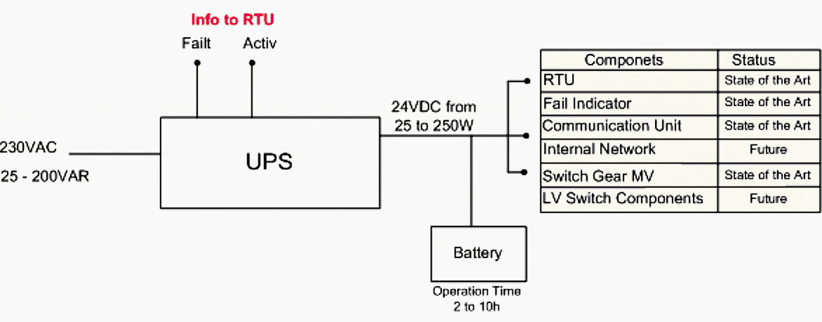

5. UPS
All mentioned active devices in this article work on Direct Current (DC) typically 24V, but other voltages are also possible.
In order to keep the communication with the substation and protection in the substation active during outages, there is a need for an uninterruptable power supply (UPS) that keeps the devices active during a period of several hours.
UPS supplying substation devices
Figure 11 – UPS supplying substation devices

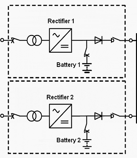

5.1 AC/DC converter
The main task of AC/DC converters is to secure sufficient and reliable power supply to RTUs and other devices installed in secondary substations.
The power supply concept might be based either on separate modules (usually installed together with modular RTU) or with integrated ones (compact RTU).
The power output should reflect expected consumptions of all devices; in certain applications, the redundant configuration might be needed.
DC UPS in parallel redundant configuration
FIgure 12 – DC UPS in parallel redundant configuration
Below mentioned list represents the usual set of functionalities to be considered by the project designer:
  1. Requested current and voltage output
  2. Possible UPS integration (extra connection)
  3. Power supply and battery management
  4. Communication capabilities (protocol and interface)
  5. Protection (overvoltage, overcurrent)
  6. Operation conditions (temperature, humidity, …)
  7. Temperature management – heating/cooling

SCADA/RTU panel with Schneider Electric ScadaPack RTU, modem, APC UPS; source: Tri-Star Inc.
Figure 13 – SCADA/RTU panel with Schneider Electric ScadaPack RTU, modem, APC UPS; source: Tri-Star Inc.
