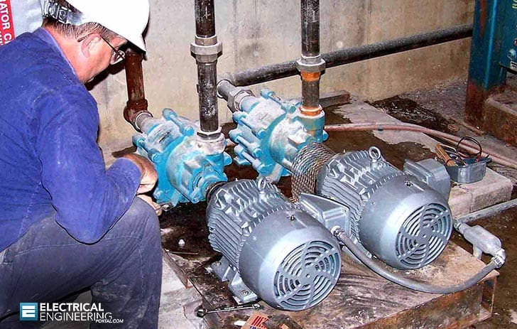

Motors need maintenance regularly in order to avoid failure and prolong their lifespan. Generally speaking, motors and motor parts should be maintained and tested at least every 6 months. Only then is it possible to maintain a motor’s life and its efficiency.
Factors which affect the life span of the motor due to lack of maintenance
1. Preventive motor maintenance
The objective of this kind of maintenance is to prevent operating problems and make sure that the motor continuously provides a reliable operation Usually, preventive maintenance is a scheduled part of maintaining a whole system.

Motor ventilation
If the motor is installed and operates in an area with limited ventilation, the motor temperature may reach high temperatures that can damage the motor’s insulation and bearing grease, and cause it to fail Dust and dirt often block the ventilating passages.
Therefore, in order to prevent the motor from overheating, it is important to blow away the dirt on a regular basis.
Even though motors are protected, it is important to install them in areas with constant ventilation so that high temperatures do not damage insulation and bearings. The cooler a motor operates, the longer lifetime it has. Therefore, the fan cover and the cooling fin always have to be as clean as possible.
