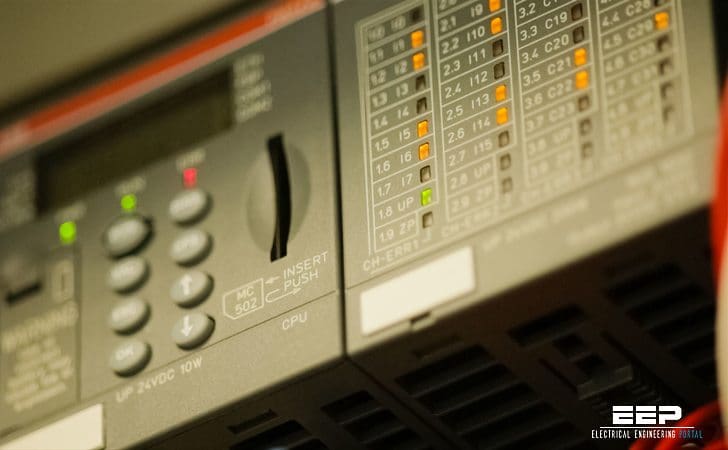

Purpose and Applicable Processes of a SCADA System
Purpose and Applicable Processes of a SCADA System (photo credit: watex.eu)
Control systems like programmable logic controllers (PLC) or distributed control systems (DCS) will do a better job for most factory control and monitoring.
