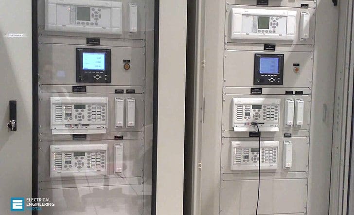

For medium voltage circuit breaker applications, protective relay serve as the “brain” that detects abnormal system conditions and direct the circuit breaker to operate. They also serve to provide specialized protection in low voltage power circuit breaker applications for functions not available in the circuit breaker trip units.
Protective Relay - The Brain That Detects Abnormal System Conditions
Protective Relay - The Brain That Detects Abnormal System Conditions (photo credit: congede.net)
Most modern protective relays are solid-state electronic or microprocessor-based devices, although older electromechanical devices are still available and still work!
Microprocessor-based or solid-state electronic relays offer more flexibility and functionality than electromechanical relays, including the ability to interface with common communications protocols such as MODBUS for integration into a SCADA environment.
