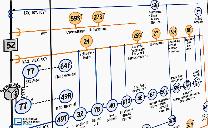

It is difficult to define precisely the protection schemes that should be adopted for an electricity distribution system, given the large number of valid alternatives for each situation, but some schemes will be presented as a guide for protecting the various elements that make up a power system.
Protection Schemes For Generators and Motors
Protection Schemes For Generators and Motors (scheme credit: SEL)
However, any protection scheme should strike a balance between the technical and economic aspects so that, for example, sophisticated protection devices are not used for small machines or for less important power system elements.

For large generators, say over 5 MVA, the protection, which is shown in Figure 2, should normally comprise:
  • Differential protection to cover internal faults;
  • Earth-fault protection using high impedance relays;
  • Back-up protection by means of distance or overcurrent protection with voltage restraint;
  • Reverse-power protection;
  • Negative-phase sequence protection;
  • Protection against loss of excitation;
  • Protection against overload using thermal relays.

Figure 2 – Protection schematic for generators over 5 MVA
Go back to protection schemes ↑
