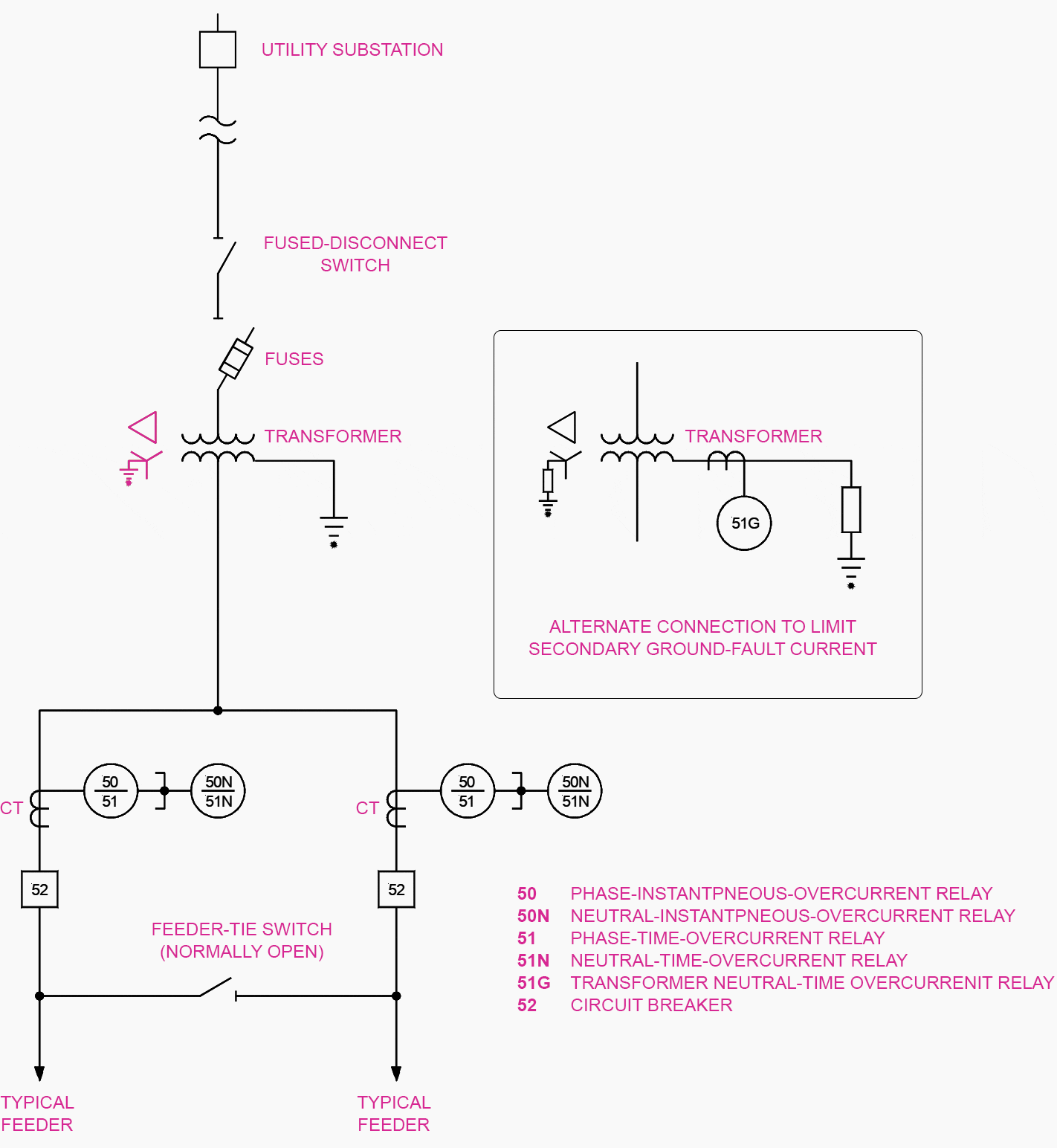

Single-transformer, single-bus configuration
The utility supply voltage depends on both availability and consumer requirements. The consumer transformer is connected delta on the high-voltage side and grounded wye on the low-voltage side.
Protection scheme for the substation with a single supply from the utility
A fused-disconnect switch provides three-phase switching and protection for the transformer, as well as physical isolation of the transformer during maintenance. The consumer voltage may range from 480 V to 34.5 kV. As stated above, power transformer is connected delta/wye and system configuration is single-transformer / single-bus.
A normally open feeder tie switch is shown to facilitate circuit breaker maintenance.
Single supply from a remote utility substation (single-transformer / single-bus configuration)

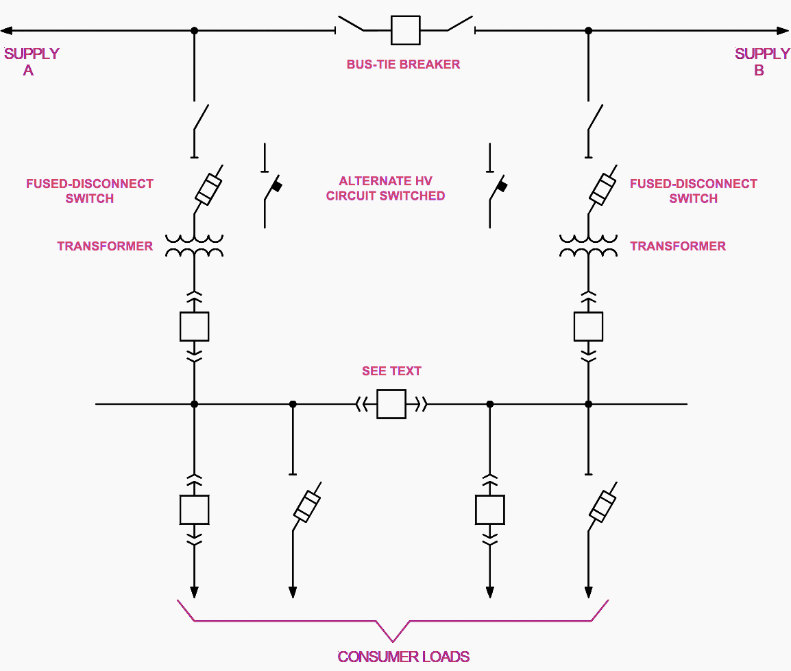

If two transformers are involved, as in Figure 2, the fuse size and relay setting or fuse coordination should be selected based on the normal maximum loading level of both transformers.
Coordination with the low-side breaker may be sacrificed under emergency loading conditions with one transformer out of service.
Dual supply-dual transformer (single-supply circuit breakers)
Figure 2 – Dual supply-dual transformer (single-supply circuit breakers)

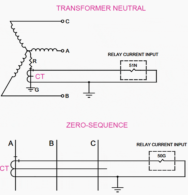

FACTOR #5 – Primary fusing as the only means of transformer protection may not be suitable if the secondary ground fault current is limited by using resistance grounding on the neutral.
This is because the primary current resulting from a phase-to-ground secondary fault may not be sufficient to melt the fuse.
If low-resistance grounding is used, several relay schemes can be employed to clear a ground fault between the transformer and feeder breakers, or beyond the feeder breakers if one fails to open.
All of these schemes use a neutral CT and overcurrent relay (51G).
Transformer neutral and zero-sequence ground relaying applications for resistance-grounded systems
Figure 4 – Transformer neutral and zero-sequence ground relaying applications for
For a low-resistance-grounded system, the use of an overcurrent relay connected to a CT in the service transformer neutral is usually the best option. This CT should have a ratio smaller than the phase CT’s, and the relay pickup range in conjunction with the neutral CT should allow a pickup as low as 10% of the neutral resistor rating.
For a feeder circuit downstream from the service transformer, a zero-sequence CT is recommended, again with a ratio small enough to allow a pickup as low as 10% of the neutral resistor rating.
When an overcurrent relay is utilized with a zero-sequence CT it is referred to as a 50G, 51G or 50/51G relay depending upon relay type used. Figure 4 shows typical arrangements for both these applications.
This neutral overcurrent relay (51G) trip output can be connected to do one of the following:
  1. Close a high-side grounding switch to force tripping of the remote utility breaker
  2. Open a high-side motor-operated switch that is rated to interrupt such faults
  3. Transfer trip the remote utility breaker

The fuse provides protection for transformer high-side and low-side faults. It also provides limited backup protection for low-side feeder faults.

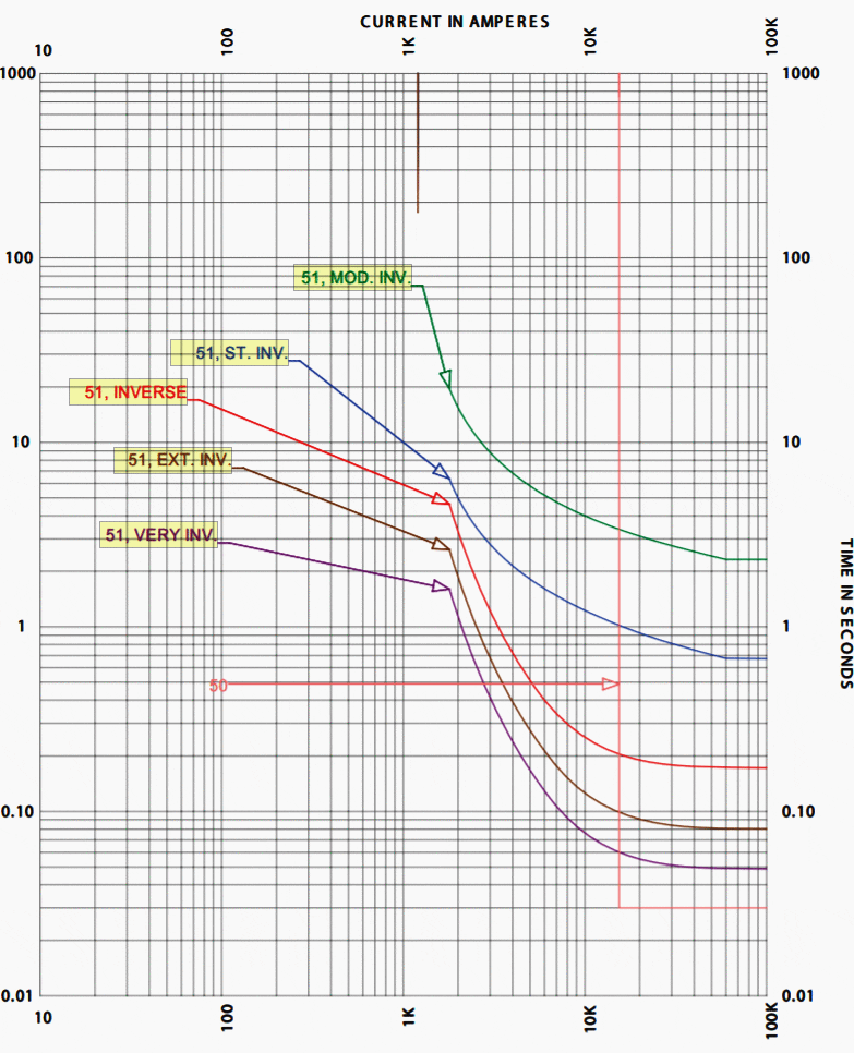

Feeder phase protection is provided by non-directional instantaneous and time-overcurrent relays. The purpose of the instantaneous relays is to provide high-speed detection of close-in faults.
On short feeders, where the magnitude of fault current does not decrease significantly from the bus to the end of the feeder, coordination of the instantaneous relays with downstream protective devices may be difficult, if not impossible. The time-overcurrent relays should coordinate with the largest protective device on the feeder.
The time current characteristics of the relays should be selected accordingly.
For coordination with branch fuses, a very inverse or extremely inverse-time characteristic should be selected. Phase relay pickup should be greater than the expected full load current on the feeder.
It is also important to check coordination of the time-overcurrent relay with the transformer high-side fuse. Coordination should be reviewed when the load-side tie switch is closed. The phase relay pickup should be high enough to carry the load of both feeders and still provide adequate fault protection while maintaining coordination with the high-side fuse.
ANSI 50 and 51 overcurrent relay characteristics
Figure 3 – ANSI 50 and 51 overcurrent relay characteristics
