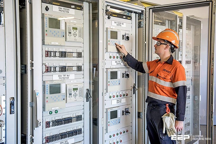

Home / Technical Articles / Protection scheme for remote private substation with small generator
System description
Connections of private substations to utilities are made more complicated with the addition of private-owned generation facilities. The choice of relays and their placement must be made to ensure adequate protection of both the generator and the interface.
Protection scheme for remote private substation with small generator (photo credit: Stuart Watts via Linkedin)
The protection of small generators will be accomplished by a minimal investment in relay protection. Large generators require a full complement of generator relays (see IEEE Std C37.102TM).
In addition, the location of larger generators on the utility system may not be optimized for large power flows or bidirectional flow and may require changes to the utility transmission system.
Figure 1 is an example of a small generator connected to a private substation in a simple configuration. The example shows the generator connected to a low-side bus in parallel with a consumer load, which is typical of a small unit.
