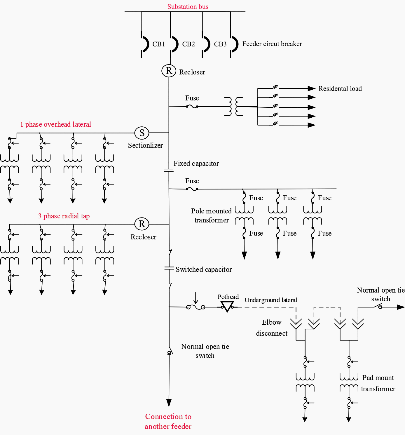

Primary distribution systems
Primary distribution systems consist of feeders that deliver power from distribution substations to distribution transformers. A feeder usually begins with a feeder breaker at the distribution substation. Many feeders leave substation in a concrete ducts and are routed to a nearby pole.
Primary and secondary power distribution systems (layouts explained)
At this point, underground cable transitions to an overhead three-phase main trunk. The main trunk is routed around the feeder service territory and may be connected to other feeders through normally-open tie points. Underground main trunks are possible-even common in urban areas, but cost much more than overhead construction.
Lateral taps off of the main trunk are used to cover most of a feeder’s service territory. These taps are typically single phase, but may also be two phases or three phases.
Laterals can be directly connected to main trunks, but are more commonly protected by protective devices such as fuses, re-closers, or automatic sectionalizers.
Overhead laterals use pole-mounted distribution transformers to serve customers and underground laterals use pad mount transformers. Feeder routes must pass near every customer. To accomplish this, each substation uses multiple feeders to cover an allocated service territory.
An illustrative feeder showing different types of laterals and devices is shown in Figure 1.
A primary distribution feeder showing major components and characteristics
Figure 1 – A primary distribution feeder showing major components and characteristics

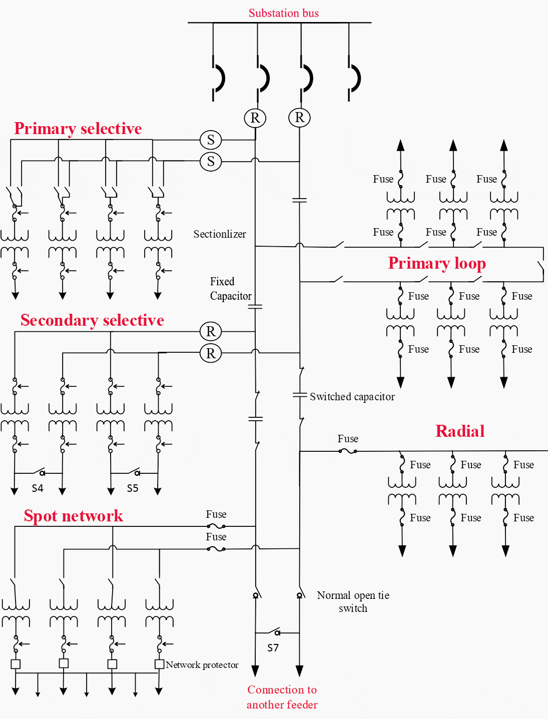

The simplest primary distribution system consists of independent feeders with each customer connected to a single feeder. Since there are no feeder interconnections, a fault will interrupt all downstream customers until it is repaired.
This configuration is called a radial system and is common for low-density rural areas where more complex systems are cost prohibitive.
A slightly more common configuration connects two feeders together at their endpoints with a normally open tie switch. This primary loop increases reliability by allowing customers downstream of a fault to receive power by opening an upstream switch and closing the tie switch. The only customers that cannot be restored are those in switchable section where the fault occurred.
Many distribution systems have multiple tie switches between multiple feeders. Reliability benefits are similar to a primary loop with greater switching flexibility.
These highly interconnected primary distribution systems are referred to as radially operated networks.
Certain classes of customers require higher reliability than a single feeder can provide.
Primary selective service connects each customer to a preferred feeder and an alternate feeder. If the preferred feeder becomes de-energized, a transfer switch disconnects the preferred feeder and connects the alternate feeder.
Secondary selective service achieves similar results by using switches on secondary voltages rather than primary voltages. With secondary selective service, each distribution transformer must be able to supply the entire load for maximum reliability benefits.
Spot Networks are used for customers with the highest reliability requirements. This configuration connects two or more transformers (fed from at least two feeders) in parallel to energize the secondary bus. To prevent reverse power flow through the transformers, special network protectors with sensitive reverse power relays are used. Spot networks allow multiple component failures to occur without any noticeable impact on customers.
They are common in central business districts and high-density areas and are being applied frequently in outlying areas for large commercial services where multiple supply feeders can be made available.
Some typical primary distribution system configurations are shown in Figure 2.
Typical primary distribution system
Figure 1 – Typical primary distribution system

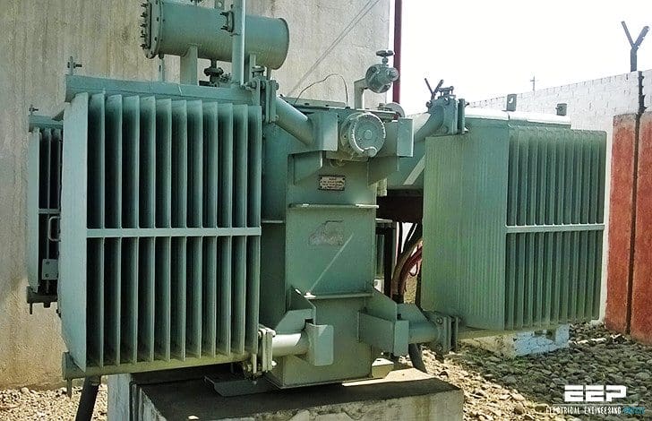

Distribution transformers or secondary transformers, placed along feeders, convert the voltage from the medium to a low voltage level, suitable for direct consumption by end customers (mains voltage).
Distribution transformer (photo credit: skselectricals.in)
Typically, a rural primary feeder supplies up to 50 distribution transformers, spread over a wide region but the figure significantly varies depending on configuration. They are sited on pole tops, cellars or designated small plots.

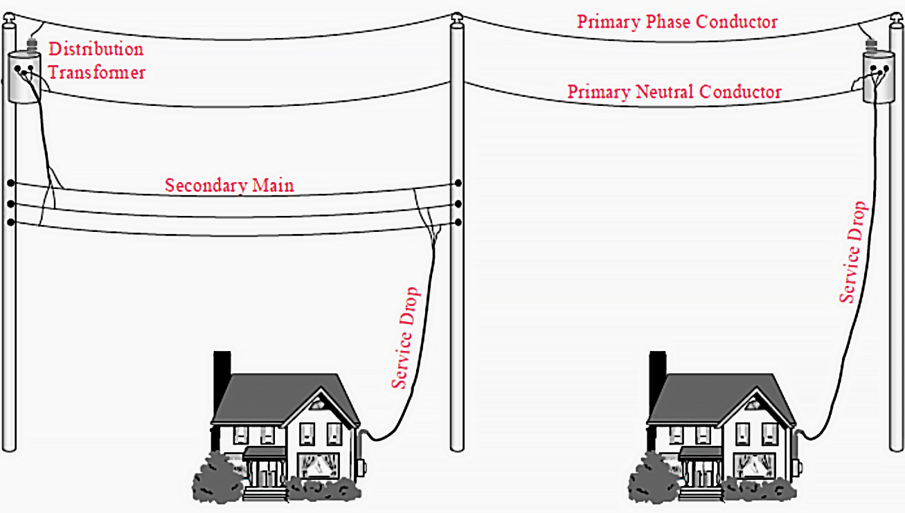

From these transformers, low voltage or secondary network branches off to the customer connections at customer premises, equipped with electricity meters.
Service drop to primary (right) service drops to secondary mains (left)
Figure 3 – Service drop to primary (right) service drops to secondary mains (left)
Customers are connected to distribution systems via service drops. Customers close to a distribution transformer are able to have service drops directly connected to transformer secondary connections. Other customers are reached by routing a secondary main for service drop connections.
These two types of service connections are shown in Figure 3 above.
Systems utilizing secondary mains are characterized by a small number of large distribution transformers rather than a large number of small distribution transformers
This can be cost effective for areas with low load density and/or large lot size, but increases ohmic losses and results in higher voltage drops. Increased line exposure tends to reduce reliability while fewer transformers tend to increase reliability.
Many underground systems connect service drops directly to distribution transformers and do not use secondary mains. This forces distribution transformers to be located within several hundred feet of each customer, but eliminates the reliability concerns associated with T-splices that are required to connect underground service drops to underground secondary mains.

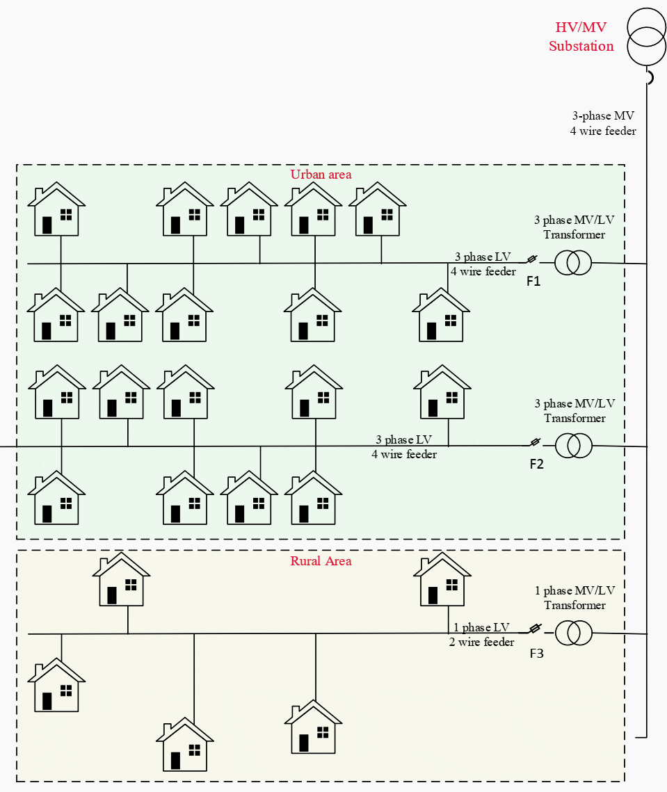

Radial networks
Radial operation is the most widespread and most economic design of both MV and LV networks. It provides a sufficiently high degree of reliability and service continuity for most customers.
In American (120 V) systems, the customers are commonly supplied directly from the distribution transformers via relatively short service drop lines, in star-like topology.
In 240 V systems, the customers are served by several low-voltage feeders, realized by overhead power lines, aerial or underground power cables, or their mixture.
Typical layout of radial low-voltage network
Figure 4 – Typical layout of radial low-voltage network
In an overhead network, service drops are drawn from pole tops to roof connections. In a cable network, all necessary connections and protection devices are typically placed in pad-mounted cabinets or, occasionally, manholes (buried T-joint connections are prone to failures).
Power-system protection in radial networks is simple to design and implement, since short-circuit currents have only one possible path that needs to be interrupted.
Fuses are most commonly used for both short-circuit and overload protection, while low-voltage circuit breakers may be used in special circumstances.

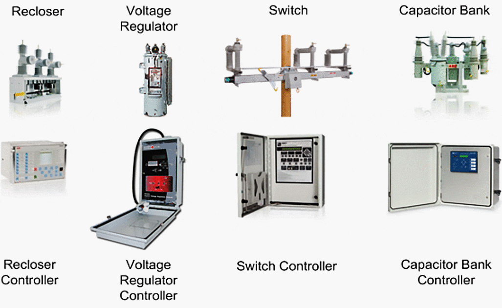

Major distribution equipment

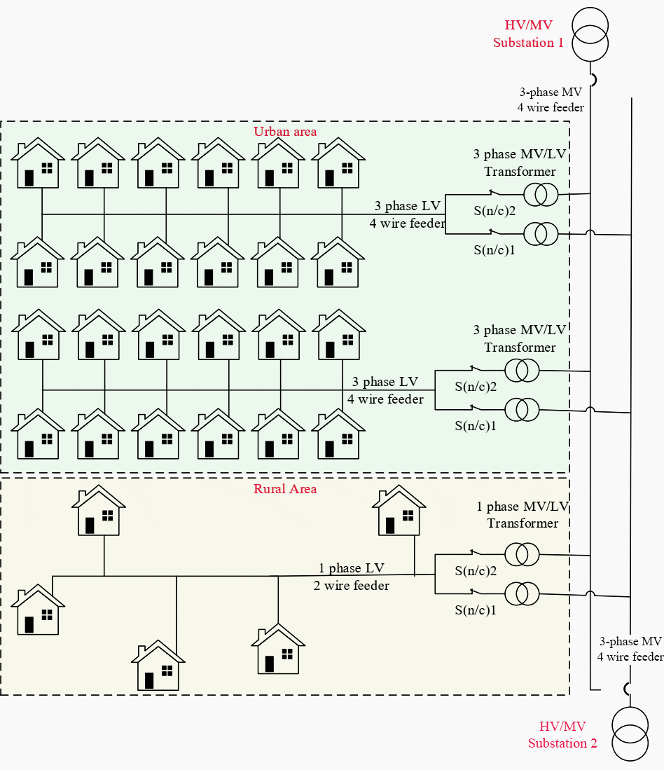

Spot networks
Spot networks are used when increased reliability of supply is required for important customers. The low-voltage network is supplied from two or more distribution transformers at a single site, each fed from a different MV feeder (which may originate from the same or different substations).
The transformers are connected together with a bus or a cable on secondary side, termed paralleling bus or collector bus. The paralleling bus typically does not have connecting cables (reaches) to other network units, in which case such networks are termed isolating spot networks. When they have, they are referred to as spot networks with reach.
In some cases, fast-acting secondary bus tie breakers may be applied between bus sections to isolate faults in the secondary switchgear and limit loss of service.
Spot systems are commonly applied in high load-density areas such as business districts, large hospitals, small industry and important facilities such as water supply systems.
In normal operation, the energy supply is provided by both primary feeders in parallel. In case of an outage of either primary feeder, network protector device at the corresponding spot transformer secondary automatically opens. The remaining transformers continue to provide supply through their respective primary feeders.
Typical layout of a spot low-voltage network
Figure 5 – Typical layout of a spot low-voltage network
Only in cases when the short circuit is located at the paralleling bus, or a total loss of primary supply occurs, the customer will remain out of service. Faults on the low-voltage network are handled by fuses or local circuit breakers, resulting in loss of service only for the affected loads.

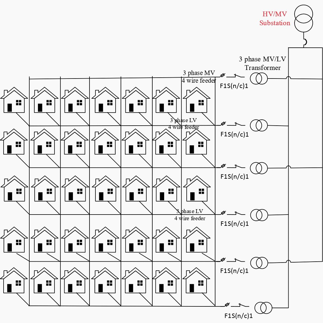

Grid networks
A grid networks consist of an interconnected grid of circuits, energized from several primary feeders through distribution transformers at multiple locations. Grid networks are typically featured in downtowns of large cities, with connecting cables laid out in underground conduits along the streets.
Numerous cables allow for multiple current paths from every transformer to every load within the grid.
As with spot networks, network protectors are used to protect against primary feeder faults, and prevent fault current to propagate from the grid to the primary feeder.
Individual cable sections may be protected by cable limiters on both ends, special fuses providing very fast short-circuit protection.
The inherent system redundancy generally prevents any customer from experiencing outage.
Layout of a grid low-voltage network
Figure 6 – Layout of a grid low-voltage network
