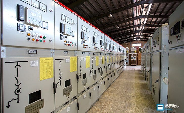

Primary medium voltage switchgear represents an important part within the primary distribution substation functionality. The switchgear works as a connection node between the outgoing distribution feeders and the in-feeding power transformers. The most common construction with the switchgear is an indoor-mounted metal-enclosed one.
Basics Of Primary Medium Voltage Switchgear
Basics Of Primary Medium Voltage Switchgear (on photo: ABB's MV air-insulated metal-clad switchgear, type 'UNISAFE'; credit: tamintablo.com)

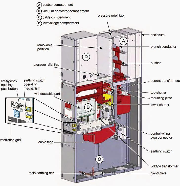

Example of primary medium-voltage switchgear - UniGear ZVC feeder unit
Figure 1 – Example of primary medium voltage switchgear – UniGear ZVC feeder unit

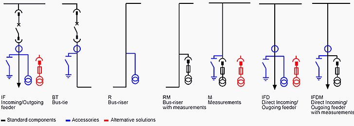

Switchgear consists of a number of cubicles. The basic construction of each cubicle is chosen to meet the intended use. This means that for example the power transformer in-feed cubicle can have different primary and secondary devices from what the outgoing line feeder cubicle has.
The switchgear manufactures provide a selection of typical cubicle constructions. By combining these typical cubicles, one can create switchgear suitable for the intended use.
Example of typical cubicles for single-busbar solution
Figure 2 – Example of typical cubicles for single-busbar solution

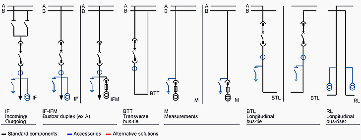

The number of different cubicles within the switchgear is coupled together by the busbars. In an air-insulated construction, these busbars are placed in a metal-enclosed compartment surrounded by normal air. With the gas-insulated construction, the busbars are placed in a hermetically sealed metal enclosure under pressurized insulating gas (SF6).
Depending on the manufacturer, the busbar compartment can be divided into cubicle-wide sections.
Typical busbar arrangements supported by the different switchgear manufacturers are the single-busbar and double-busbar arrangements.
Example of typical cubicles for double-busbar solution
Figure 3 – Example of typical cubicles for double-busbar solution

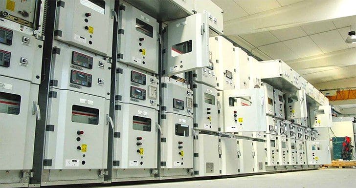

The protection relays are externally powered advanced Intelligent Electronic Devices (IEDs), also referred to as Feeder Terminals. In a modern primary switchgear, the bay-dedicated functions like protection, control and measurement are carried out with Feeder Terminals.
The Feeder Terminal performs the as signed protection functions, carries out the local and remote control of switching devices, gathers and processes and displays measured data and indicates the status of the switching devices.
Air-insulated primary switchgear equipped with Feeder Terminals (type 'UniGear ZS1')
Figure 4 – Air-insulated primary switchgear equipped with Feeder Terminals (type ‘UniGear ZS1’)
