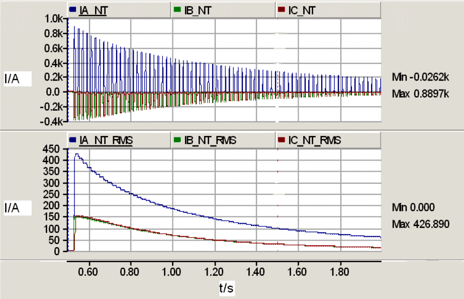

Inrush current of a 16 MVA 63/11 kV power transformer
Figure 1 – Inrush current of a 16 MVA 63/11 kV power transformer
With modern power transformers, the inrush current tends to be higher than with older ones.
The reason behind this are the properties of the modern core steel, allowing higher flux densities in the transformer design during normal operation and therefore giving less “room” before the core saturation takes place during the connection to the network.
The residual current, sum of the phase currents, should be zero if the core does not saturate and poles are closing exactly at the same time. With a Y-connected and effectively earthed neutral power transformer, the inrush current appears also in the neutral, in case the core saturates.
The inrush current contains the second harmonic, which can be used for detecting the inrush condition by the transformer protection relays, like current differential protection.
The behavior of inrush current with a 16 MVA 63/11 kV power transformer as a function of time is shown in the above Figure 1.
The transformer is energized against a relatively weak supply network. The rated primary current of the transformer in question is 147 A. The upper part shows the wave form of each phase current and lower part shows the RMS value of each phase current.
From the figure it can be noted that the inrush current includes also a relatively large DC-component. The DC-component can lead to saturation of current measurement transformers, thus giving out false secondary signal to protection relays.

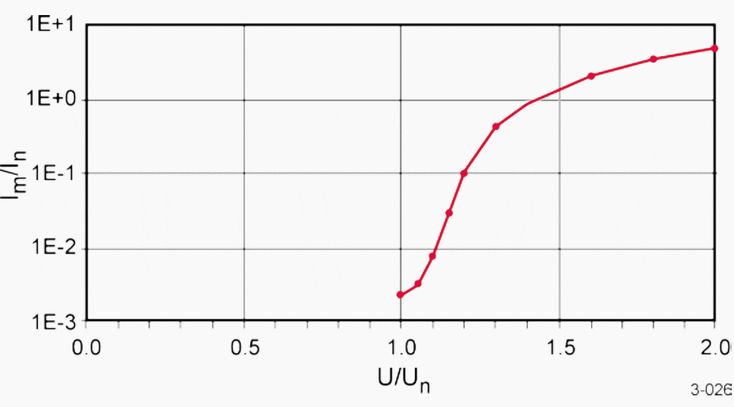

2. Magnetizing Current
The magnetizing current at the rated voltage is very small, around 1% out of the rated current. The magnetizing current is heavily dependent on supply voltage level, though.
When the supply voltage level increases, the magnetizing current starts to climb rapidly. The steepness of the rising current curve depends on the magnetic properties of the core and the flux density at rated voltage.
The figure below shows the behavior of a certain power transformer.
The RMS value of the magnetizing current as a function of supply voltage
Figure 2 – The RMS value of the magnetizing current as a function of supply voltage
The increasing magnetizing current has a high content of the fifth harmonic, which can be used to detect the phenomena. The following figure demonstrates the issue and the behavior of a certain power transformer.
The fifth harmonic content in magnetizing current as a function of supply voltage
Figure 3 – The fifth harmonic content in magnetizing current as a function of supply voltage
The phenomenon related to an increasing magnetizing current as a result of increasing supply voltage is referred to as over-excitation.

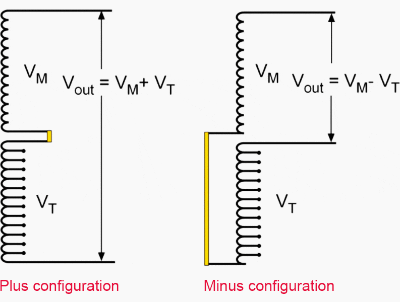

Out of these three, the first one, plus-minus switching, is the most common. The operation principle is shown below.
Tap changer’s "plus-minus switching" principle
Figure 4 – Tap changer’s “plus-minus switching” principle
Typically, the on-load tap changer is motor-operated, providing a possibility for remote control. The off-load tap changer is most commonly having manual operation facilities only, but also a motor operation is possible.
The on-load tap changer has a number of taps, like ±8×1.25%. This indicates a possibility of an 8-step, each 1.25%, increase or decrease from the rated voltage ratio. The off-load tap changer has fewer steps, like for example ±2×2.5%.

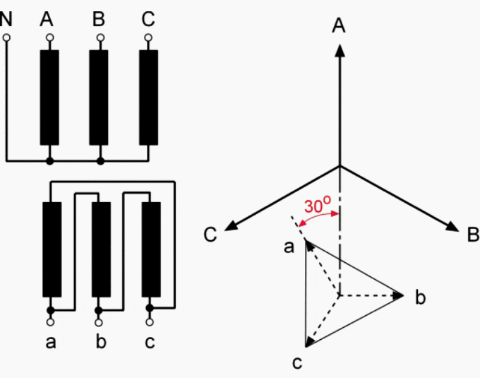

The numbers are used to indicate the phase shift between primary and secondary voltages. The reference point is the primary side phase-to-earth voltage, which is compared to a similar voltage on the secondary side.
The numbers used are from 1 to 12(0) referring to a normal clock’s time dial.
Winding arrangement and corresponding time dial of YNd11-connected power transformer
Figure 5 – Winding arrangement and corresponding time dial of YNd11-connected power transformer

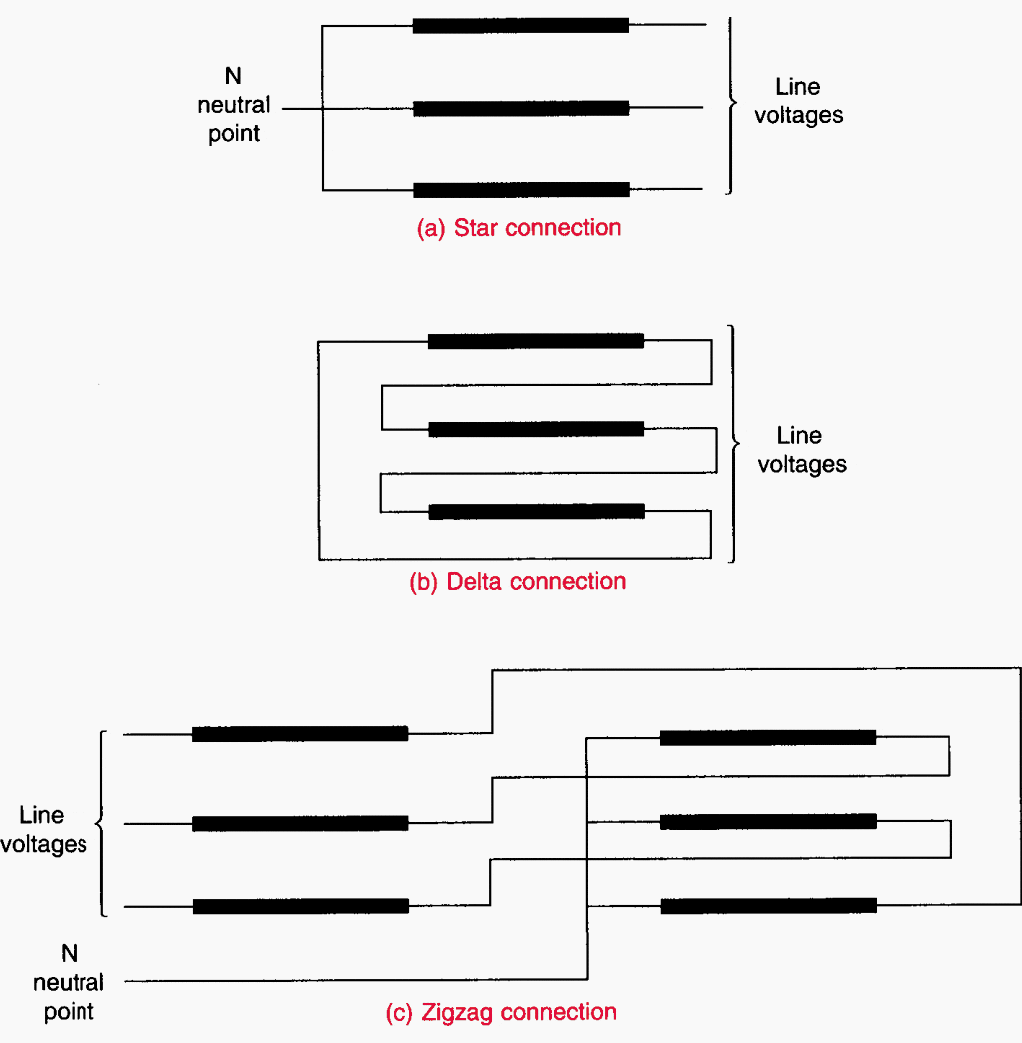

Three-phase transformers are usually operated with the high-voltage and low-voltage windings connected in:
  • Y (star),
  • D (delta) or
  • Z (zigzag) connection.
The three styles are shown in Figure 6.
Three-phase winding connections
Figure 6 – Three-phase winding connections
In star connection, one end of each of the three-phase windings is joined together at a neutral point N and line voltage is applied at the other end; this is shown in Figure 6(a).
The advantages of star connection are:
  1. It is cheaper for a high-voltage winding.
  2. The neutral point is available.
  3. Earthing is possible, either directly or through an impedance.
  4. Reduced insulation level (graded insulation) is possible at the neutral.
  5. Winding tappings and tap-changer may be located at the neutral end of each phase, with low voltages to earth and between phases.
  6. Single-phase loading is possible, with a neutral current flowing.
In delta connection, the ends of the three windings are connected across adjacent phases of the supply as shown in Figure 6(b).
The advantages of a delta connection are:
  1. It is cheaper for a high-current low-voltage winding
  2. In combination with a star winding, it reduces the zero-sequence impedance of that winding
A delta-connected tertiary winding is often used on large three-phase autotransformers to allow zero-phase sequence currents to circulate within the windings, or to allow triplen-frequency harmonic currents to flow in order to cancel out harmonic fluxes in the core.
The zigzag connection is used for special purposes where two windings are available on each leg and are interconnected between phases as shown in Figure 6(c).
The main advantage of a zigzag connection is: It permits neutral current loading with an inherently low zero-sequence impedance, and it is used in grounding transformers to create an artificial neutral terminal on the system

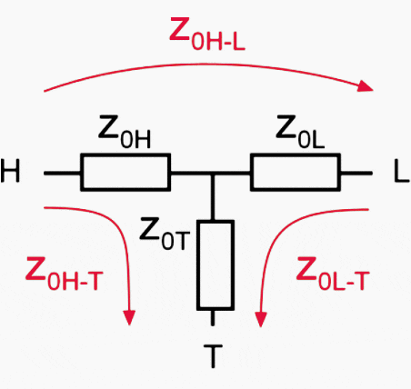

The effect of power transformer’s connection group to the zero-sequence impedance is studied more closely. The below stated relative zero-sequence impedance values are for guidance only and the actual values have to be checked from the actual transformer’s data sheets.
Furthermore, the stated values refer to a core-type construction with three-limb design.
The following definitions have been used:
  • H: High-voltage (primary) winding
  • L: Low-voltage (secondary) winding
  • T: Tertiary winding
  • E: Earth potential
  • z: Relative short circuit impedance
  • z0HL: Relative zero-sequence impedance from high-voltage to low-voltage side
  • z0HE: Relative zero-sequence impedance from high-voltage side to earth
  • z0LE: Relative zero-sequence impedance from low-voltage side to earth

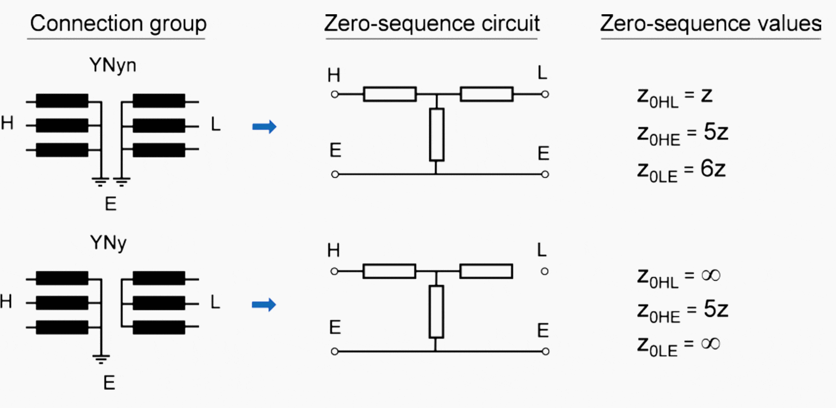

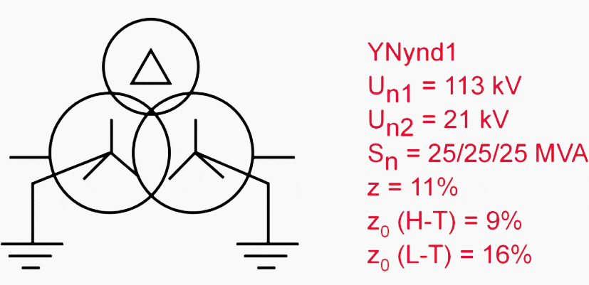

Zero-sequence impedances of YNyn- and YNy-connected power transformers as a relation to the units’ short circuit impedance
Figure 8 – Zero-sequence impedances of YNyn- and YNy-connected power transformers as a relation to the units’ short circuit impedance
If the above presented power transformer is of the five-limb design or the three-phase bank is constructed out of single-phase units, the values of Z0HE and Z0LE are basically infinite.
Zero-sequence impedances of YNd- and Dyn-connected power transformers as a relation to the units’ short circuit impedance
Figure 9 – Zero-sequence impedances of YNd- and Dyn-connected power transformers as a relation to the units’ short circuit impedance
If the above presented power transformer is of the five-limb design or the three-phase bank is constructed out of single single-phase units, the z0HE in the YNd-connection is equal to z.

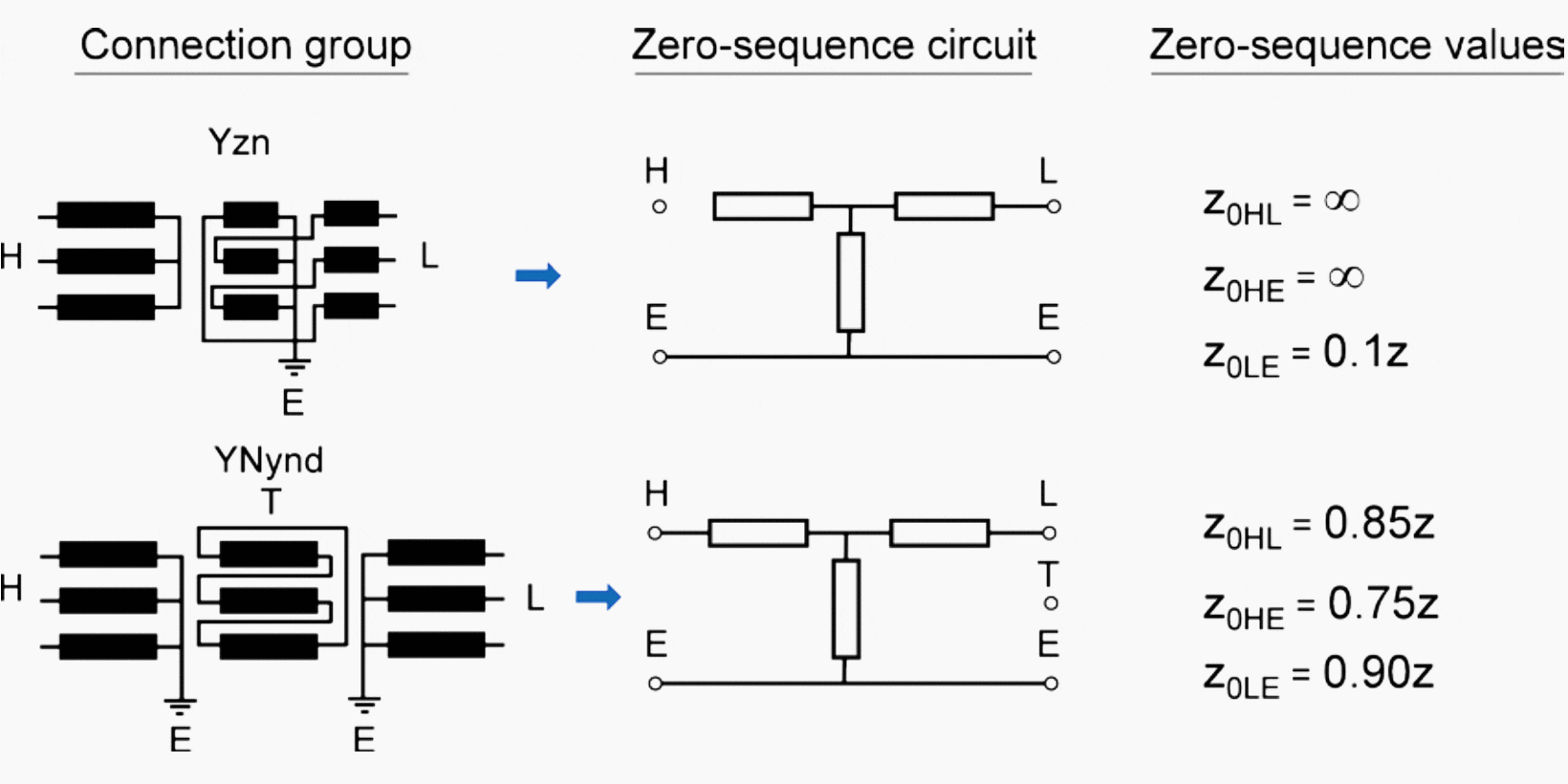

Zero Zero-sequence impedances of Yzn- and YNynd-connected power transformers as a relation to the units’ short circuit impedance
Figure 10 – Zero Zero-sequence impedances of Yzn- and YNynd-connected power transformers as a relation to the units’ short circuit impedance
Normal procedure for the power transformer manufactures is to state the zero-sequence impedance in relative values, either as a fraction or a percentage of the reference impedance.
For calculating the actual ohmic values, the same equations as introduced for the short circuit impedance calculations can be used.
With transformer connection groups allowing the closed loop for zero-sequence current to circulate, like YNd, the real and imaginary parts of the zero-sequence impedance have the same relation (ratio of R/X) as with the corresponding short circuit impedance. With other connection groups, the situation is more complicated, while the R/X ratio is not necessarily linear.
For three-winding power transformers, the calculation of zero-sequence impedance ohmic values is a bit more complicated.
In this example, the following information is available in the power transformer’s data sheets.
Data for the power transformer used in calculation example
Figure 11 – Data for the power transformer used in calculation example
