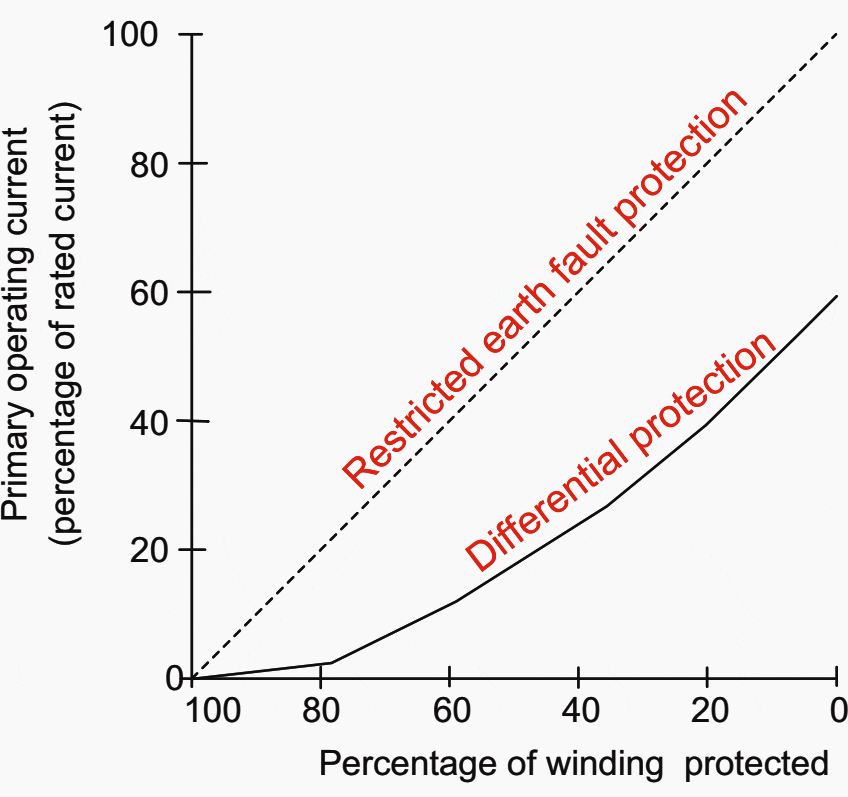

The advantages to be obtained by the use of restricted earth fault protection, discussed in previous article lead to the system being frequently used in conjunction with an overall differential system.
The importance of this is shown in Figure 11 from which it will be seen that if the neutral of a star-connected winding is earthed through a resistance of one per unit, an overall differential system having an effective setting of 20% will detect faults in only 42% of the winding from the line end.
Amount of winding protected when transformer is resistance earthed and ratings of transformer and resistor are equal
Figure 11 – Amount of winding protected when transformer is resistance earthed and ratings of transformer and resistor are equal

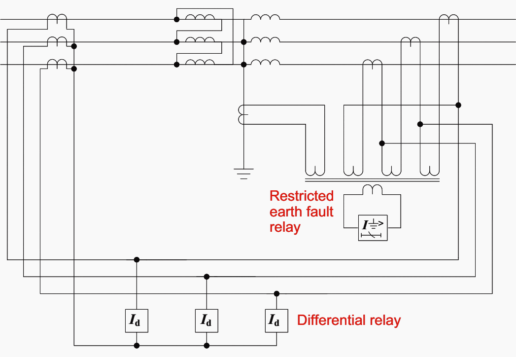

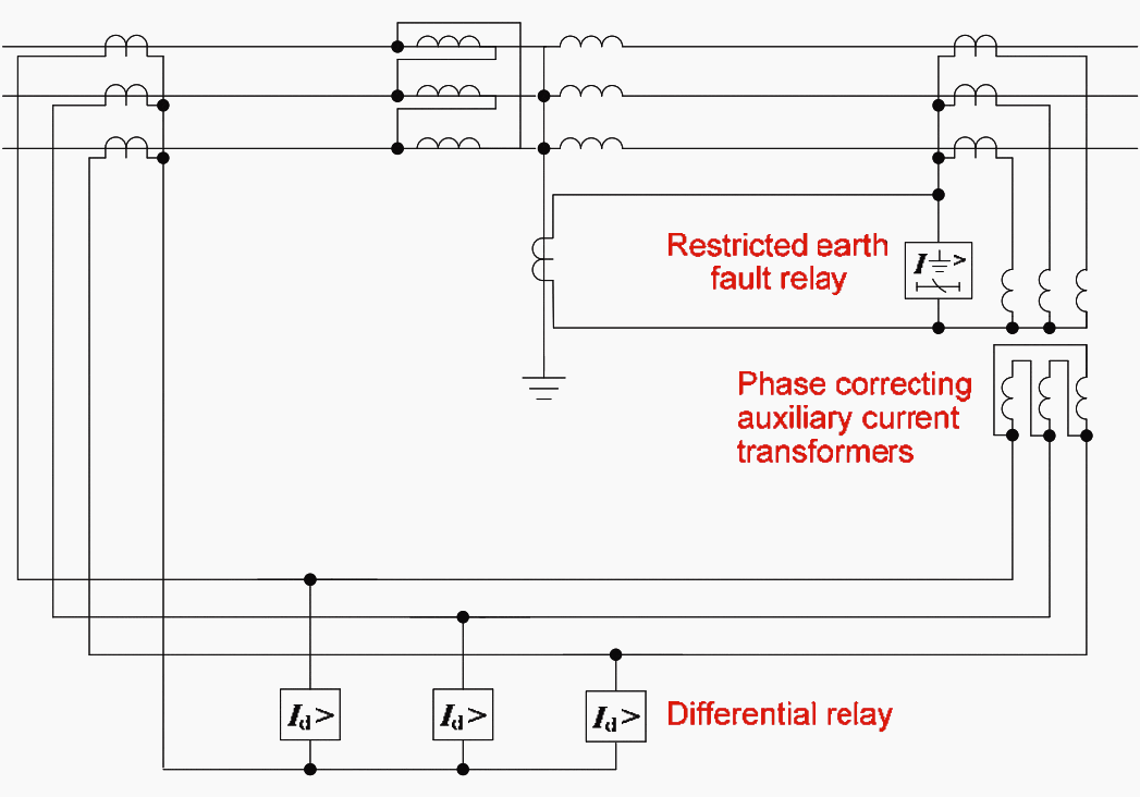

Implementation of a combined differential/REF protection scheme is made easy if a numerical relay with software ratio/phase compensation is used. All compensation is made internally in the relay.
Where software ratio/phase correction is not available, either a summation transformer or auxiliary CTs can be used. The connections are shown in Figure 12 and Figure 13 respectively.
Care must be taken in calculating the settings, but the only significant disadvantage of the Combined Differential/REF scheme is that the REF element is likely to operate for heavy internal faults as well as the differential elements, thus making subsequent fault analysis somewhat confusing.
However, the saving in CTs outweighs this disadvantage.
Combined differential and earth fault protection using summation current transformer
Figure 12 – Combined differential and earth fault protection using summation current transformer
Combined differential and restricted earth fault protection using auxiliary CTs
Figure 13 – Combined differential and restricted earth fault protection using auxiliary CTs

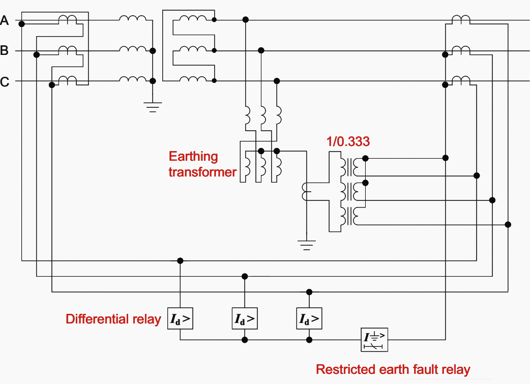

5.1 Application when an earthing transformer is connected within the protected zone
A delta-connected winding cannot deliver any zero sequence current to an earth fault on the connected system, any current that does flow is in consequence of an earthed neutral elsewhere on the system and will have a 2-1-1 pattern of current distribution between phases.
When the transformer in question represents a major power feed, the system may be earthed at that point by an earthing transformer or earthing reactor. They are frequently connected to the system, close to the main supply transformer and within the transformer protection zone.
Zero sequence current that flows through the earthing transformer during system earth faults will flow through the line current transformers on this side, and, without an equivalent current in the balancing current transformers, will cause unwanted operation of the relays.
The problem can be overcome by subtracting the appropriate component of current from the main CT output. The earthing transformer neutral current is used for this purpose. As this represents three times the zero sequence current flowing, ratio correction is required. This can take the form of interposing CT’s of ratio 1/0.333, arranged to subtract their output from that of the line current transformers in each phase, as shown in Figure 14.
The zero sequence component is canceled, restoring balance to the differential system. Alternatively, numerical relays may use software to perform the subtraction, having calculated the zero sequence component internally.
Differential protection with in-zone earthing transformer, with restricted earth fault relay
Figure 14 – Differential protection with in-zone earthing transformer, with restricted earth fault relay

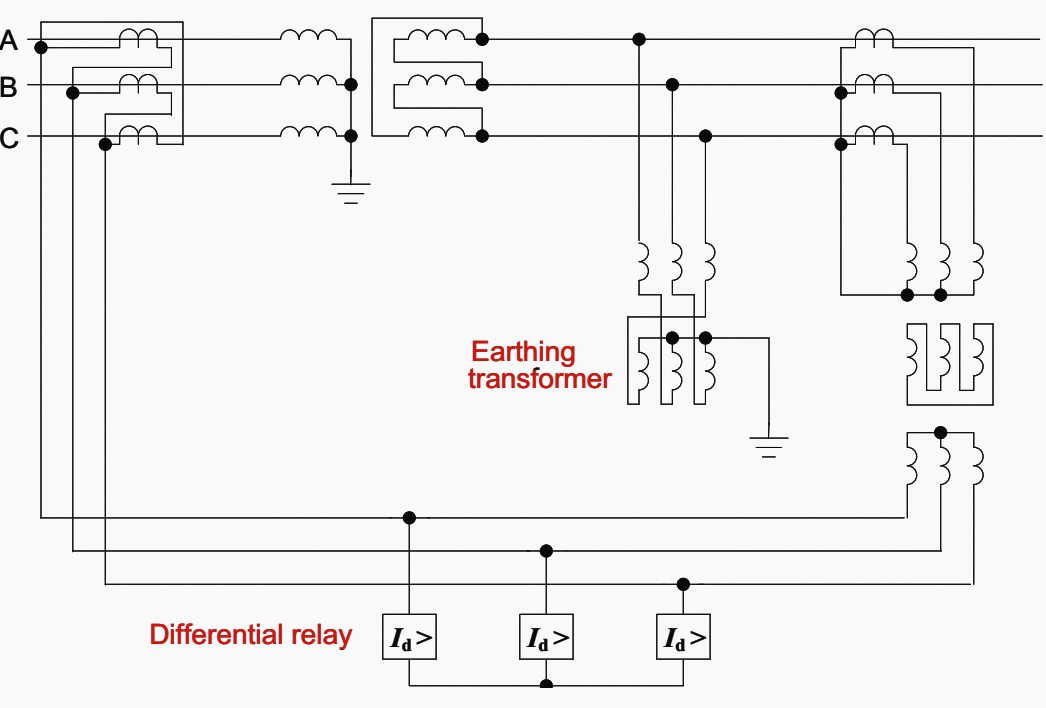

A high impedance relay element can be connected in the neutral lead between current transformers and differential relays to provide restricted earth fault protection to the winding.
As an alternative to the above scheme, the circulating current system can be completed via a three-phase group of interposing transformers that are provided with tertiary windings connected in delta.
This winding effectively short-circuits the zero sequence component and thereby removes it from the balancing quantities in the relay circuit.
See Figure 15.
Differential protection with in-zone earthing transformer and no earth fault relay
Figure 15 – Differential protection with in-zone earthing transformer and no earth fault relay
Provided restricted earth fault protection is not required, the scheme shown in Figure 15 has the advantage of not requiring a current transformer, with its associated mounting and cabling requirements, in the neutral-earth conductor.

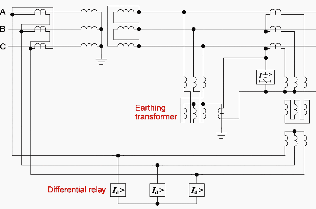

The scheme can also be connected as shown in Figure 16 when restricted earth fault protection is needed.
Differential protection with in-zone earthing transformer, with alternative arrangement of restricted earth fault relay
Figure 16 – Differential protection with in-zone earthing transformer, with alternative arrangement of restricted earth fault relay

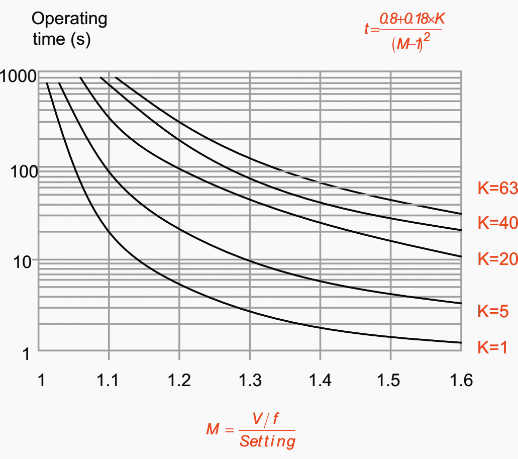

6. Overfluxing protection
Overfluxing arises principally from the following system conditions:
  1. High system voltage
  2. Low system frequency
  3. Geomagnetic disturbances
The latter results in low frequency earth currents circulating through a transmission system. Since momentary system disturbances can cause transient overfluxing that is not dangerous, time delayed tripping is required.
The normal protection is an IDMT or definite time characteristic, initiated if a defined V/f threshold is exceeded. Often separate alarm and trip elements are provided. The alarm function would be definite time-delayed and the trip function would be an IDMT characteristic.
A typical characteristic is shown in Figure 17.
Geomagnetic disturbances may result in overfluxing without the V/f threshold being exceeded. Some relays provide a 5th harmonic detection feature, which can be used to detect such a condition, as levels of this harmonic rise under overfluxing conditions.
Typical IDMT characteristic for overfluxing protection
Figure 17 – Typical IDMT characteristic for overfluxing protection

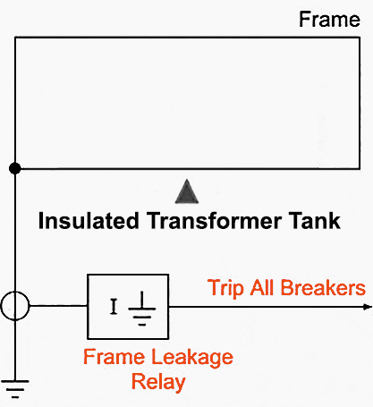

7. Tank-earth protection
This is also known as Howard protection. If the transformer tank is nominally insulated from earth (an insulation resistance of 10 ohms being sufficient) earth fault protection can be provided by connecting a relay to the secondary of a current transformer the primary of which is connected between the tank and earth.
This scheme is similar to the frame-earth fault busbar protection described in this technical article.
Howard protection scheme applied to tank-earth protection
Figure 18 – Howard protection scheme applied to tank-earth protection

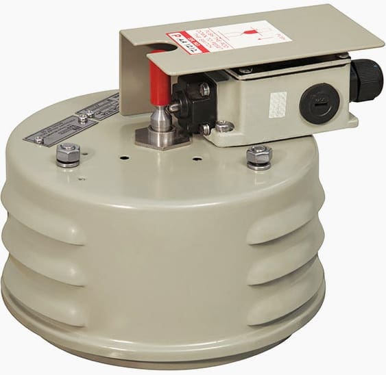

8.1 Oil pressure relief devices
The simplest form of pressure relief device is the widely used ‘frangible disc’ that is normally located at the end of an oil relief pipe protruding from the top of the transformer tank.
The surge of oil caused by a serious fault bursts the disc, so allowing the oil to discharge rapidly. Relieving and limiting the pressure rise avoids explosive rupture of the tank and consequent fire risk.
Outdoor oil-immersed transformers are usually mounted in a catchment pit to collect and contain spilt oil (from whatever cause), thereby minimizing the possibility of pollution. A drawback of the frangible disc is that the oil remaining in the tank is left exposed to the atmosphere after rupture.
This is avoided in a more effective device, the sudden pressure relief valve, which opens to allow discharge of oil if the pressure exceeds a set level, but closes automatically as soon as the internal pressure falls below this level. If the abnormal pressure is relatively high, the valve can operate within a few milliseconds, and provide fast tripping when suitable contacts are fitted.
The device is commonly fitted to power transformers rated at 2MVA or higher, but may be applied to distribution transformers rated as low as 200kVA, particularly those in hazardous areas.
Figure 19 – Oil pressure relief device

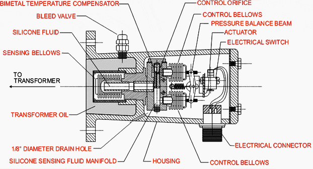

8.2 Sudden pressure rise relay
This device detects rapid rise of pressure rather than absolute pressure and thereby can respond even quicker than the pressure relief valve to sudden abnormally high pressures.
Sensitivities as low as 0.07bar/s are attainable, but when fitted to forced-cooled transformers the operating speed of the device may have to be slowed deliberately to avoid spurious tripping during circulation pump starts.
Alternatively, sudden pressure rise relays may have their output supervised by instantaneous high-set overcurrent elements.
Sudden pressure relief valve
Figure 20 – Sudden pressure relief valve

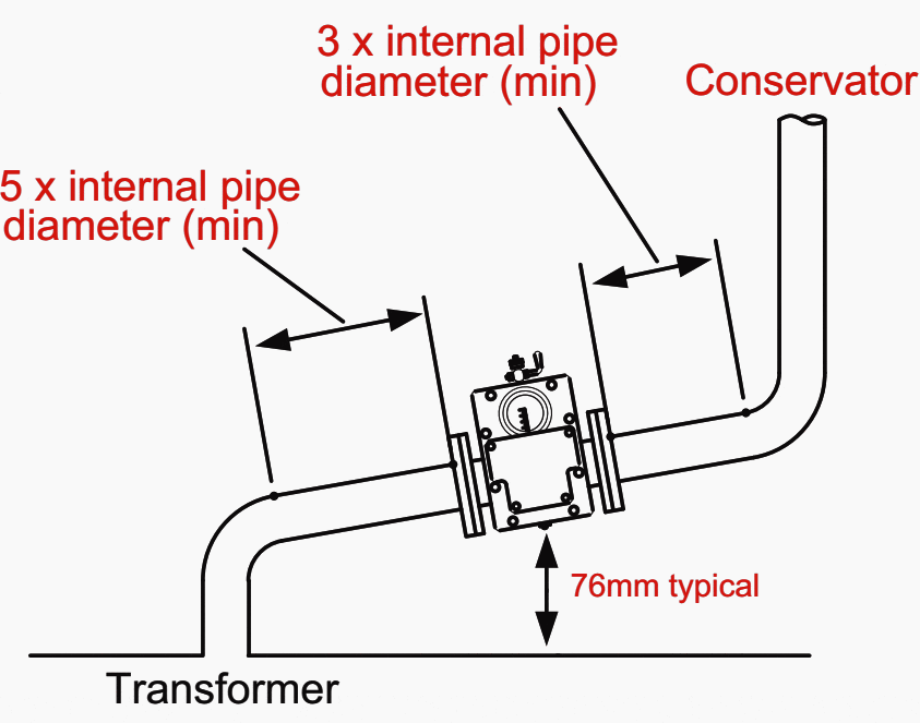

8.3 Buchholz protection
Buchholz protection is normally provided on all transformers fitted with a conservator. The Buchholz relay is contained in a cast housing which is connected in the pipe to the conservator, as in Figure 21.
A typical Buchholz relay will have two sets of contacts. One is arranged to operate for slow accumulations of gas, the other for bulk displacement of oil in the event of a heavy internal fault.
An alarm is generated for the former, but the latter is usually direct-wired to the CB trip relay.
Buchholz relay mounting arrangement
Figure 21 – Buchholz relay mounting arrangement
The device will therefore give an alarm for the following fault conditions, all of which are of a low order of urgency.
  • Hot spots on the core due to short circuit of lamination insulation
  • Core bolt insulation failure
  • Faulty joints
  • Interturn faults or other winding faults involving only lower power infeeds
  • Loss of oil due to leakage
When a major winding fault occurs, this causes a surge of oil, which displaces the lower float and thus causes isolation of the transformer.
This action will take place for:
  • All severe winding faults, either to earth or inter-phase
  • Loss of oil if allowed to continue to a dangerous degree
An inspection window is usually provided on either side of the gas collection space. Visible white or yellow gas indicates that insulation has been burnt, while black or grey gas indicates the presence of, dissociated oil. In these cases the gas will probably be inflammable, whereas released air will not.
A vent valve is provided on the top of the housing for the gas to be released or collected for analysis. Transformers with forced oil circulation may experience oil flow to/from the conservator on starting/stopping of the pumps.
The Buchholz relay must not operate in this circumstance.
Cleaning operations may cause aeration of the oil. Under such conditions, tripping of the transformer due to Buchholz operation should be inhibited for a suitable period.
Because of its universal response to faults within the transformer, some of which are difficult to detect by other means, the Buchholz relay is invaluable, whether regarded as a main protection or as a supplement to other protection schemes.
Tests carried out by striking a high voltage arc in a transformer tank filled with oil, have shown that operation times of 0.05s-0.1s are possible. Electrical protection is generally used as well, either to obtain faster operation for heavy faults, or because Buchholz relays have to be prevented from tripping during oil maintenance periods.
Conservators are fitted to oil-cooled transformers above 1000kVA rating, except those to North American design practice that use a different technique.
