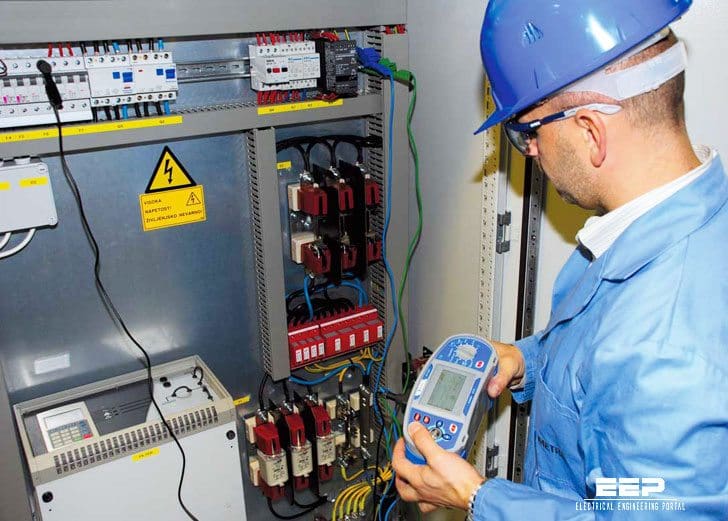

Power Measurement On Four-Wire System (on photo: Measuring power with Metrel's device MI 3102 Eurotest XE; credit: itrservis.ru)
When measuring power on a three-phase system, it is really necessary to take into consideration the fact that the three-phase power supply system might not be balanced (pointers of phase to phase voltages UL1/L2, UL2/L3 and UL3/L1 taken in sequence do not form an equilateral triangle).

All three power levels can be read out directly on the display of metering device. This method enables power measurement on all three phases simultaneously and is particularly suitable for unbalanced power. In the case of balanced power, one wattmeter can be used and moved to all three phases in three steps.
