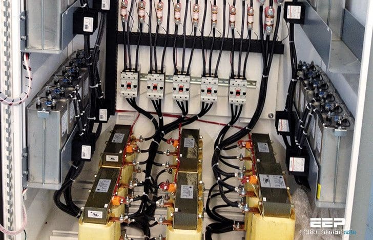

Why Do We Care So Much About Power Factor Correction? (on photo: The capacitor battery with the case open; credit: zenex.pl)
Power factor correction capacitors can be switched in and out as necessary to maintain var and voltage control.
