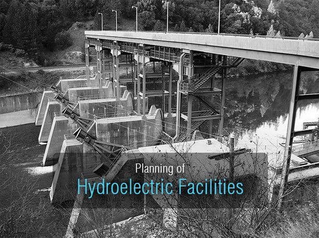

Feather River Scenic Byway
Feather River Scenic Byway. Hydroelectric facility – this one utilizing several gates to close off the river, forming a dam. (Photo by Matthew High at Flickr)
