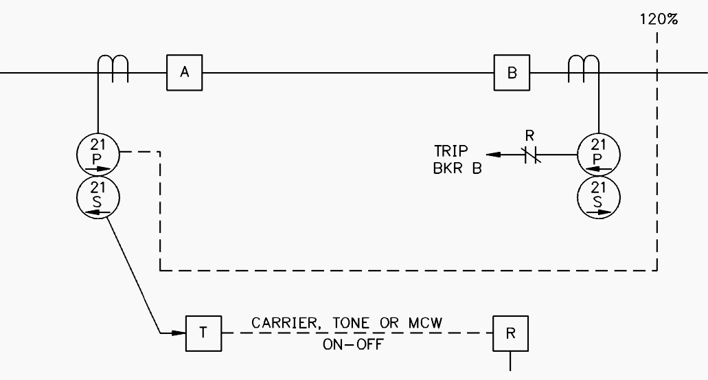

1.1 Blocking Schemes

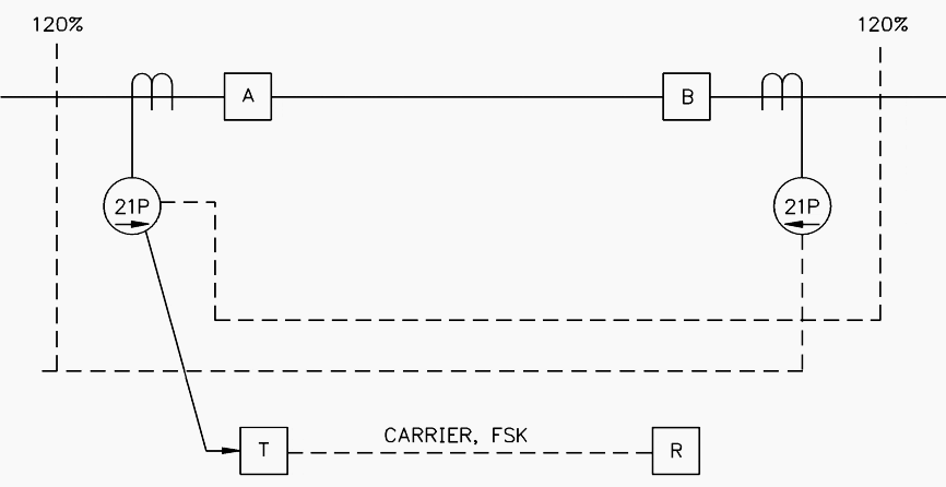

Directional comparison blocking uses distance relays as directional indicators and block initiation for phase faults. Either distance or directional overcurrent relays may be used for ground fault indicators and block initiation.
Each terminal has trip and start relays. The trip relay reaches toward the remote terminal and a little beyond. The start relay reaches backwards, away from the protected section. The trip relay attempts tripping when it operates unless it is stopped by receipt of a blocking signal (carrier, audio tone, or microwave) from the remote end. The start relays at each end initiate the blocking signal.
Thus, if only the trip relays see the fault, it is within the protected section and both ends trip. If the fault is just outside one end, the start relays at that end operate and send a block signal to the remote end, which would otherwise trip. The ground relays operate similarly.
A tripping delay is necessary to allow for the receipt of the blocking signal. A typical delay time of 6 to 16 msec is used to coordinate for the channel delay in communications.
The communication channel is not required for tripping the breakers since the breakers will trip in the absence of the blocking signal. Failure of the channel could result in overtripping of the breakers for adjacent line faults within the reach setting of the distance relays.
Blocking directional comparison is commonly used with on/off type carrier facilities. Since it is not necessary to drive a signal through a fault to operate this scheme, it is the most popular carrier relaying system. See Figure 1.
Blocking Directional Comparison
Figure 1 – Blocking Directional Comparison

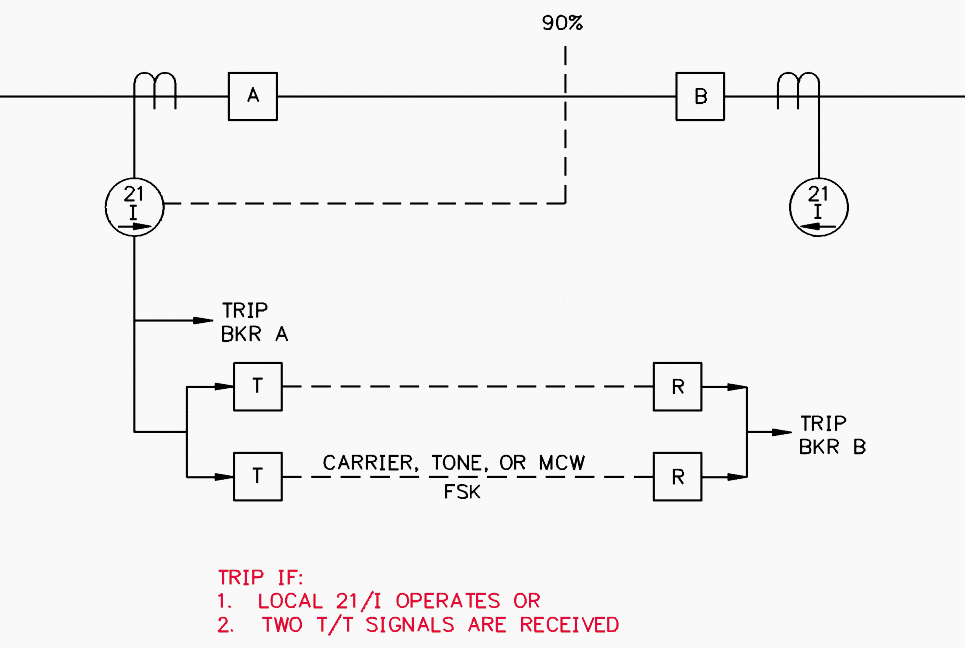

1.4.1 Direct Underreach
This form of protection requires only a single distance fault detector at each end. It has to be set short of the remote end and will simultaneously trip the local breaker and send a trip signal to the remote end, which then trips directly upon receipt of the signal.
Note that local confirmation is not required upon receipt of a trip signal.
Though this scheme is the least complex, it is seldom used because of the high risk of false outputs from the communication channel, which would result in false trips. This risk can be minimized by using a dual-channel transfer trip, which requires the receipt of two signals from the remote end to effect a trip.
See Figure 3.
Direct Underreach Scheme
Figure 3 – Direct Underreach Scheme

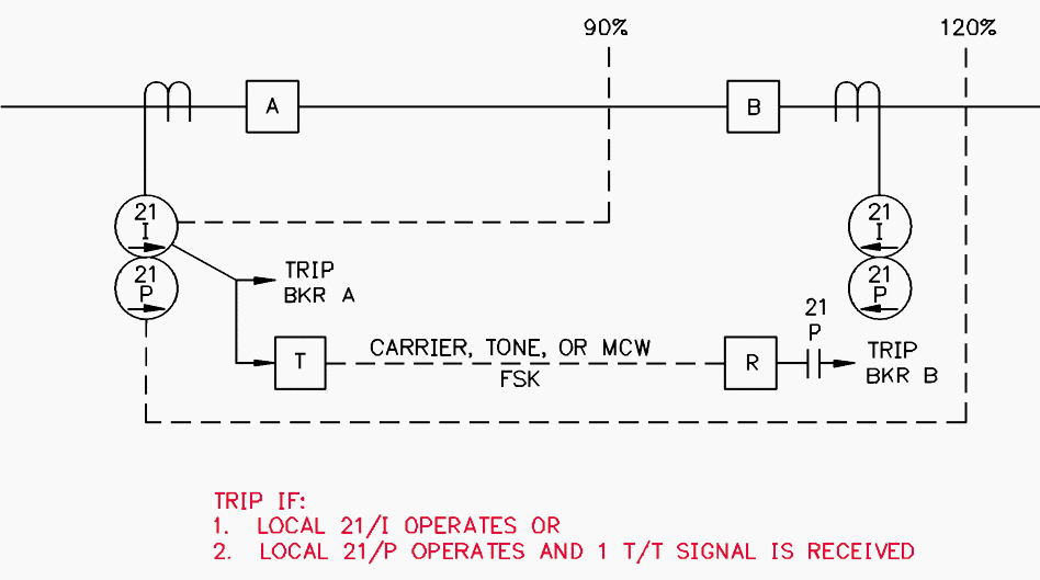

1.4.2 Permissive Underreach
This scheme is identical to the direct underreach scheme with the addition of an overreaching fault detector. The transfer trip signal requires local confirmation by this fault detector before tripping can occur. This increases the security of the scheme and the consequent range of application.
It is commonly selected when an existing step distance relay line is to have the pilot added. See Figure 4.
Carrier is not normally used since a fault could short out the communication signal and prevent the signal from reaching the remote terminal.
Permissive Underreach Scheme
Figure 4 – Permissive Underreach Scheme

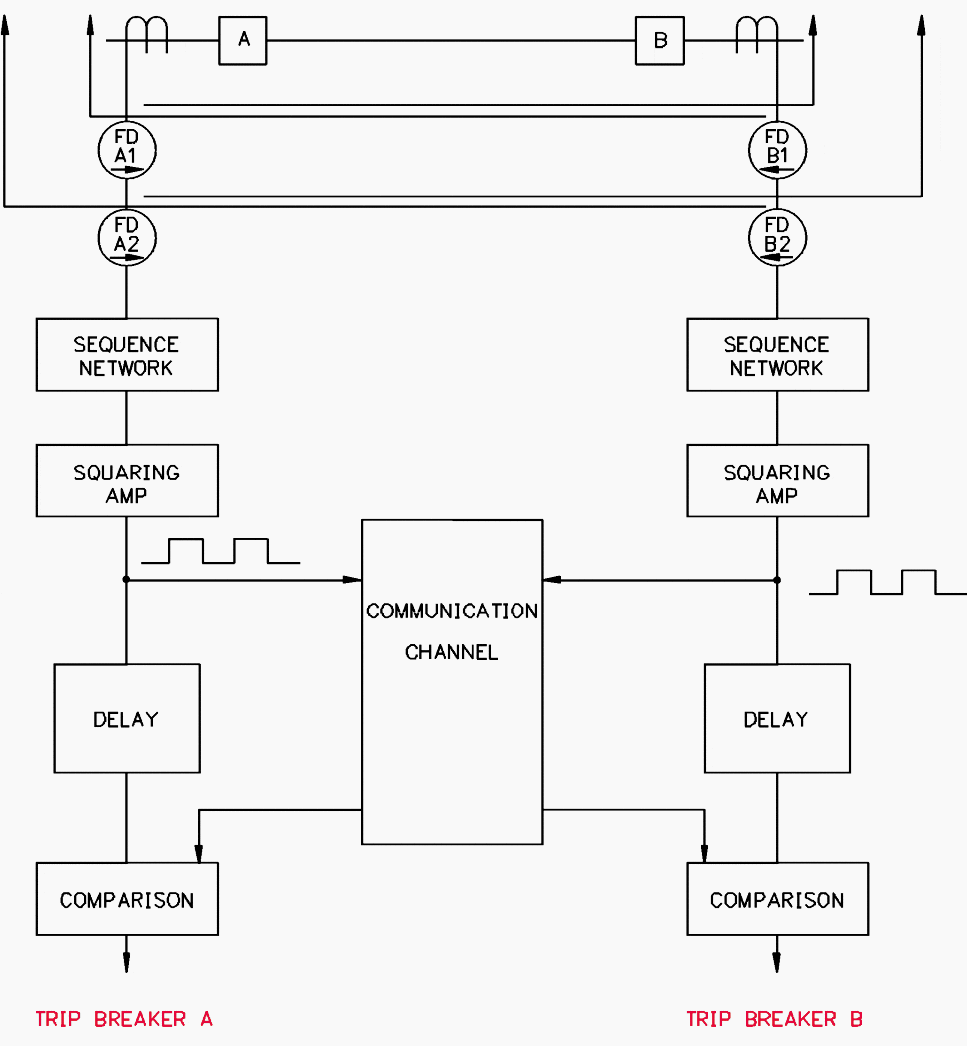

2.2 Single-Phase Comparison
This scheme applies a sequencing network to the current inputs to the relay to produce a single-phase voltage output. This output is proportional to the positive, negative, and zero phase sequence components of the input currents.
This signal is squared so that the positive portion of the signal provides the positive portion of the square wave.
The negative portion of the signal provides the zero portion of the square wave. Two fault detectors are normally used to provide security, with the more sensitive detector used as the carrier start to transmit the signal to the remote end. The less sensitive detector is used to arm the comparison module for a trip upon the correct comparison of the local and remote signals.
See Figure 5.
Normally current-operated units are used as the fault detectors. In a case where the fault current is less than the load current, impedance-operated units may be used for fault detection.
The use of impedance fault detectors will increase the cost of the system because of the necessity of having line potentials for the operation of the relay.
Single-Phase Comparison Scheme
Figure 5 – Single-Phase Comparison Scheme
