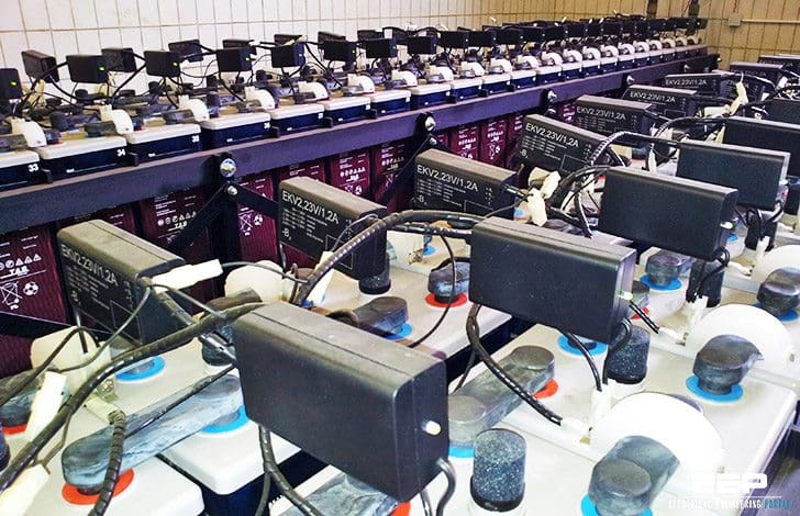

Batteries need to be sized correctly to be able to feed the required load for the required time, and a number of factors need to be decided to be able to optimize the battery for the duty expected. Some of these factors are fixed within the chemistry of each type of cell and, in some cases, the physical structure of the plates that make up the cell.
3 performance factors you must consider when sizing batteries
3 performance factors you must consider when sizing batteries (photo credit: Edvard CSANYI)
The performance is also influenced by the temperature and other location factors, and as an optimal combination of cells is needed to provide the required performance, the following important factors need to be considered:
