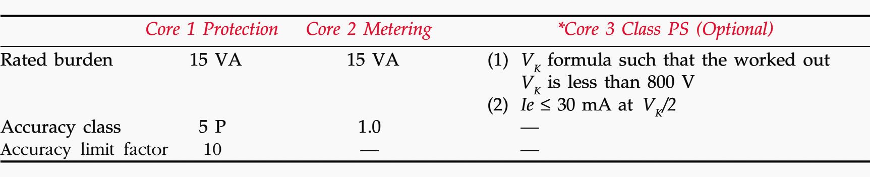

A basic indoor wound/slot type CT with two cores is chosen with the following rating. The third core is optional.
Table 1 – Rating for Indoor Wound/Slot Type CT
*Applicable for CT secondary current of 1 A and only 1/√3 A voltage class and insulation level that is any of the three depicted in Table 2.

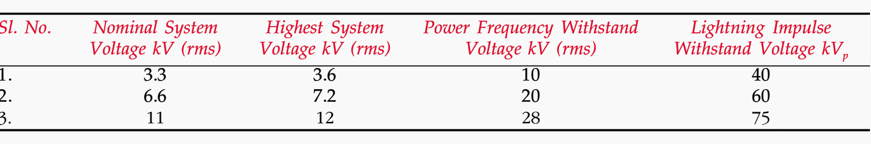

Table 2 – Basic Insulation Levels for CTs

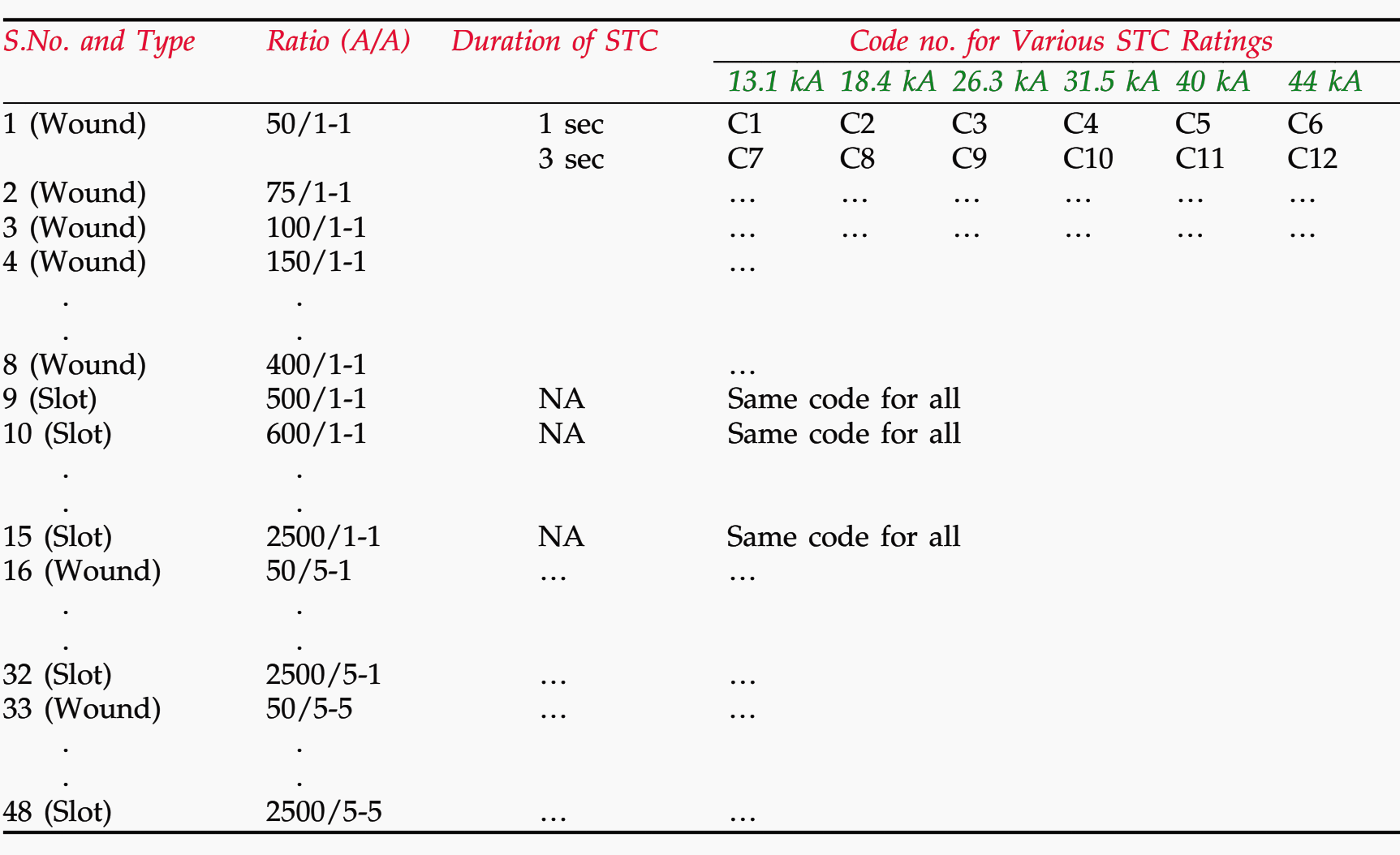

The ISF for the metering core should be < 5 for the lowest ratio and < 10 for the higher ratio. CT dimensions for wound type and slot type CTs should be consonant with slot size and should be clearly mentioned.
The STC rating, duration of STC and CT ratios are specified in Table 3 involving a total of 312 types of CTs.
Table 3 – List of CT Code Numbers

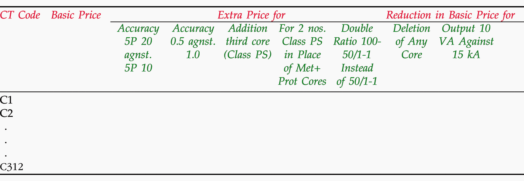

Each of the 312 codes mentioned in Table 3 is reproduced in Table 4 below. Here, the CT user is asking for price addition/deletion for various factors from the manufacturer. For intermediate ratios, the price of the nearest lower ratio shall be considered.
Use of above CT selection and pricing tables solves the problem of CT costing and standardization. This obviates the need for the user to obtain cost data from the manufacturer every time.
