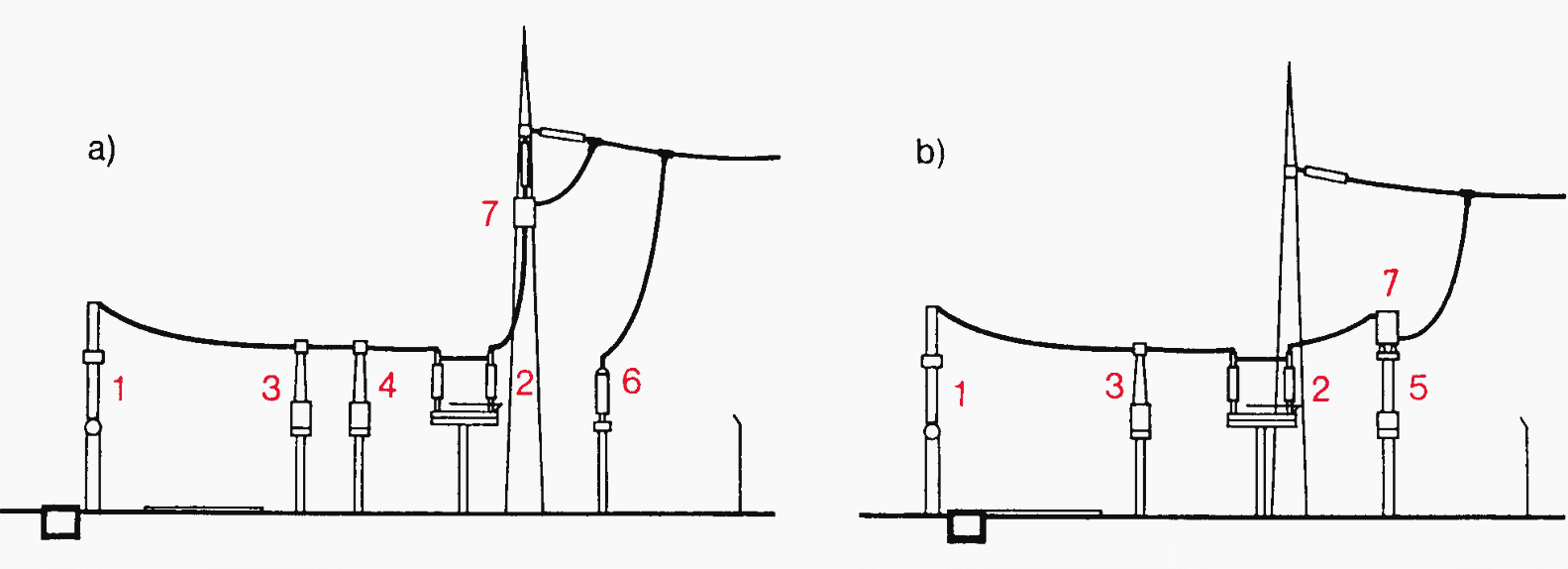

The overhead lines leading from the transformer stations are generally also used for power-line carrier telephony. The necessary equipment (line trap, capacitor) is incorporated in the outgoing overhead lines as shown in Figure 1.
Arrangement of overhead line bays for power-line carrier telephony
Figure 1 – Arrangement of overhead line bays for power-line carrier telephony a) Line trap suspended, capacitor standing, b) Line trap mounted on capacitive voltage transformer
Where:
  1. Circuit-breaker
  2. Feeder disconnector
  3. Current transformer
  4. Inductive voltage transformer
  5. Capacitive voltage transformer
  6. Capacitor
  7. Line trap
Points in favour of rotary and vertical-break disconnectors are their mechanical simplicity and the fact that they are easier to position as feeder disconnectors.
The single-column disconnector makes for a simple station layout owing to its isolating distance between the two line levels. It saves some 20% of the ground area needed for two-column disconnectors.

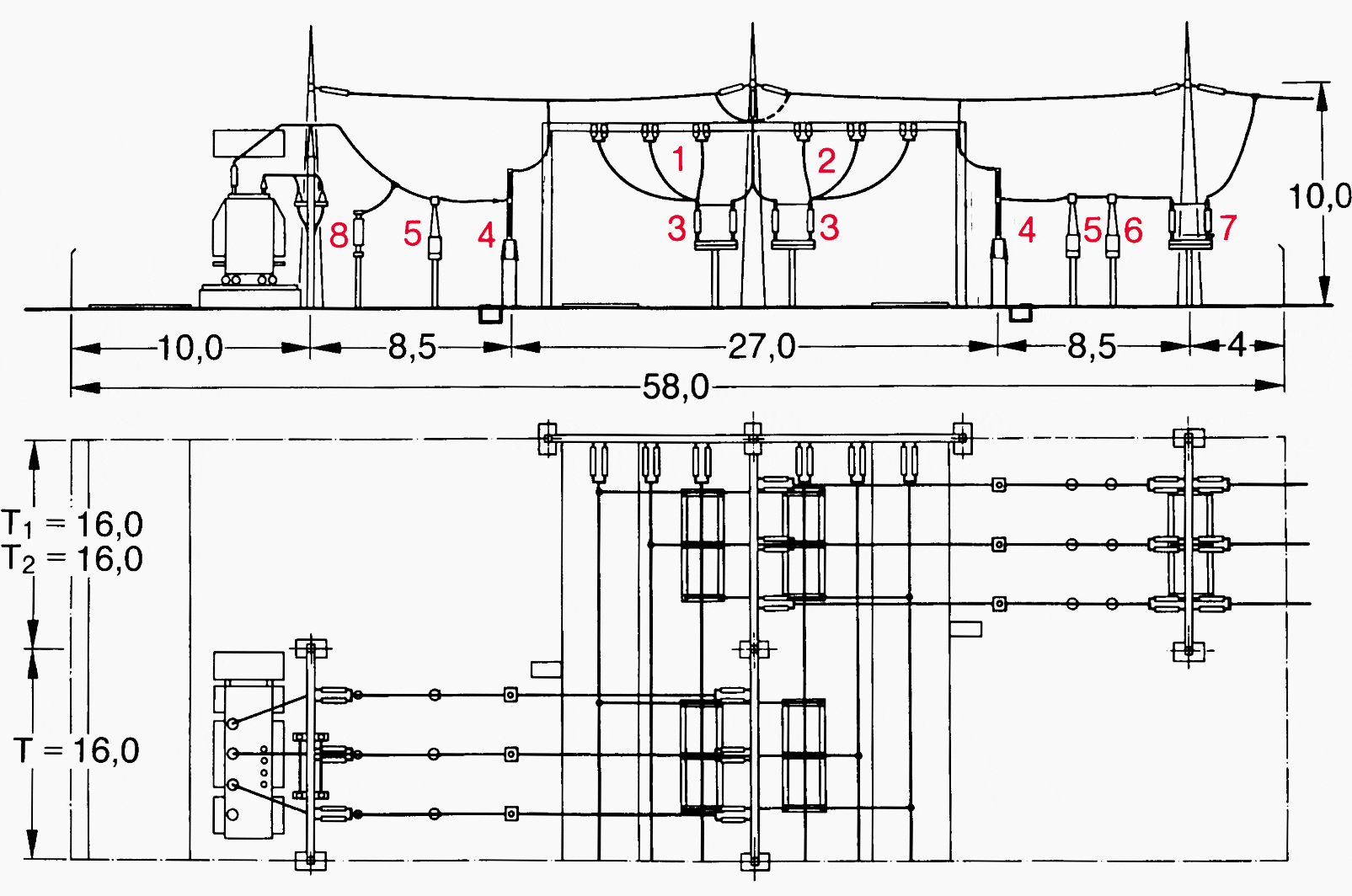

With the low-rise (classical) layout (Figure 2), the busbar disconnectors are arranged side by side in line with the feeder. The busbars are strung above these in a second level, and in a third plane are the branch lines, with connections to the circuit-breaker.
A great advantage of this layout is that the breaker and transformer can be bypassed by reconnecting this line to the feeder disconnector. Features of this configuration are the narrow spacing between bays, but higher costs for portal structures and for means of tensioning the wires.
The classical layout is also used for stations employing the 2-breaker method.
245 kV outdoor switchyard with double busbars, low-rise (classical) layout
Figure 2 – 245 kV outdoor switchyard with double busbars, low-rise (classical) layout
Where:
  1. Busbar system I
  2. Busbar system II
  3. Busbar disconnector
  4. Circuit-breaker
  5. Current transformer
  6. Voltage transformer
  7. Feeder disconnector
  8. Surge arrester
  9. T Bay width
  10. T1 Width initial bay
  11. T2 Width final bay at busbar dead-end

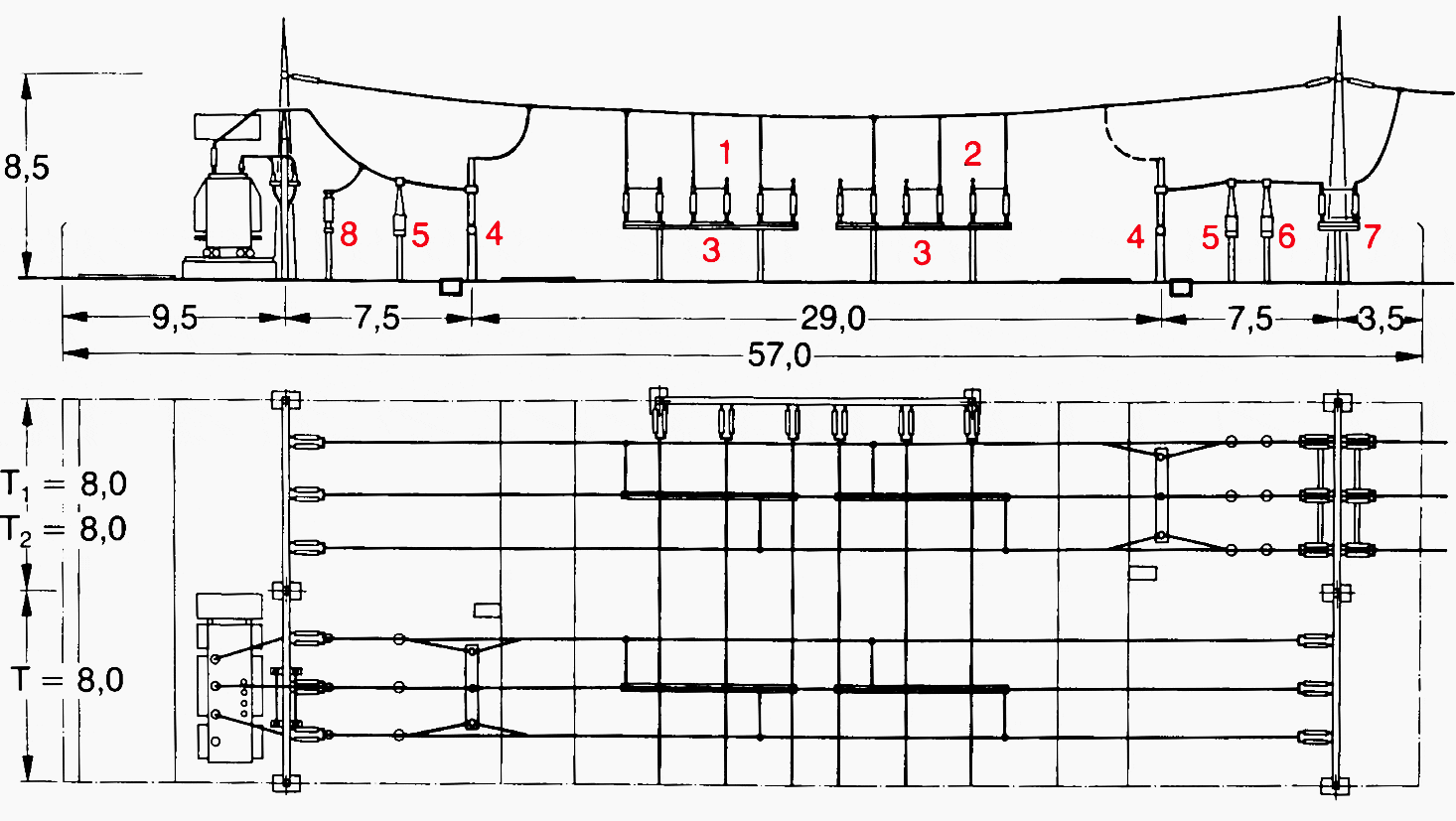

2.2. In-line layout
An in-line layout with tubular busbars is shown in Figure 3. It is employed with busbar current ratings of more than 3000 A. The poles of the busbar disconnectors stand in line with the busbars. Portals are needed only for the outgoing overhead lines.
This arrangement incurs the lower costs for supporting steelwork and results in an extremely clear station layout.
In stations including a bypass bus, the layout chosen for the bypass bus and its disconnectors is the same as for the busbars. In stations with feeders going out on both sides, the bypass bus must be U-shaped so that all branches can be connected to it.
123 kV outdoor switchyard with double busbars, in-line layout
Figure 3 – 123 kV outdoor switchyard with double busbars, in-line layout. The busbars are tubular.
Where:
  1. Busbar system I
  2. Busbar system ll
  4. Circuit-breaker
  8. Surge arrester
  9. T Bay width,

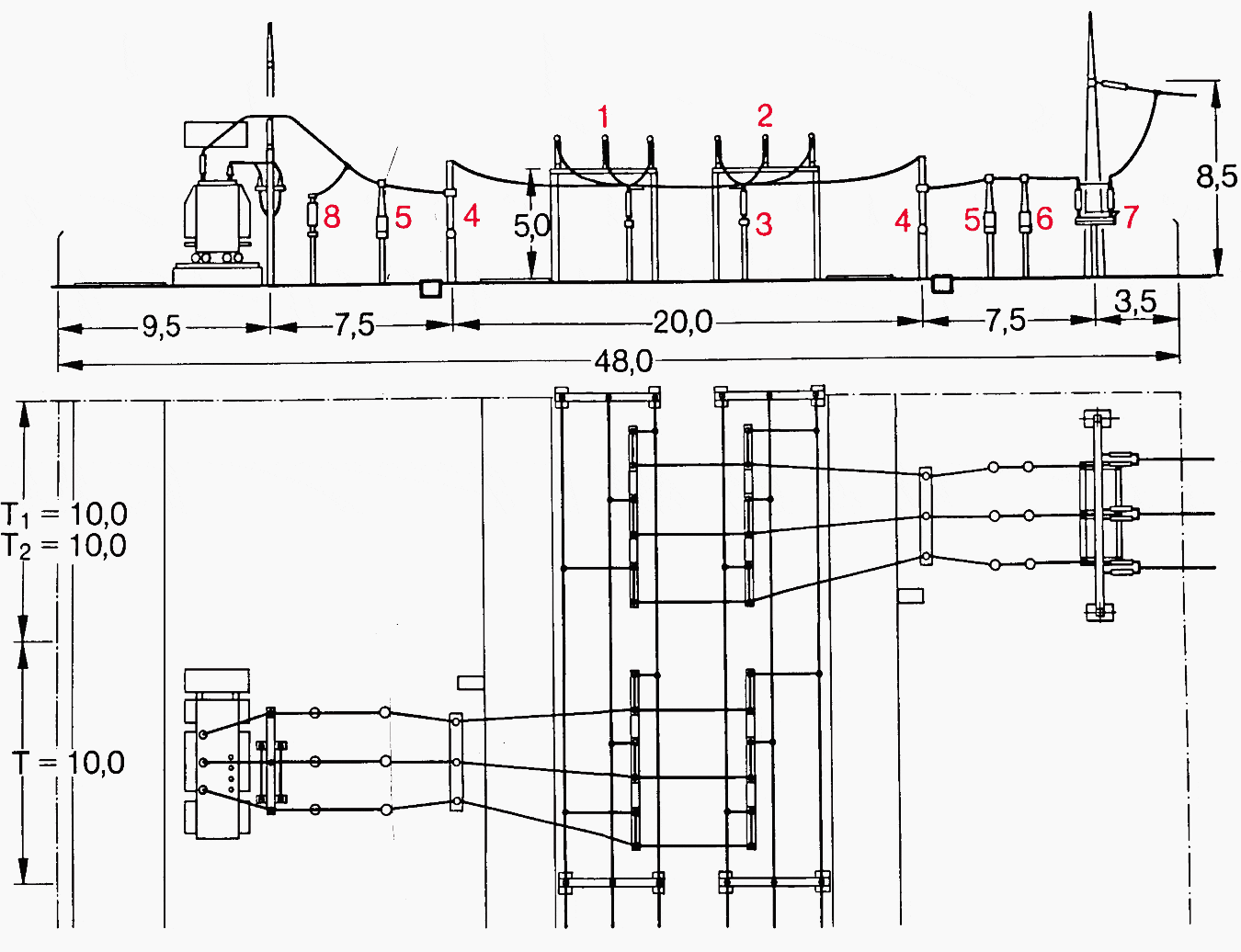

2.3. Transverse layout
With the transverse layout, the poles of the busbar disconnectors are in a row at right angles to the busbar, see Figure 4. With this arrangement too, the busbars can be of wire or tube. The outgoing lines are strung over the top and fixed to strain portals.
Though the bay width is small, this arrangement results in a large depth of installation.
123 kV outdoor switchyard with double busbars, transverse layout
Figure 4 – 123 kV outdoor switchyard with double busbars, transverse layout
Where:
  1. Busbar system I
  2. Busbar system ll
  4. Circuit-breaker
  8. Surge arrester
  9. T Bay width

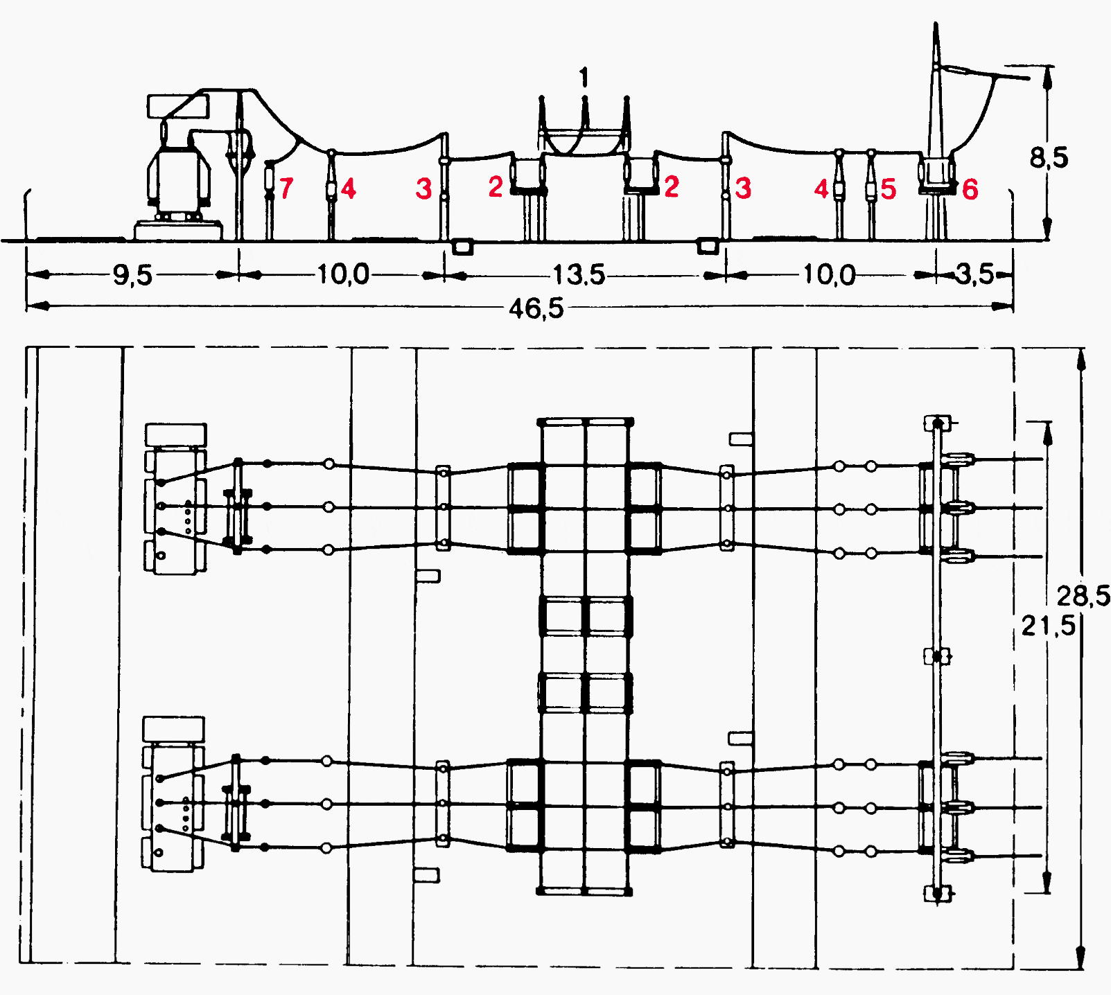

2.4. High-rise layout
Load-centre substations with one or two power transformers are usually in the form of simplified transformer stations. In Figure 5, two incoming overhead lines connect to two transformers (H-connection).
This gives rise to two busbar sections joined via two sectionalizers (two disconnectors in series).
In this way, each part of the installation can be isolated for maintenance purposes. The bus sections can be operated separately or crosswise, ensuring great reliability and security of supply.
123 kV load-centre station (H-connection)
Figure 5 – 123 kV load-centre station (H-connection)
Where:
  1. Busbars
  2. Busbar disconnector
  3. Circuitbreaker
  4. Current transformer
  5. Voltage transformer
  6. Feeder disconnector
  7. Surge arrester

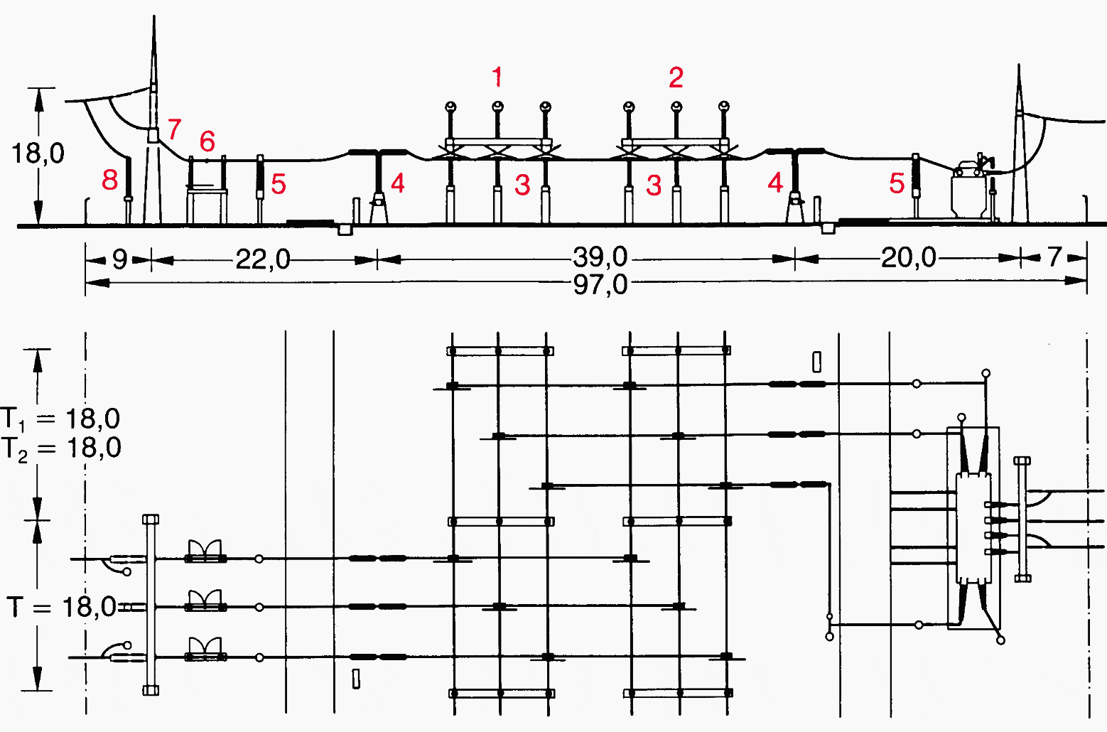

The advantage of this layout (Figure 6) is that when a feeder is disconnected, the busbar disconnectors are also disconnected and are thus accessible.
For installations with current ratings of more than 3000 A and high short-circuit stresses, the busbars and jumper connections are made of tubes.
Figure 6 shows a 420 kV station in a diagonal layout and using tubes. The tubes are in lengths of one bay and mounted on the post insulators with a fixed point in the middle and sliding supports at either end.
The busbars can be welded together over several bays up to about 120 m.
 420 kV outdoor switchyard with double busbars of tubular type, diagonal layout, busbars above
Figure 6 – 420 kV outdoor switchyard with double busbars of tubular type, diagonal layout, busbars above
Where:
  1. Busbar system I
  2. Busbar system II
  4. Circuit-breaker
  7. Line trap
  8. Capacitive voltage transformer
  9. T Bay width

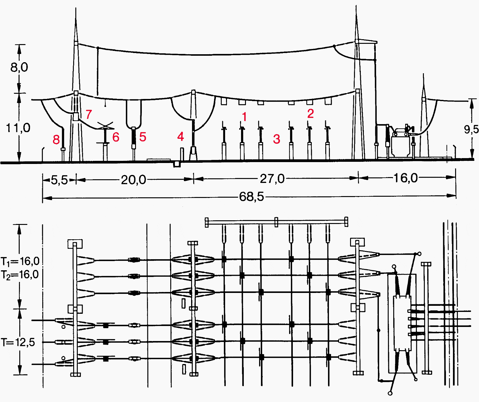

2.5.2. Diagonal “busbars below” layout
With this arrangement, the busbars are mounted on the disconnectors with the outgoing lines strung at right angles to them. At their points of intersection, single-column disconnectors maintain the connection with their vertical isolating distance.
This economical layout requires lightweight busbar strain portals only at the ends of the installation, and the bays are narrow. It can be of single or double-row form. The single-row arrangement (Figure 7) is more space-saving. Compared with a tworow layout it requires about 20 % less area.
The circuit-breakers for all outgoing lines are on the same side of the busbars so that only one path is needed for transport and operation. The lines to the transformers lie in a third plane.
245 kV outdoor switchyard with double busbars, diagonal layout, busbars below, single-row arrangement
Figure 7 – 245 kV outdoor switchyard with double busbars, diagonal layout, busbars below, single-row arrangement
Where:
  1. Busbar system I
  2. Busbar system II
  4. Circuit-breaker
  7. Line trap
  9. T Bay width
  11. T2 Width final bay with busbar dead-end

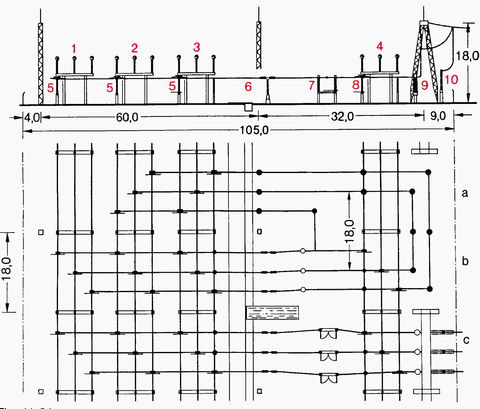

2.5.3. Diagonal layout with bypass bus, single-row arrangement
The 420 kV switchyards of the German transmission grid are of the diagonal type. To meet the stringent demands of station operation and reliability, double or triple busbars with sectionalizing and an additional bypass bus are customary.
Tube-type busbars are preferred. These can handle high current ratings and high short-circuit stresses.
The space-saving single-row layout with the circuit-breakers of all outgoing lines in one row is very effective here, too. Using two-column isolators on the feeders simplifies the layout.
Single-column isolators are used for the busbars and the bypass bus (see Figure 8).
420 kV outdoor switchyard with tubular conductors, triple busbars and bypass bus, diagonal layout, single-row arrangement
Figure 8 – 420 kV outdoor switchyard with tubular conductors, triple busbars and bypass bus, diagonal layout, single-row arrangement
Where:
  1. Busbar system I
  2. Busbar system II
  3. Busbar system III
  4. Bypass bus
  5. Busbar disconnector
  6. Circuit-breaker
  8. Bypass disconnector
  9. Current transformer
  10. Voltage transformer
  11. a and b Ties for busbars 1, 2 and 3 and bypass bus 4
  12. c Outgoing line

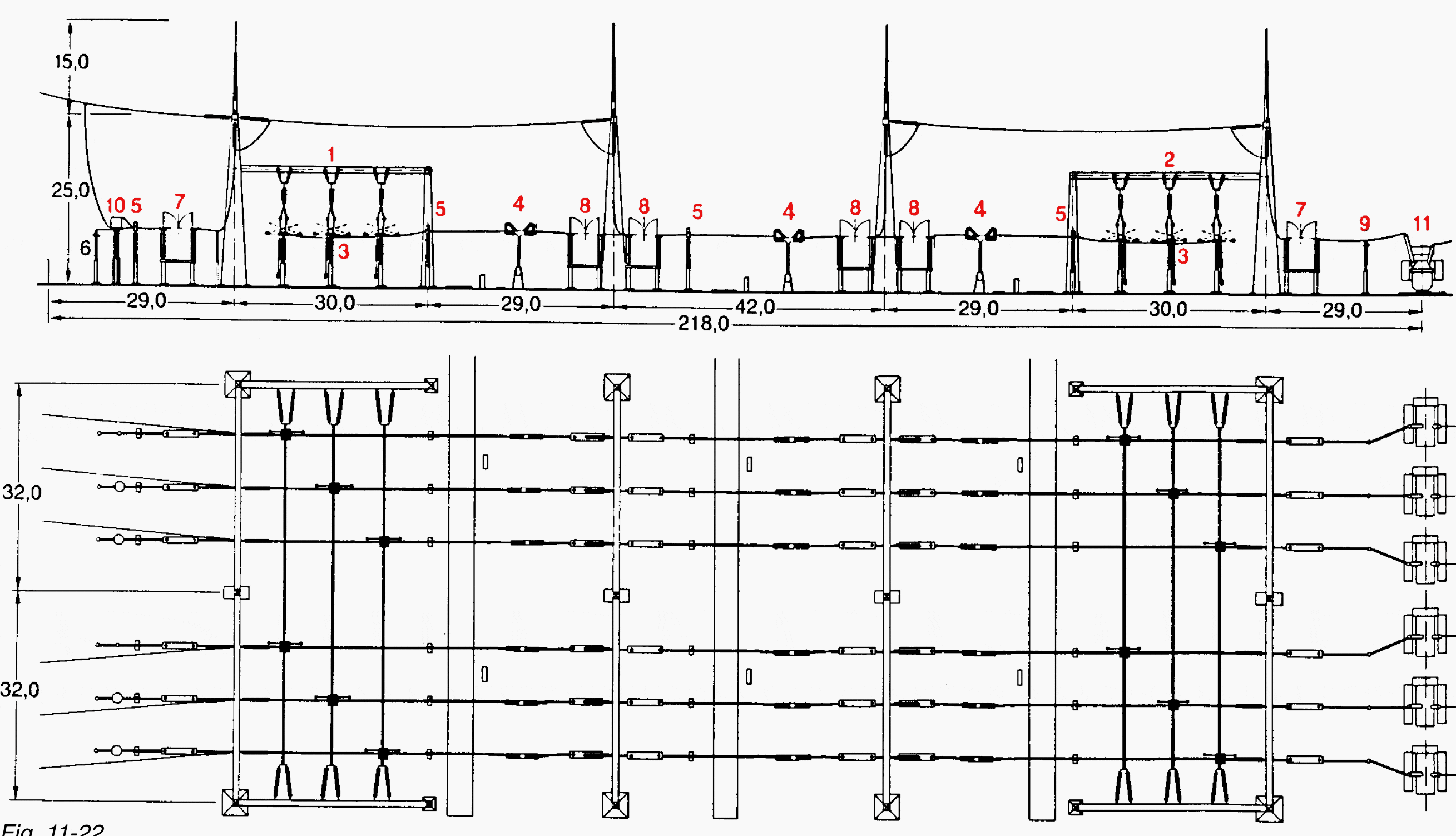

2.6. 1½-breaker layout
The 1½-breaker configuration is used mainly in countries outside Europe. It is employed for all voltages above 110 kV, but predominantly in the very high voltage
range.
The double busbars of these stations are arranged above, both outside or inside, and can be of tube or wire. The more economical solution of stranded conductors is often used for the links to the apparatus, because with the relatively short distances between supports, even the highest short-circuit currents can exert only limited stresses on the equipment terminals.
The branches are always arranged in two rows. The disconnectors used are of the pantograph and two-column vertical-break types. Vertical-break disconnectors are employed in the outgoing line.
Figure 9 shows a section through one bay of a 525 kV station, the busbars are of wire.
This arrangement allows the station to be operated on the ring bus principle while construction is still in progress, and before all the switchgear apparatus has been installed.
525 kV outdoor switchyard, 1½-breaker layout
Figure 9 – 525 kV outdoor switchyard, 1½-breaker layout
Where:
    1. Busbar system I
    2. Busbar system II
    4. Circuit-breaker
    8. Branch disconnector
    9. Surge arrester
    10. Line trap
    11. Transformer
