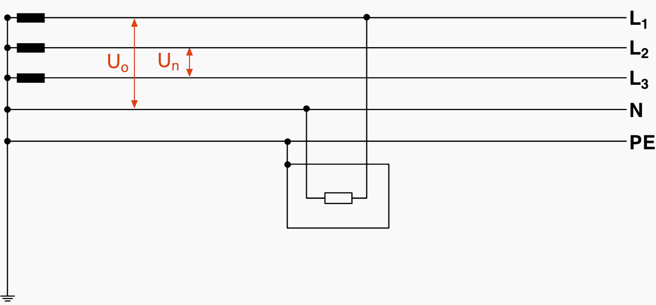

The neutral conductor functions are:
Function #1
Making available a voltage U0 that is different from the phase-to-phase voltage Un (see Figure 1).
Figure 1 – Making available a voltage U0 that is different from the phase-to-phase voltage U

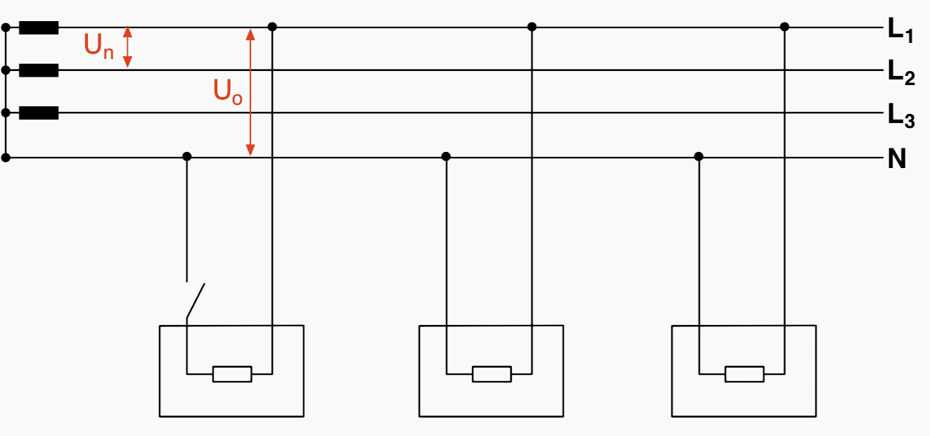

Function #2
Making the single phase loads functionally independent one from the other (Figure 2). With the neutral distributed the single-phase loads are always supplied by the voltage U0.
Figure 2a – With the neutral distributed the single-phase loads are always supplied by the voltage U0

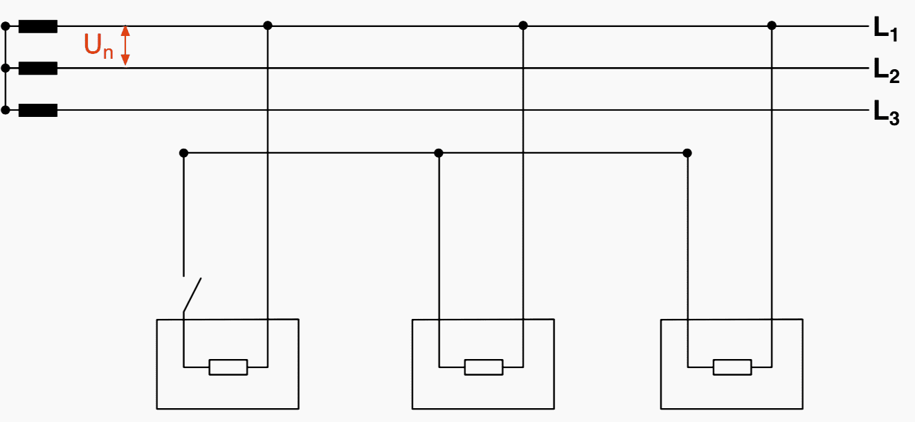

In absence of the neutral, the disconnection of a load could make the other loads operate at a voltage equal to Un/2.
Figure 2b – In absence of the neutral, the disconnection of a load could make the other loads operate at a voltage equal to Un/2.

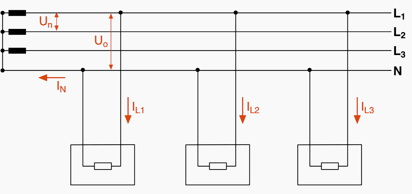

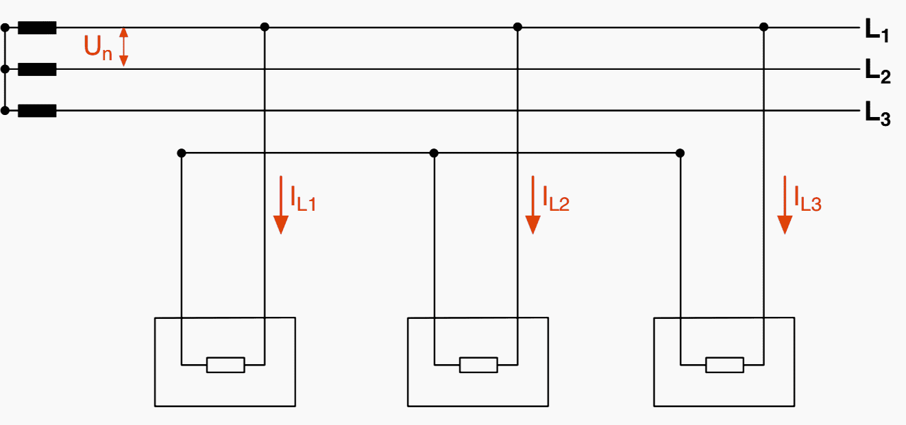

Function #3
Without the neutral, the sum of the currents must be zero, which results in a strong dissymmetry of the phase voltages.
Figure 3a – Without the neutral, the sum of the currents must be zero, which results in a strong dissymmetry of the phase voltages
The presence of the neutral binds the real star point to the ideal one.
Figure 3b – The presence of the neutral binds the real star point to the ideal one

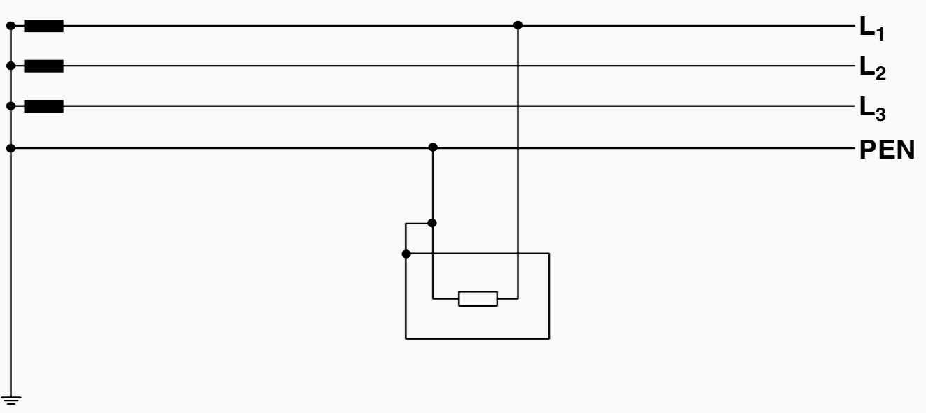

Accomplishing also the function of protective conductor (PEN), under specific conditions (Figure 4). In TN-C system, the neutral conductor is also the protective conductor.
The function of protective conductor (PEN), under specific conditions
Figure 4 – The function of protective conductor (PEN), under specific conditions

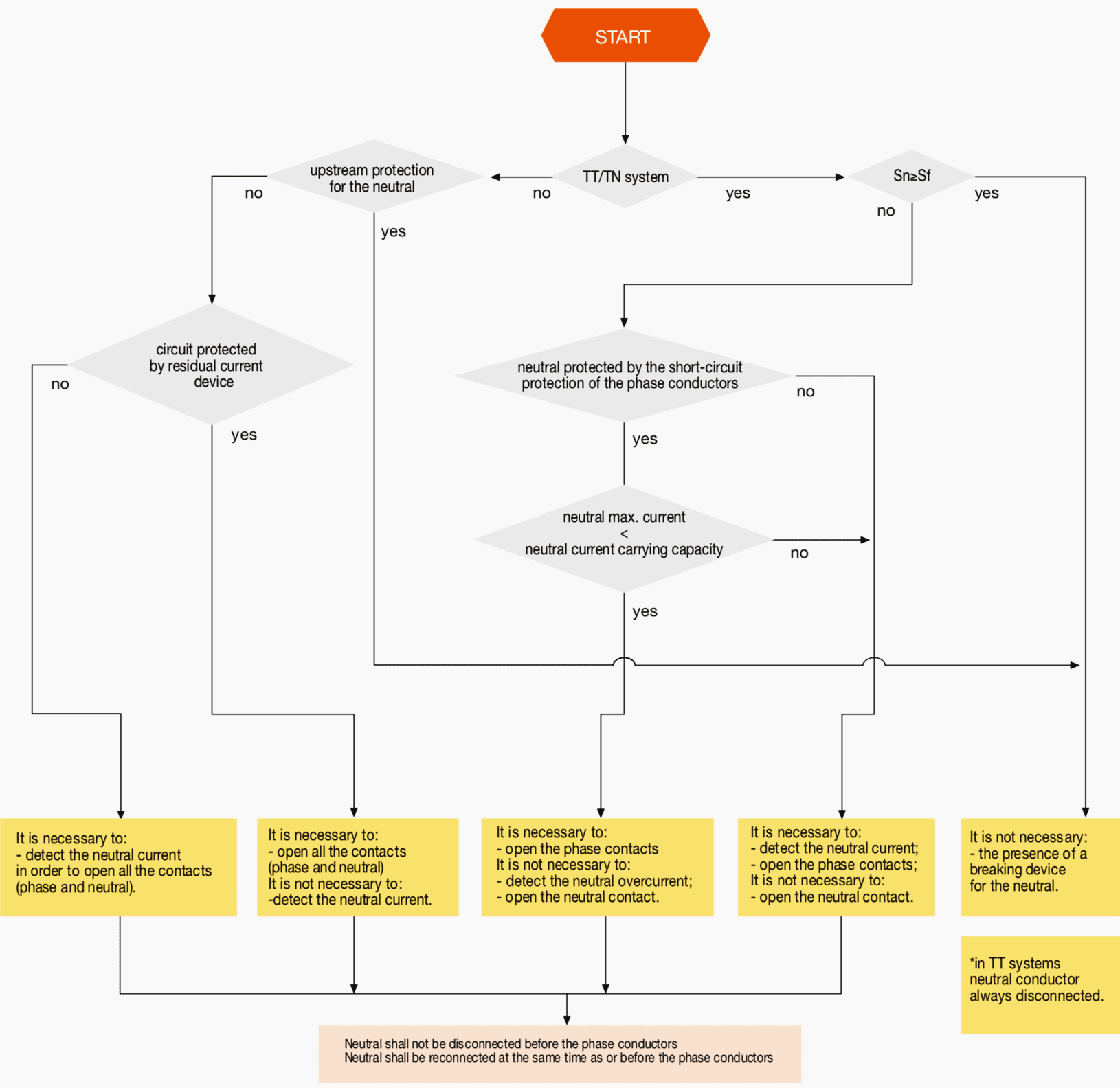

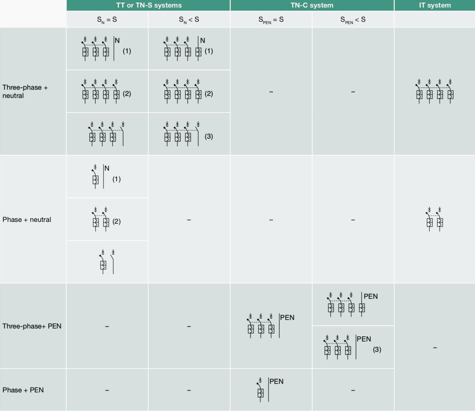

Protection and disconnection of the neutral conductor
Under abnormal conditions, the neutral conductor may have a voltage to earth which, for example, may be due to a disconnection caused by an accidental rupture or by the intervention of the single-pole devices (fuses or single-pole circuit-breakers).
Attention must be paid to the fact that these anomalies can have heavy consequences if the neutral conductor is used also as protective conductor like in TN-C systems.
NOTE: As regards these distribution systems the Standards prohibit the use of any device (single-pole as well as multi-pole ones) which could disconnect the PEN conductor and prescribe the minimum cross-sectional areas (see the following paragraph) necessary to consider negligible the possibility of rupture due to accidental causes.
As just seen, in a four-pole circuit, the disconnection of the neutral conductor only may alter the supply voltage of the single-phase apparatus which are supplied by a voltage different from the phase voltage.
Therefore, protection of the neutral conductor must not be provided by single-pole devices. Protection and disconnection of the neutral conductor are different according to the nature of the distribution systems: TT or TN systems and IT systems.
Tips for TT or TN systems
Tip #1 – Where the cross-sectional area of the neutral conductor is at least equal to or greater than that of the phase conductors, it is not necessary to provide overcurrent detection for the neutral conductor or a disconnecting device for that conductor (neutral not protected and not disconnected).
TT systems always require that the neutral conductor is disconnected, TN-S systems don’t require the neutral conductor is disconnected for three-phase circuit plus neutral.
Tip #2 – Overcurrent detection does not need to be provided for the neutral conductor if the two following conditions are simultaneously fulfilled:
  • The neutral conductor is protected against short-circuit by the protective device for the phase conductors of the circuit, and
  • The maximum current likely to be carried by the neutral conductor is, in normal service, clearly lower than the value of the current-carrying capacity of that conductor;
Tip #3 – Where the cross-sectional area of the neutral conductor is less than that of the phase conductor, it is necessary to provide overcurrent detection for the neutral conductor, so that the disconnection of the phase conductors, but not necessarily of the neutral conductor, is caused (neutral protected but not disconnected).
In TN-C systems, the neutral conductor serves also as protective conductor and therefore it cannot be disconnected. Besides, in case of disconnection of the neutral conductor, during an earth fault the exposed-conductive-parts would take the rated voltage to earth of the system.
Tips for IT systems
Tip #1 – Where the neutral conductor is distributed, it is generally necessary to provide overcurrent detection for the neutral conductor of every circuit, which will cause the disconnection of all the live conductors of the corresponding circuit, including the neutral conductor.
Overload detection on the neutral conductor is not necessary if:
  1. The neutral conductor is effectively protected against the short-circuits by a protective device placed on the supply side (i.e. located at the origin of the installation).
  2. The circuit is protected by a residual current device with a rated residual current not exceeding 0.15 times the current-carrying capacity of the corresponding neutral conductor. This device shall disconnect all the live conductors, including the neutral.
Table 1 summarizes the items above (TT/TN-S, TN-C and IT systems):
Protection and disconnection of the neutral conductor in TT or TN systems and IT systems
Table 1 – Protection and disconnection of the neutral conductor in TT or TN systems and IT systems
Where:
  1. Minimum requirement prescribed by the installation standards for TN-S systems only, whereas TT systems require the neutral conductor always disconnect
  2. Configuration suggested by ABB
  3. Feasible configuration if item b) is verified
Flowchart “protection of the neutral conductor”
Figure 5: Flowchart “protection of the neutral conductor”

    As Kiow & Tiwari point out, in fig.2b, none of the appliances will work at all ! In fig. 2a, it’s not important that all appliances are shown connected to L1, but I don’t think that’s what the author intended. In fig.3a, the appliances don’t work at all, and in fig.3b, if the labels IL1 IL2 & iL3 make sense only if all three lines are connected.

    There are some errors in some of the drawings. The loads should have been connected to the 3-phases and not to 1-phase.
  5. shelesh Tiwari
    Feb 20, 2018
    In Function 2 and 3 explanations,In diagram all the loads are connected to LINE 1.
    Looks like printing mistake.pls confirm.
