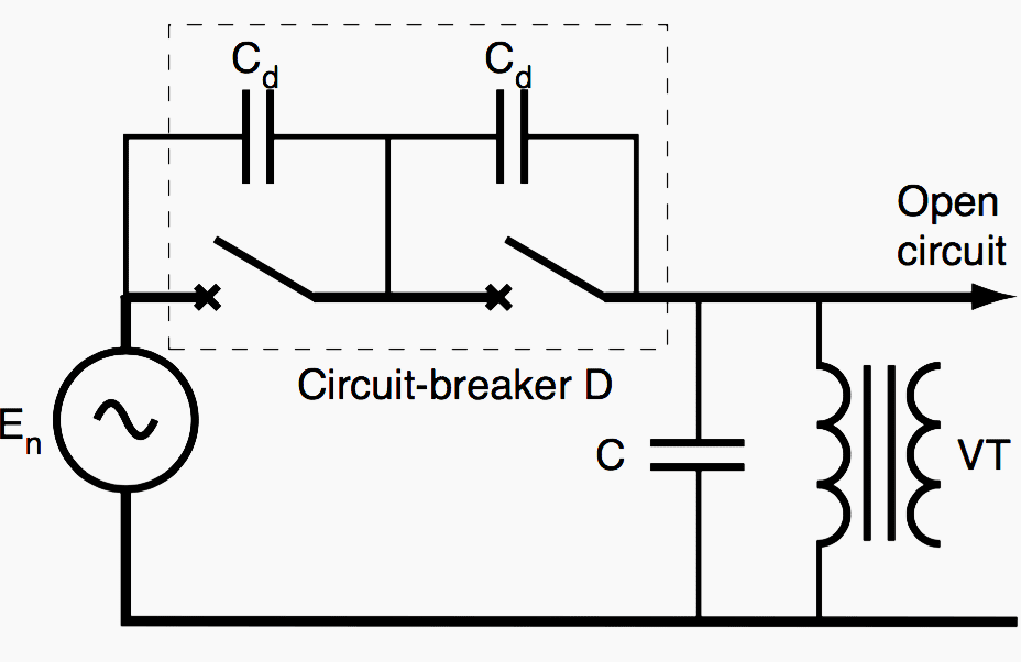

1. Voltage transformer energized through grading capacitance of one (or more) open circuit-breaker(s)
In EHV, certain switching operations (padlocking a bus coupler or switched busbar circuit-breaker, removal of a fault on a busbar section…) can drive voltage transformers (VT) connected between phases and earth into ferroresonance.
These configurations can be illustrated by the circuit in figure 1. Opening of circuit breaker D initiates the phenomenon by causing capacitance C to discharge through the VT which is then driven into saturation. The source delivers enough energy through the circuit breaker grading capacitance Cd to maintain the oscillation.
Ferroresonance of a voltage transformer connected in series with an open circuit breaker
Figure 1 – Ferroresonance of a voltage transformer connected in series with an open circuit breaker
Capacitance C corresponds to all the capacitances to earth of the VT and the connection supplied by means of the grading capacitances of the open circuit-breaker(s).
Ferroresonance is of the subharmonic type.

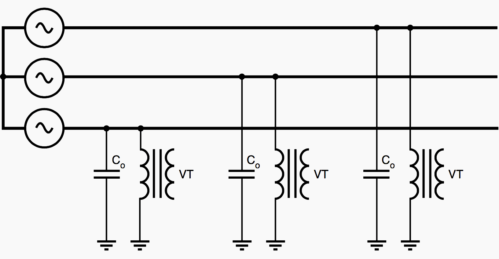

2. Voltage transformers (VT) connected to an isolated neutral system
This earthing system can be chosen, can result from the coupling of an isolated neutral emergency source or from a loss of system earthing. Transient overvoltages or overcurrents due to switching operations on the power system (load rejection, fault-clearing etc.) or to an earth fault, can initiate the phenomenon by driving into saturation the iron core of one or two of the VTs of the parallel ferroresonant circuit in figure 6.
Ferroresonance is then observed both on the phase-to-earth voltages and on the neutral point voltage (VN).
Ferroresonance of a VT between phase and earth in an isolated neutral system
Figure 2 – Ferroresonance of a VT between phase and earth in an isolated neutral system
The neutral point is displaced and the potential of one or two phases rises with respect to earth, which may give the impression of a single phase-to-earth fault in the system.
Overvoltage values may exceed normal phase- to-phase voltage under steady state condition, and cause dielectric destruction of the electrical equipment.
Depending on the relative values of the magnetizing inductance of the VT and the capacitance C0, ferroresonance is fundamental, subharmonic or quasi-periodic.

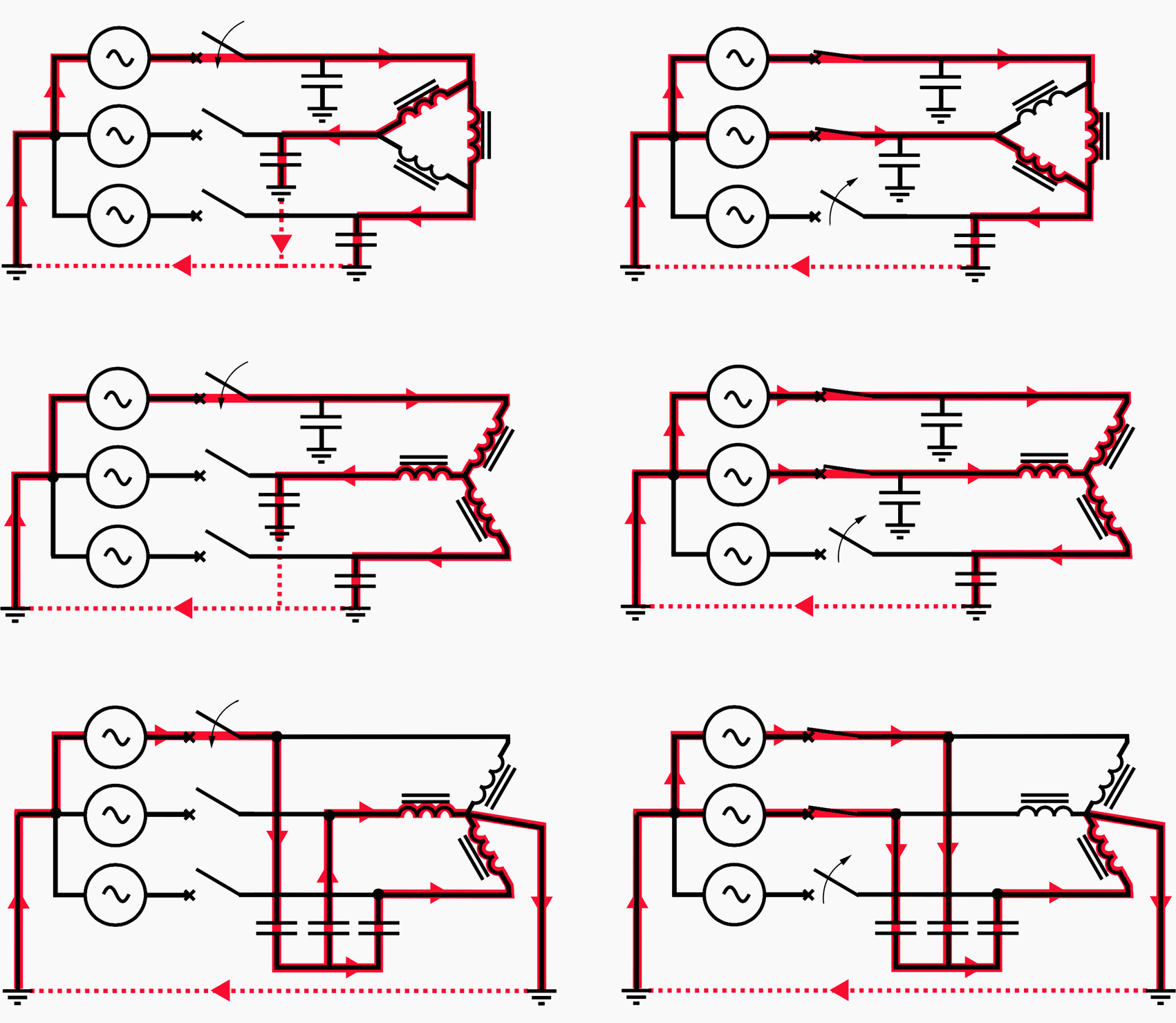

3. Transformer accidentally energized in only one or two phases
A few examples of configurations at risk are given in figure 3 below. These configurations can occur when one or two of the source phases are lost while the transformer is unloaded or lightly loaded, as a result of a fuse blowing on an MV power system, of conductor rupture or of live works.
For example when commissioning a remote controlled breaking cubicle.
Examples of unbalanced systems at risk from ferroresonance
Figure 3 – Examples of unbalanced systems at risk from ferroresonance
The capacitances can be in the form of capacitance of underground cable or an overhead line supplying a transformer whose primary windings are wye connected with isolated or earthed neutral, or delta connected.
For example the series ferroresonant circuit is made up of the connection in series of the phase to earth capacitance (between circuit breaker and transformer) of the open phase and the magnetizing impedance of the transformer. The modes are fundamental, subharmonic or chaotic.
The phase-to-phase and phase-to-earth capacitances, the primary and secondary windings connections, the core configuration (three single-phase, free flux or forced flux), the voltage source system neutral earthing (solidly earthed, earthed, isolated) and the supply mode (one or two phases energized) are all factors involved in the establishment of a given state. Isolated primary neutral is more susceptible to ferroresonance.
To avoid such risks, use of multi-pole breaking switchgear is recommended.

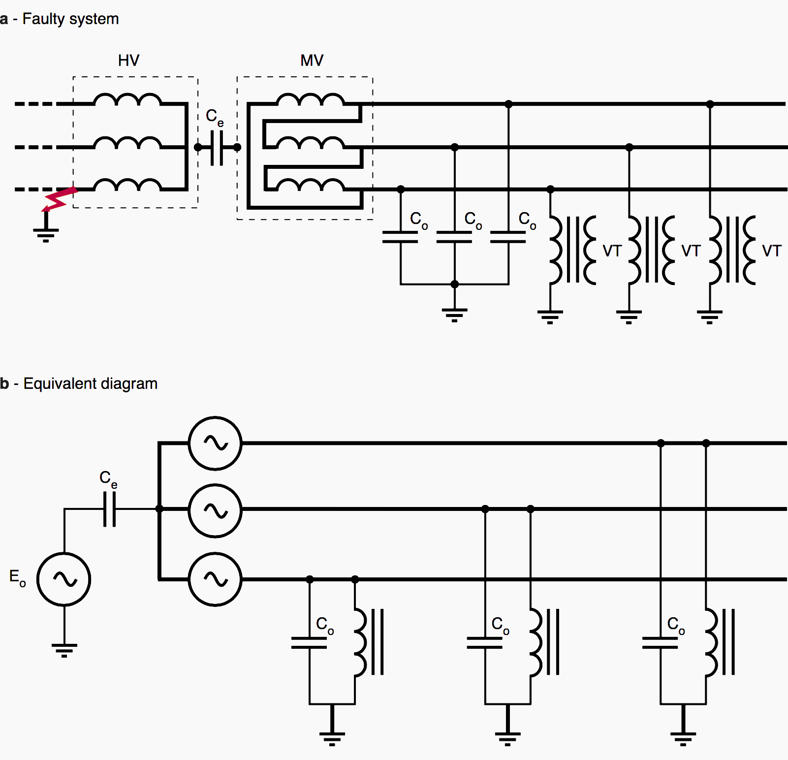

4. Voltage transformers and HV/MV transformers with isolated neutral
Ferroresonance may occur when the HV and MV neutrals are isolated, and unloaded VTs are connected on the MV side between phase and earth (see fig. 4a).
When an earth fault occurs on the HV side upstream from the substation transformer, the HV neutral rises to a high potential. By capacitive effect between the primary and secondary, overvoltages appear on the MV side, and may trigger ferroresonance of the circuit made up of the voltage source E0, the capacitances Ce and C0 and the magnetizing inductance of a VT (see fig. 4b ).
Ferroresonance of a VT between phase and earth with an isolated neutrals source transformer
Figure 4 – Ferroresonance of a VT between phase and earth with an isolated neutrals source transformer
Where:
  • E0 – zero-sequence voltage on the HV side
  • Ce – capacitance between HV and MV winding
  • C0 – zero-sequence capacitance of the MV power system
Once the HV fault has been removed, the voltage of the HV neutral due to a natural unbalance of the system, may be enough to sustain the phenomenon. Ferroresonance is fundamental.

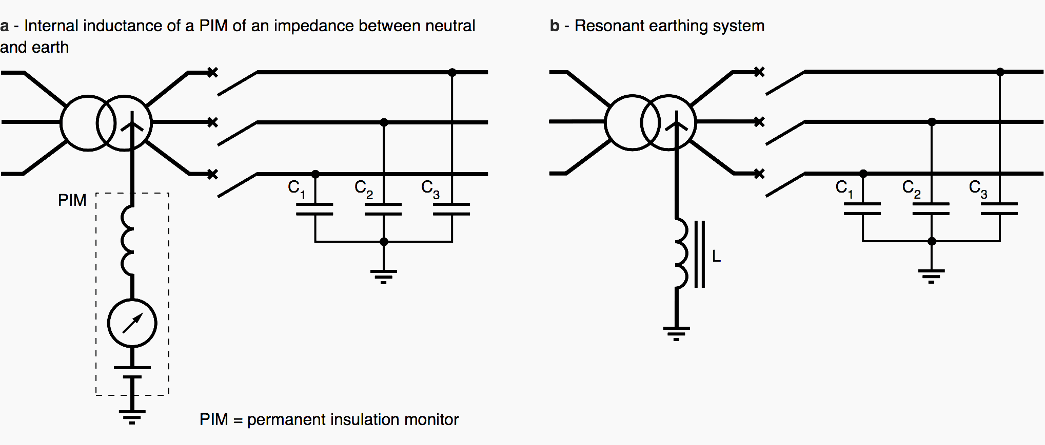

5. Power system earthed through a reactor
The two configurations in figure 5 are susceptible to ferroresonance between an inductance connected between neutral and earth, and the capacitances to earth of the network.

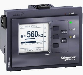

As regards LV power systems with isolated neutral, standards recommend (IEC 364) or stipulate (NF C 15-100) implementation of a Permanent Insulation Monitor (PIM).
Permanent Insulation Monitor Vigilohm, by Schneider Electric
Some PIMs measure insulation impedance of a power system by injecting direct current between the system and the earth. Their impedance is mainly inductive (low impedance for the direct current, and high impedance at power frequency).
They can be a factor contributing to ferroresonance.
Ferroresonance in the case of a system earthed through a reactor
Figure 5 – Ferroresonance in the case of a system earthed through a reactor
Overvoltages may cause sufficient potential rise of the neutral point to initiate ferroresonance between the inductance of the PIM and the capacitances to earth of the network
(see fig. 5a ).
In MV, in order to limit earth-fault currents and help the fault to self-extinghish, a coil of inductance L (such that 3×L×C0×ω02 = 1 where C0 is the zero-sequence capacitance of the MV power system and ω0 the power pulsation) is connected between the MV neutral of an HV/MV transformer and earth (Petersen coil).
Excitation and start of resonance of the circuit consisting of series connection of inductance L and capacitance 3×C0 may occur in the following cases:
  1. HV neutral of the HV/MV transformer earthed, and HV fault flowing through the earth conductor of the substation,
  2. Iron core saturation of the HV/MV transformer,
  3. Transformer design dissymmetry,
  4. Natural dissymmetry of the capacitances (C1, C2, C3 in figure 5b ) to earth.
This may result in saturation of the iron coil, thus initiating or sustaining ferroresonance.

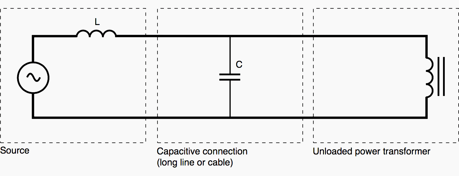

6. Transformer supplied by a highly capacitive power system with low short-circuit power
Ferroresonance may occur when an unloaded power transformer is suddenly connected to a low short-circuit power source compared with transformer rated power through an underground cable or a long overhead line.
This is the case, for example, on return to service in an MV (underground cable) urban or industrial power networks, but also in very extended rural public MV power networks (see figure 6 ) or where underground cables are increasingly used (reliability and aesthetics).
Equivalent diagram of unloaded power transformer supplied by a capacitive system
Figure 6 – Equivalent diagram of unloaded power transformer supplied by a capacitive system
This parallel ferroresonance (capacitance parallel-connected on the transformer’s magnetizing inductance) is normally three- phase, of the fundamental or of the quasi- periodic type.
