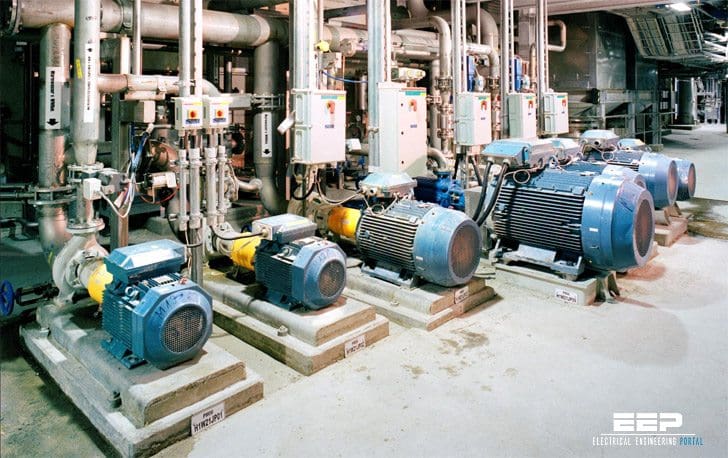

12 Basic Motor Types Used For Industrial Electric Drives
12 Basic Motor Types Used For Industrial Electric Drives (photo from: DOE Navigant Master Presentation)
