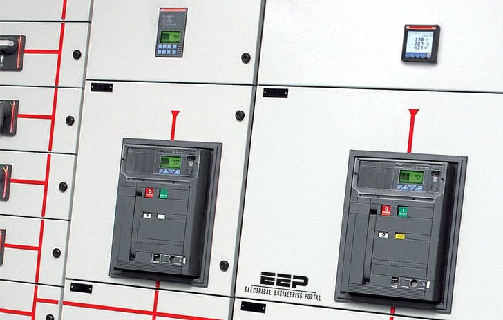

Guidelines To Metering Challenges and How To Overcome Them
Guidelines To Metering Challenges and How To Overcome Them (photo credit: ABB)
