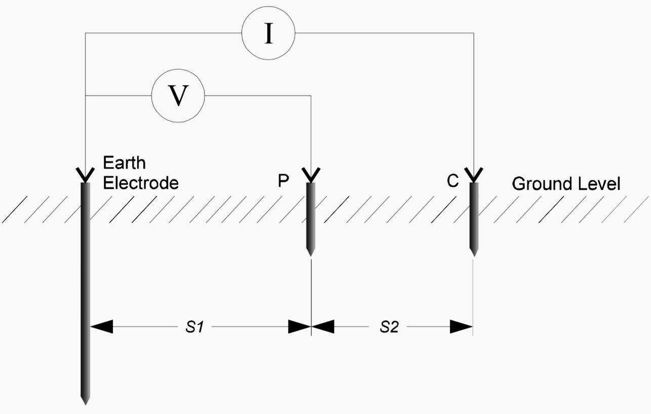

The most commonly used method of measuring the earth resistance of an earth electrode is the 3-point measuring technique shown in Figure 1.
This method is derived from the 4-point method – which is used for soil resistivity measurements.
The 3-point method, called the “fall of potential” method, comprises the Earth Electrode to be measured and two other electrically independent test electrodes, usually labelled P (Potential) and C (Current). These test electrodes can be of lesser “quality” (higher earth resistance) but must be electrically independent of the electrode to be measured.
The 3-point Method of Earth Resistance Measurement
Figure 1 – The 3-point Method of Earth Resistance Measurement
An alternating current (I) is passed through the outer electrode C and the voltage is measured, by means of an inner electrode P, at some intermediary point between them.
The Earth Resistance is simply calculated using Ohm’s Law: Rg = V/I.

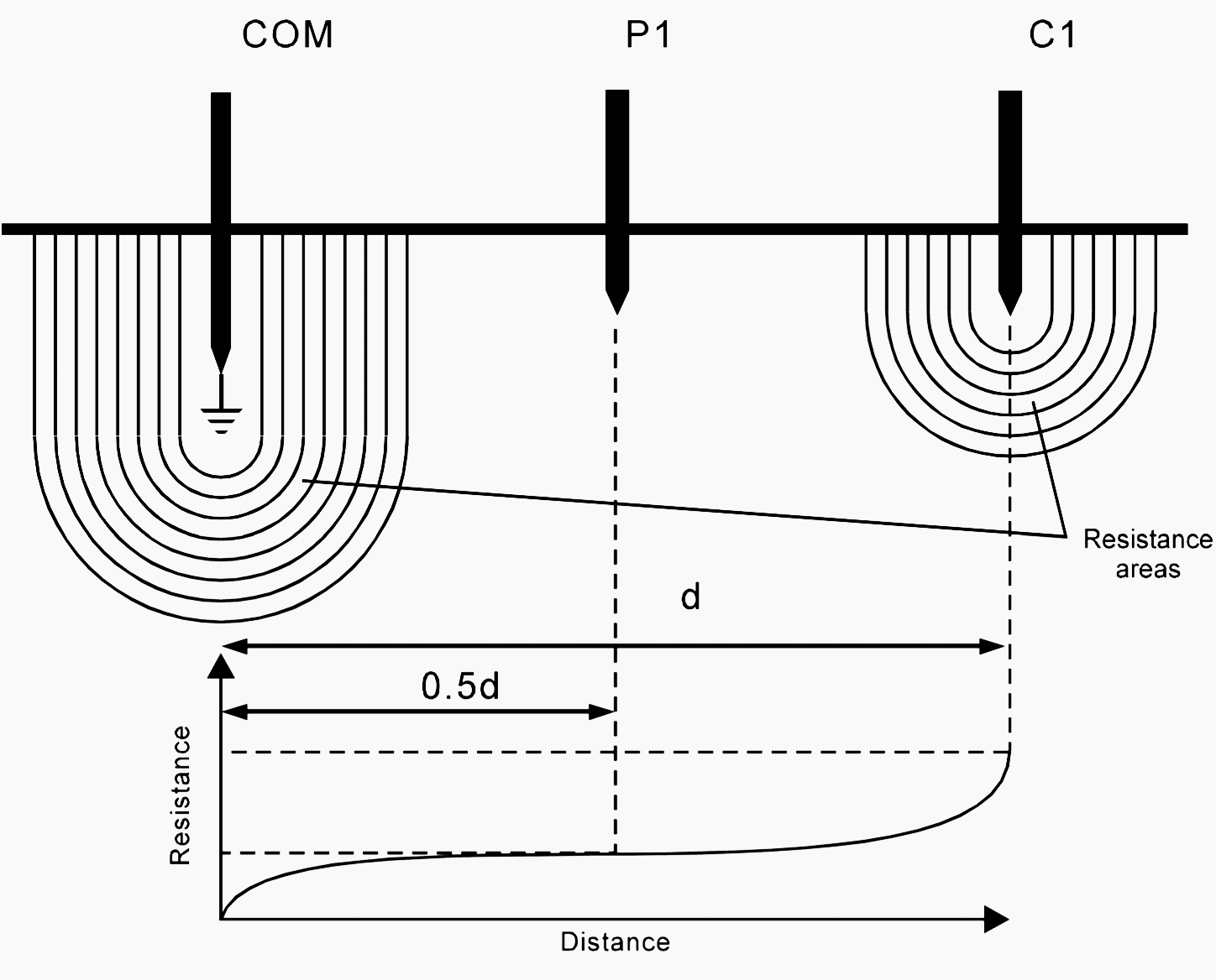

When performing a measurement, the aim is to position the auxiliary test electrode C far enough away from the earth electrode under test so that the auxiliary test electrode P will lie outside the effective resistance areas of both the earth system and the other test electrode (see Figure 2).
Resistance areas and the variation of the measured resistance with voltage electrode position
Figure 2 – Resistance areas and the variation of the measured resistance with voltage electrode position
  • If the current test electrode, C, is too close, the resistance areas will overlap and there will be a steep variation in the measured resistance as the voltage test electrode is moved.
  • If the current test electrode is correctly positioned, there will be a ‘flat’ (or very nearly so) resistance area somewhere in between it and the earth system, and variations in the position of the voltage test electrode should only produce very minor changes in the resistance figure.

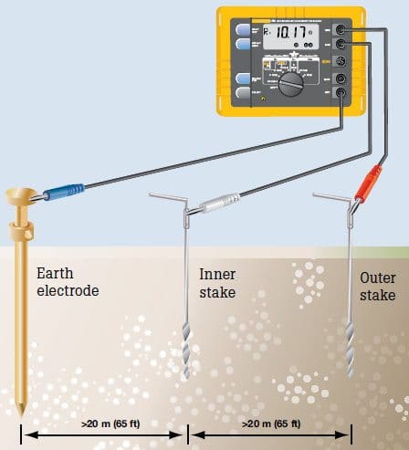

The instrument is connected to the earth system under test via a short length of test cable, and a measurement is taken.
Measurement accuracy can be affected by the proximity of other buried metal objects to the auxiliary test electrodes. Objects such as fences and building structures, buried metal pipes or even other earthing systems can interfere with the measurement and introduce errors.
Often it is difficult to judge, merely from visual inspection of the site, a suitable location for the tests stakes and so it is always advisable to perform more than one measurement to ensure the accuracy of the test.

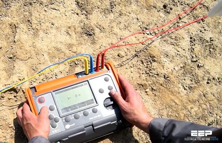

This is one of the most common methods employed for the measurement of earth resistance and is best suited to small systems that don’t cover a wide area. It is simple to carry out and requires a minimal amount of calculation to obtain a result.
Measuring earth resistance with fall of potential method
Measuring earth resistance with fall of potential method (photo credit: eblogbd.com)
This method is generally not suited to large earthing installations, as the stake separations needed to ensure an accurate measurement can be excessive, requiring the use of very long test leads (refer to Table 1).
Normally, the outer test electrode, or current test stake, is driven into the ground 30 to 50 metres away from the earth system, (although this distance will depend on the size of the system being tested – refer to Table 1) and the inner electrode, or voltage test stake, is then driven into the ground mid-way between the earth electrode and the current test stake, and in a direct line between them.

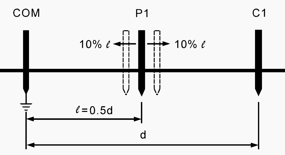

The Fall of Potential method incorporates a check to ensure that the test electrodes are indeed positioned far enough away for a correct reading to be obtained. It is advisable that this check be carried, as it is really the only way of ensuring a correct result.
To perform a check on the resistance figure, two additional measurements should be made:
  1. The first with the voltage test electrode (P) moved 10% of the original voltage electrode-to-earth system separation away from its initial position, and
  2. The second with it moved a distance of 10% closer than its original position, as shown in Figure 3.
Checking the validity of a resistance measurement
Figure 3 – Checking the validity of a resistance measurement
If these two additional measurements are in agreement with the original measurement, within the required level of accuracy, then the test stakes have been correctly positioned and the DC resistance figure can be obtained by averaging the three results.
However, if there is substantial disagreement amongst any of these results, then it is likely that the stakes have been incorrectly positioned, either by being too close to the earth system being tested, too close to one another or too close to other structures that are interfering with the results.
The stakes should be repositioned at a larger separation distance or in a different direction and the three measurements repeated. This process should be repeated until a satisfactory result is achieved.

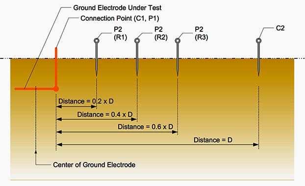

(a) The Slope Method
This method is suitable for use with large earthing systems, such as power substation earths. It involves taking a number of resistance measurements at various earth system to voltage electrode separations and then plotting a curve of the resistance variation between the earth and the current.
Using this method it is possible to calculate the theoretical optimum location for the voltage electrode and thus, from the resistance curve, calculate the true resistance.
The additional measurement and calculation effort tends to relegate this system to use with only very large or complex earthing systems.
