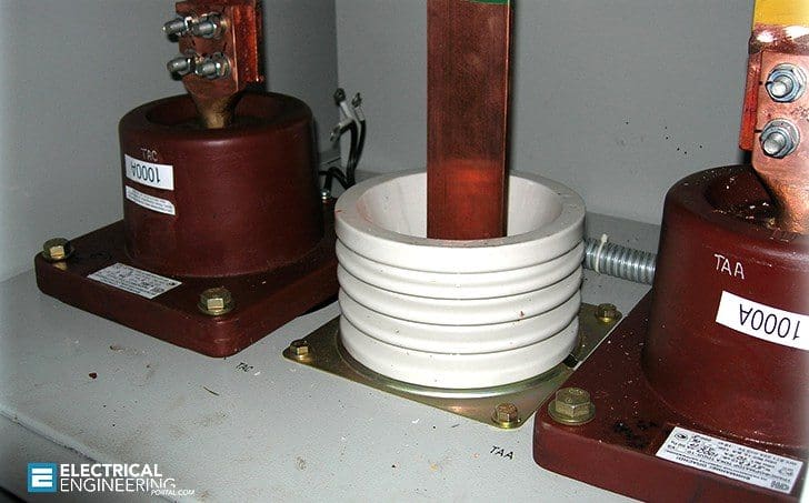

The measurement of the earth fault or residual currents on a distribution system feeder can be done by the so-called summation connection, where the three current transformers, one in every phase, are connected and the summated current is brought to the inputs of an earth fault protection relay.
Measurement of residual currents on a distribution feeder
This is a convenient method for cases where the level of the earth fault current is relatively high, i.e. directly earthed systems.
When the level of the fault current to be measured starts to decline heavily, the measurement sensitivity and accuracy that can be reached with this summation connection is no longer sufficient. The measurement accuracy is affected by the fact that the three different current transformers, even with similar core data, start to introduce different kind of errors when it comes to ratio and phase displacement.
Window-type cable current transformer
Window-type cable current transformer (photo credit: k-electric-gmbh.de)
These errors are summated together in the summation connection, and in the worst case they are cascading on top of each other. The sensitivity is affected by the fact that current transforming ratio of the phase current transformers is mainly selected based on the maximum load currents, whereas the anticipated earth fault currents can be only some fractions of those.
To overcome the accuracy and sensitivity requirements with low (earth fault) residual currents, a cable (or busbar), also called a window-type, current transformer can be utilized. Following figure describes the installation.
