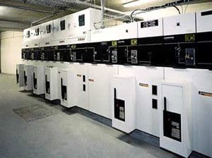

SM6 10kV switchgear with circuit breakers by Schneider Electric
