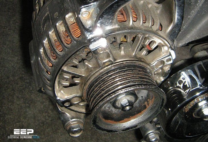

Every car has it - The Lundell generator with claw-pole rotor
Every car has it - The Lundell generator with claw-pole rotor (on photo: Jeep 2.5 liter 4-cylinder engine, chromed - close up of the alternator; credit: wikipedia)
