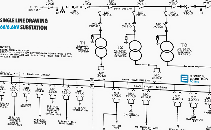

Learn To Interpret Single Line Diagram - SLD (on photo: An example of 66/6.6kV power substation single line diagram)
We use universally accepted electrical symbols to represent the different electrical components and their relationship within a circuit or system. To interpret SLDs you first need to be familiar with the electrical symbols. This chart shows the most frequently used symbols.

Industrial single line diagram
Now, lets go through a industrial single line diagram. When interpreting a single line diagram, you should always start at the top where the highest voltage is and work your way down to the lowest voltage. This helps to keep the voltages and their paths straight.
To explain this easier, we have divided the single line into three sections.
A typical industrial single line diagram
Figure 2 – A typical industrial single line diagram
Area A //
Starting at the top, you will notice that a transformer is feeding power to the whole system. The transformer steps the voltage down from 35kV to 15kV, as indicated by the numbers next to the transformer symbol. Once the voltage has been stepped down, a drawout circuit breaker (a1) is encountered.
Do you recognize the drawout circuit breaker symbol?
You can assume this circuit breaker can handle 15kV, since it is attached to the 15kV side of the transformer, and nothing different is indicated on the single line diagram. Following the drawout circuit breaker (a1) from the transformer, it is attached to a heavier, horizontal line.
This horizontal line represents an electrical bus, which is a means used to get electricity to other areas or circuits.
