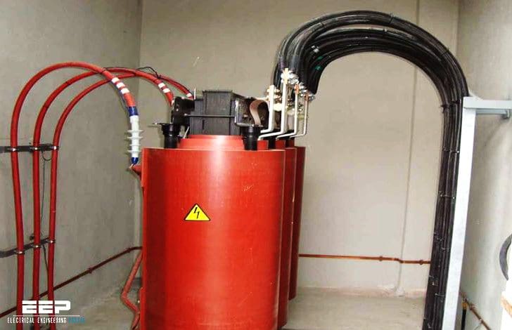

Why and where do internal faults happen in substation transformers (on photo: 630KVA Dry-type 20/0.4kV distribution transformer; credit: vakfaris.eu)

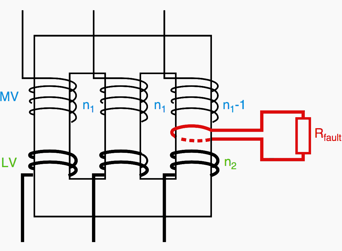

1. Faults between turns
Faults between medium voltage winding turns are the most frequent failure mode as well as being the most difficult to detect.
They result from the localized deterioration of conductor insulation, due to thermal or dielectric stresses. The initial effect is limited to a slight increase in the primary current, due to the modification of the transformation ratio on the one hand and the appearance of a short-circuited turn phenomena on the winding concerned.
This faulty turn behaves as a secondary winding and is the seat of a current limited solely by its own impedance and the resistance at the point of fault (see figure 1).
Functioning of a transformer with a short-circuited turn in the primary
Figure 1 – Functioning of a transformer with a short-circuited turn in the primary
According to the current that passes through this turn, the progression of the fault will be more or less rapid. In the case of high currents, the local temperature rise will lead to the deterioration of the neighboring turns and the fault will quickly spread.
The order of magnitude corresponds to approximately one hundred times the rated current or around 1 kA for the primary winding of a transformer of 400 kVA under 20 kV!
In any case, the presence of local arcing will lead to a gaseous release, whether or not the transformer is of oil filled or dry type. This release can lead to a large increase in pressure, until part of the structure ruptures (tank or solid insulation).
If the fault causes a low primary current, the phenomena can be slow and difficult to detect through monitoring of the supply current. Laboratory tests on oil filled transformers have shown current of between 1 and 6 times the rated current, accompanied by large gaseous release, for faults involving up to 8 % of the primary turns.
This is why monitoring of gaseous emissions or pressure can be used in a complementary manner to protection devices based on current measurement.

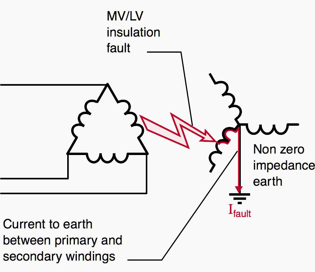

MV/LV
A fault between windings can also lead to a contact between the primary and secondary, with the appearance of a dangerous potential on the low voltage network. The risk to equipment and people depends on the neutral arrangement of the two networks (see figure 2).
Example of a fault between primary and secondary windings
Figure 2 – Example of a fault between primary and secondary windings
In certain applications, for enhanced safety of the lowest voltage winding, the use of a shield connected to earth, positioned between the primary and secondary windings enables this fault hypothesis to be eliminated by favoring phase-earth faults.
In this case, earthing connections of the transformer frame and of the LV neutral are different, thus avoiding increased LV network potential relative to earth.

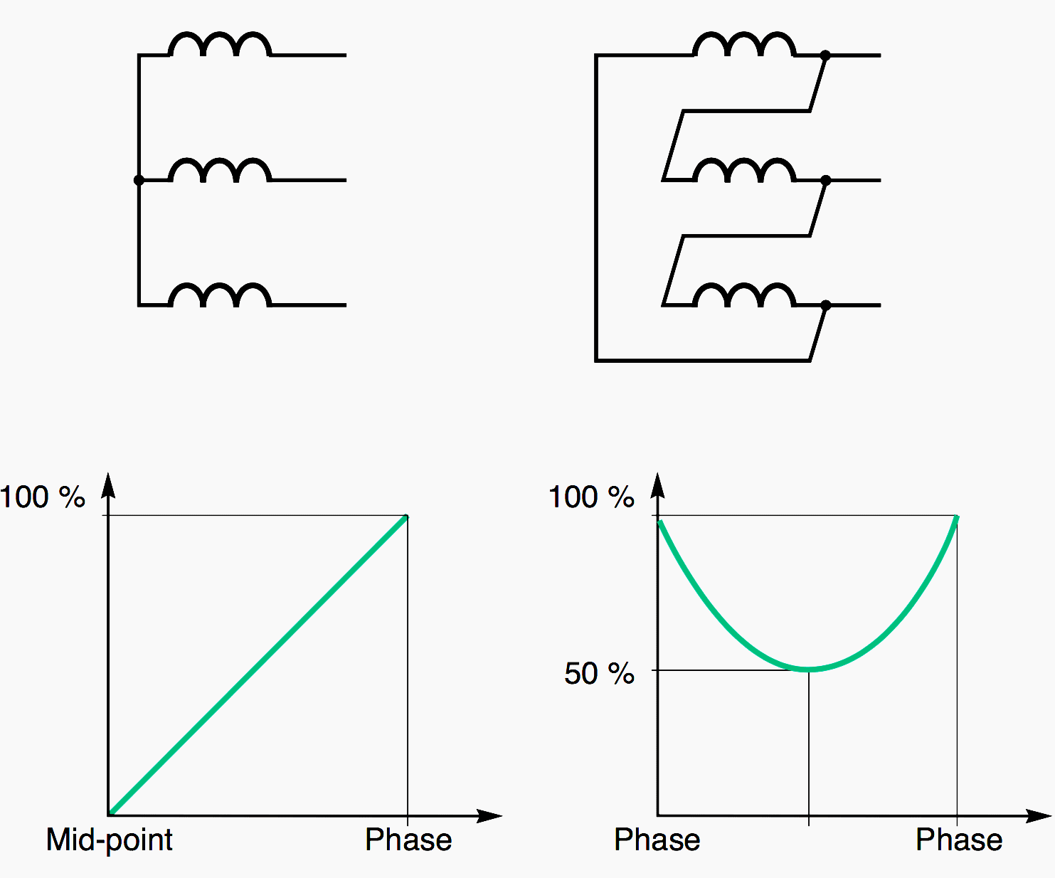

Case of a non-distributed medium voltage neutral
In the case of a non-distributed medium voltage neutral, connected to earth by an impedance of some sort, the fault will cause a current to earth to appear varying as a function of the neutral impedance and the position of the fault on the winding. In the case of a very low fault current, there is a risk of a slow increase in pressure similar to that for faults between the turns.
Arbitrarily fine detection of the current to earth would be an effective means of protection. Nevertheless, such protection is not always technically and/or economically achievable.
Case of a tuned neutral network
In the case of a tuned neutral network (earthed by a Petersen coil), an insulation fault in an oil filled transformer will be of recurring self-extinguishing type. The low value of the fault current enables its spontaneous extinction in the oil and progressive reappearance of the voltage, characteristic of a tuned neutral network, leading to another breakdown several hundreds of milliseconds later.
The frequency of the phenomena will increase if there is progressive deterioration by successive breakdowns leading to a lowering of the dielectric withstand.
Case of a neutral network directly connected to the earth and distributed
In the case of a neutral network directly connected to the earth and distributed (4 wires network, of North American type), the presence of neutral current is normal, due to the existence of single-phase loads, and the appearance of a fault will increase this current (as a function of the impedance of the winding section not in short circuit).
The situation is therefore analogous with the short-circuited autotransformer. The fault current will always be significant and require quick response or otherwise risk resulting in an explosion. It risks, however, not being seen by the network’s protection devices which are set to allow a large neutral current (up to 40 % of the line’s rated current). It is therefore the transformer’s protection which must be able to act.
A significant proportion of faults concern the transformer’s frame, then the ground Protection against earth faults is therefore useful.
The current to earth being zero under normal conditions (except in networks with an earthed and distributed neutral arrangement), such protection can be set with a low threshold, e.g. 10 % of the rated current with a time delay of 100 ms, in cases with current transformers and a few amperes in cases using a residual current sensor.
