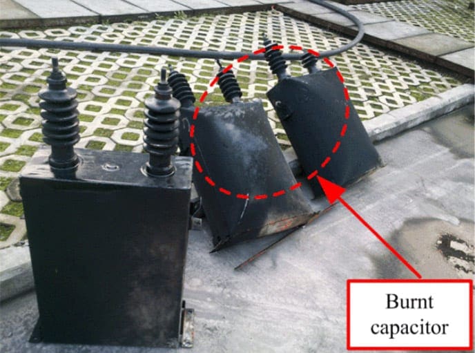

2. Bulged Capacitor Units
One of the failure modes of capacitor units is bulging. Excessively bulged units indicate excessive internal pressure caused by overheating and generation of gases due to probable arcing condition. These units should be handled carefully.
The manufacturer should be consulted regarding the handling of bulged units.

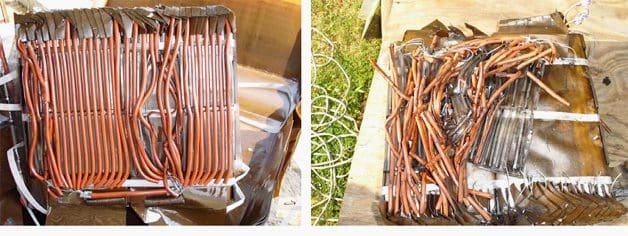

Damaged Internally Fused Capacitor Units

Burnt capacitors
Burnt capacitors (photo credit: Wenxia Sima, Mi Zou 1, Qing Yang, Ming Yang and Licheng Li)

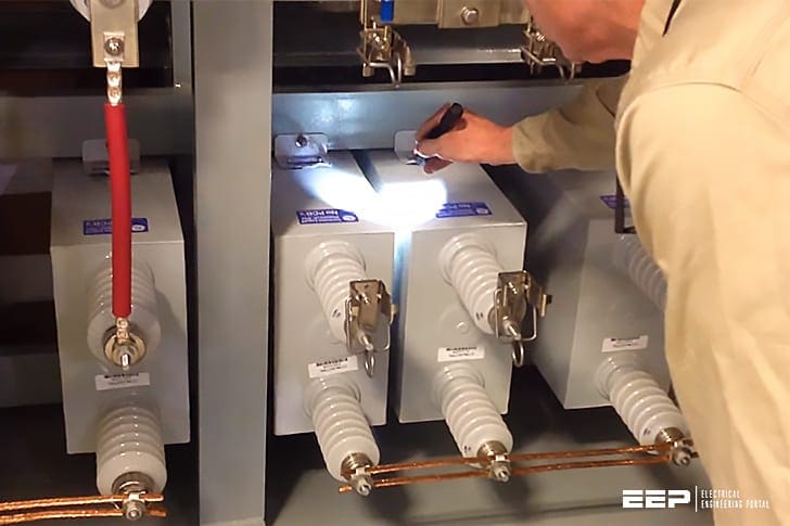

7. Visual Inspections
Visual inspection of the capacitor bank must be conducted for blown capacitor fuses, capacitor unit leaks, bulged cases, discolored cases, and ruptured cases.
During such inspection, check the ground for spilled dielectric fluid, dirty insulating surface on the bushings, signs of overheated electrical joints, open switches, and tripped protective devices.
An infrared camera is very useful for inspecting the substation equipment for overheated joints and surfaces, and records can be maintained for future reference. Pole-mounted capacitor units should be examined for exterior corrosion.
