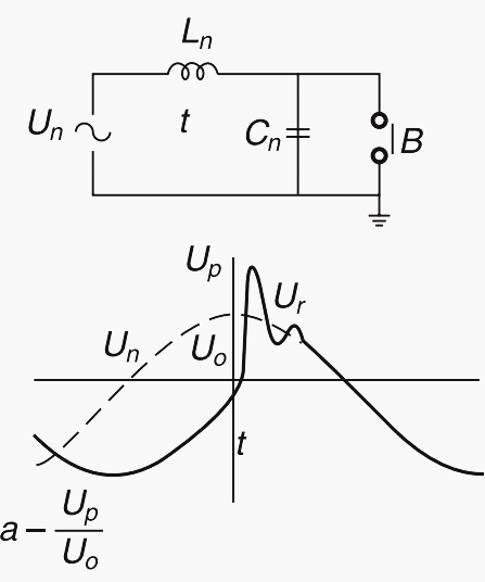

1.1 Transient Recovery Voltage
The transient recovery voltage is the actual voltage appearing across the circuit breaker contacts immediately after the arc interruption.
The voltage will, of course, ultimately approach the open circuit voltage, but will do so in the form of high frequency voltage oscillation governed by the circuit parameters ‘L’ and ‘C’. This Recovery voltage is given by:
e(1 – cos (t/√(L×C)))
The maximum transient recovery voltage is twice e. The resistance present in the circuit damps this transient voltage.
In practice, the transient recovery voltage is not of a single frequency but of several frequencies because of the complicated network configuration.
The Transient recovery voltage after short circuit interruption is shown in Figure 1a.
Transient recovery voltage after short-circuit interruption
Figure 1a – Transient recovery voltage after short-circuit interruption

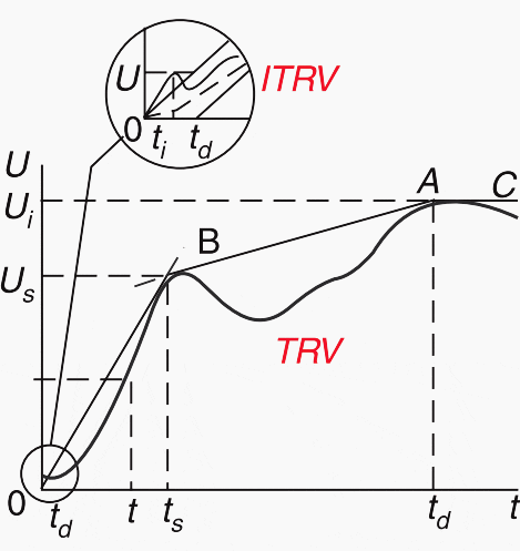

To test the breaker, a six parameter method is applied, as shown in Figure 1b.
Transient recovery voltage represented by six parameters
Figure 1b – Transient recovery voltage represented by six parameters

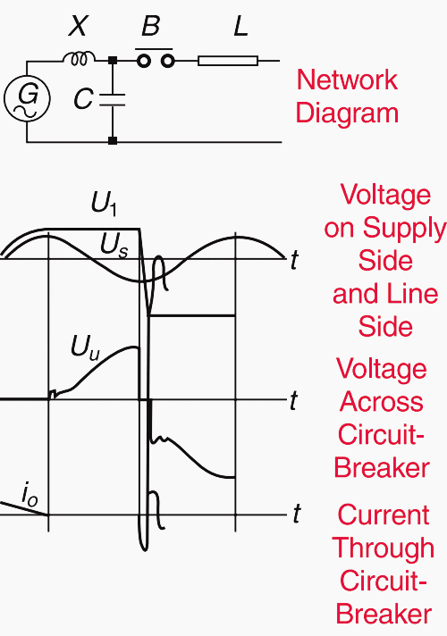

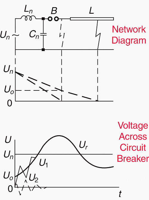

2. Short Line Faults (SLF)
Short-circuit faults occurring on a line length between 0.5 to 5 km are termed as short line faults or kilometric faults. A fault of this type imposes a highly onerous duty on the circuit breaker, thereby affecting its interrupting ability.
The basic phenomenon, is the double frequency being impressed on the circuit breaker and the difference of the source and the line side TRV. Both voltages start from instantaneous values at the position of the circuit breaker prior to the interruption.
On the supply side, the voltage will oscillate at the supply frequency ultimately approaching the open circuit voltage. On the line side of the circuit breaker, the trapped charges, after interruption, initiate travelling waves on the transmission line, and these waves impose a saw tooth waveform at the circuit interruption. Since there is no driving voltage on the driving side, the voltage ultimately becomes zero because of the line losses.
The network diagram, and the line side and supply side voltage wave forms are shown in Figure 2 below.
Short line faults - basic phenomena
Figure 2 – Short line faults – basic phenomena
Even though the magnitude of the voltage oscillation is considerably lower than that of the system voltage, the frequency is very high. This means that the RRRV across the circuit breaker can be much higher than the terminal short-circuit cases. Even though the short-circuit current is quite less, the high RRRV may cause the interrupter to fail.
Thus, for an EHV circuit breaker, which is sensitive to RRRV, there may be a critical line length, which imposes the most severe duty on the breaker.
Very high RRRV of up to 10 kV/micro-second have been encountered during the short-line fault (SLF). Shorter line length gives a higher rate in rise of recovery voltage but the voltage peaks become so low that the circuit breaker clears easily. Longer length gives higher voltage peaks but the RRRV is much lower.
As in the case of the terminal fault, the use of the damper resistors reduces the RRRV. Since the SLF represents a case with very high RRRV, it is quite natural that the air blast circuit breaker will face difficulties with the interruption. Low ohm resistors are thus usually necessary.
SF6 circuit breakers are highly sensitive to the high voltage rates of rise during the first few micro-seconds of the current zero. SF6 gas breakers can easily handle the high RRRV in case of SLF duty, as the dielectric strength of the gas is very high.

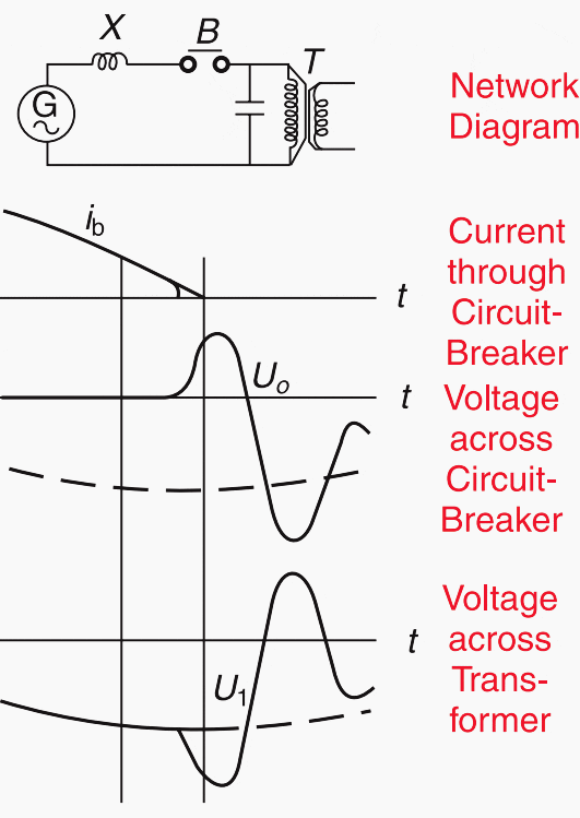

3. Transformer Magnetizing and Reactor Currents
The transformer no-load current and the reactor current impose severe stresses on the circuit breaker upon their interruption because of the low magnitude of these inductive currents. In the case of externally generated pressure there is a tendency for the current to be forced to zero before its natural zero.
This phenomenon is termed as current chopping. This sudden interruption of current leads to severe over-voltages on the transformer side of the breaker. These over-voltages result from the electromagnetic energy stored in the transformer, which is converted into electrostatic energy.
Depending on the dielectric strength of the gap, re-ignitions or re-strikes may occur before the maximum voltage can be reached. As soon as the arc is re-struck it is immediately chopped again, but as the current has decreased during this time, a lower prospective voltage will be induced.
Overvoltages, of the order of 2.5 to 3.5 times the rated voltages, are encountered in normal practice. The basic phenomenon of current chopping is shown in Figure 3.
Disconnection of unloaded transformers - basic phenomena
Figure 3 – Disconnection of unloaded transformers – basic phenomena
The interruption of the reactor current also has the same effect except that the severity on the breaker is more compared to magnetizing current. This is so because in breaking the transformer current, only part of stored energy is released due to the hysteresis and other losses, but in the case of reactor current, the complete energy is released.
In turn, the overvoltages generated in reactor switching are higher.

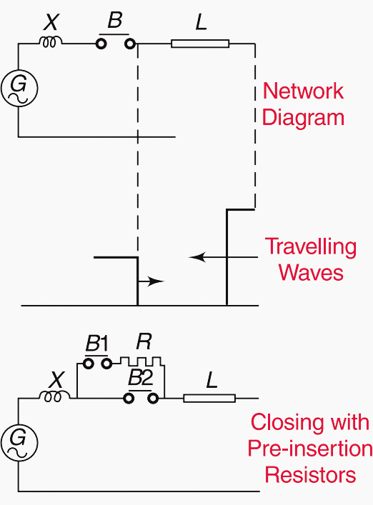

4. Energization of Long Transmission Lines
When an initially uncharged, unloaded long line is charged, then over-voltages to the order of twice the normal voltage are impressed, imposing an onerous duty on the power system. Higher voltages can occur if the line has trapped charges. When a line is switched on to an energized network, a voltage wave is impressed on it. The impressed wave will be reflected at the far end of the line, and if this is open, the voltage will increase two-fold.
In the case of the three-phase circuit, the situation becomes more severe if the circuit breaker poles do not close simultaneously. The wave on one phase will produce an induced wave on the other phase.
The highest over-voltages occur at the open end of the unloaded line when this is being energized or re-energized. Tests have confirmed that these voltages can exceed even 3 p.u., when no special means to reduce them are used.
With the help of pre-insertion resistors, the switching voltages can be reduced to less than 2 p.u.
Energization of unloaded lines - basic phenomena
Figure 4 – Energization of unloaded lines – basic phenomena
The best method of reducing the over-voltages generated on the energization of the lines is to equip the circuit breaker with pre-insertion resistors (see Fig. 4), to ensure that the closing takes place in two stages.
In the first stage, the resistor is included in series with the line to damp the waves. In the second stage, the resistor is short-circuited. The optimum value of the pre-insertion resistance is usually of the same order of magnitude as that of the surge impedance of the line and the insertion time should be at least 10 milliseconds.
The switching over-voltages occurring with energisation and re-energisation of the lines are caused by the system phenomenon and are thus independent of the circuit breaker used. Other means like the controlled synchronous closing of the circuit breaker poles can also be used.

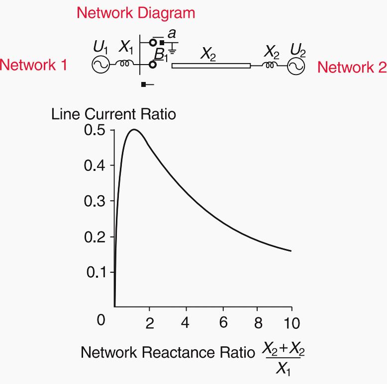

6. Out of Phase Switching
An important requirement to be considered for the circuit breaker regarding interconnection between two different generating systems, is the ability of the circuit breaker to open the circuit when the two systems fall out of synchronism.
If the circuit breakers are rated for the total short-circuit power available at the busbar, the maximum short-circuit current in the tie between the systems under fully out of phase conditions can reach a value of 50 per cent of the rated short-circuit current of the circuit breaker.
For the circuit breaker (B1) in station 1, (see Figure 6) this case occurs if X2 + XL = X1, i.e. if the short-circuit power transmitted from network 2 equals the short-circuit power of network 1.
However this is not a realistic case, because the transmission line in most cases will considerably reduce the power from network 2 as also the current. Studies carried out in different countries show that the current under out of phase conditions never exceed 25 per cent of the rated short-circuit current of the circuit breaker.
Hence the relevant IEC standard recommends testing at 25% of the rated short-circuit current.
Out of phase switching - basic phenomena
Figure 6 – Out of phase switching – basic phenomena
The recovery voltage across a single pole of the circuit breaker can be assumed to be twice the rated phase to earth voltage, if the system neutral is directly earthed, and 2.5 times the phase voltage if the system neutral is not earthed. These values apply to out of phase switching without any prevailing fault on the system.
