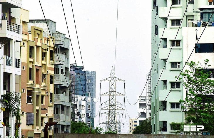

Landowners and developers should be aware of the potential for nuisance and startle shocks (caused by induced voltage) that can occur when someone comes in contact with a large conductive object (eg. a vehicle, building or even fencing) located on or off the right-of-way.
How dangerous are induced currents in transmission towers and poles?
How dangerous are induced currents in transmission towers and poles? (on photo: Hyderabad: Power lines, mostly high tension, pass dangerously near houses in colonies; credit: deccanchronicle.com)
These shocks are known as ‘nuisance’ or ‘startle’ since they will not physically hurt someone, but will be noticed by some people and provoke a startle reaction.
These touch currents occur when a grounded individual touches an ungrounded object while standing in an Electric Field (e-field). Conductive objects when placed in an e-field attract a charge, and a person touching that object can experience an annoying or startling shock when a person’s body provides a path to ground for the current to follow.

Electric fields emanate from any conductor or wire that carries voltage. Higher line voltages produce higher electric field strengths. The closer the conductor is to the ground, the higher the field strength beneath it tends to be, and the increased possibility of shocks.
Larger objects such as a building or a large vehicle have the capability of a larger charge and therefore the shock could be more noticeable. Backyard metallic objects such as swings, portable grills and lawnmowers have been known to deliver similar shocks.

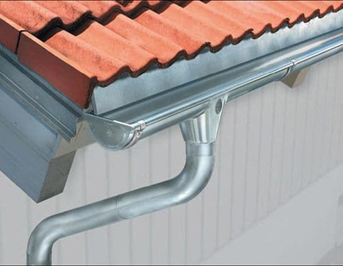

Zinc rain gutters
Zinc rain gutters
In the same manner, rain gutters on a large house fairly close to the transmission line could conceivably deliver a perceptible shock to a person on an aluminum ladder.
Quantitative worst-case analysis of any particular case can be difficult, but it is possible to determine if reducing the potential for perceptible shocks is a prudent precaution.
It is a simple procedure to attach a wire to the downspout and ground it to a metal water pipe or a driven ground rod to mitigate shock effects.

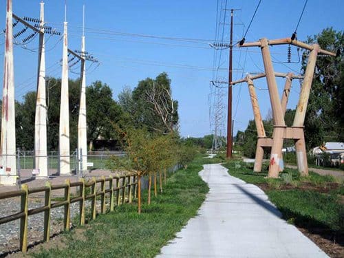

Electric Induction – Fences
Transmission towers next to bikeway and metal fences
Transmission towers next to bikeway and metal fences on Van Bibber Creek Open Space, Jefferson County, Colorado (photo credit: Stuart Macdonald)
Long fence wires that are strung on wooden posts can present shock possibilities if they run more or less parallel and close to the transmission line. The insulation quality of the wooden posts is the controlling parameter. Perpendicular fences will have significantly less induced current and voltage.
When exposed to the weather, even wooden posts are not perfect insulators. The lack of insulation will reduce the induced voltage on a fence wire and will limit the magnitude of a spark discharge.
Nevertheless, some fences could be insulated enough by the posts to make contact currents annoying when the fence is touched. This type of fence would have to be close to the line and quite long before it produced annoying currents. Long fences are often grounded by contact with growing vegetation. If grounded in this manner, electric field effects will be reduced, although magnetic field effects will remain unaffected.
The possibility of annoyance due to electric field induction could be eliminated by solidly grounding the fence at a single point, such as with a metal fence post.
For an “electric fence,” this is accomplished with a special filter designed to drain only the induced charge. However, a fence that is grounded at one or more points and otherwise insulated along a sufficient distance could present some opportunity for noticeable magnetic field induction effects.
Reducing the potential of these effects requires electrically breaking the fence into smaller grounded sections.
