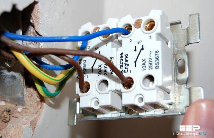

18. Ganged single-pole switches controlling separate light fixtures
This layout lets you place two switches controlled by the same 120 V circuit in one double-gang electrical box. A single-feed cable provides power to both switches. A similar layout with two feed cables can be used to place switches from different circuits in the same box.
Requires two-wire cable.
This layout lets you place two switches controlled by the same 120-volt circuit in one double-gang electrical box
