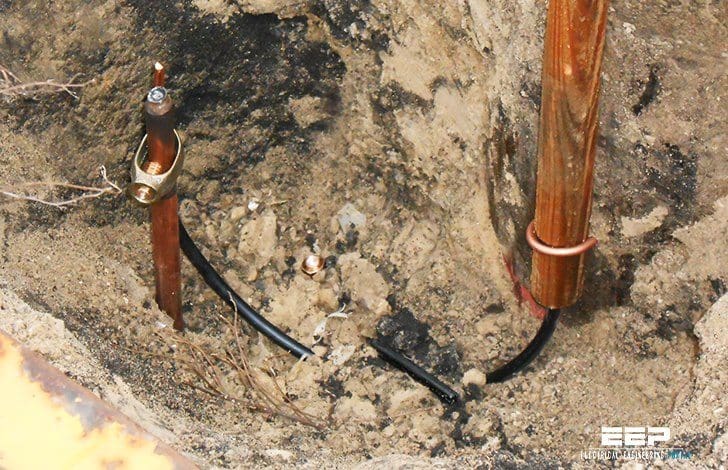

Why is Good Grounding Important And What Can You Do About It?
Why is Good Grounding Important And What Can You Do About It? (on photo: groundwire connected to rod with acorn type connector; credit: irm.org)
The primary aim of a direct strike grounding system is to efficiently dissipate lightning energy into the ground and to help protect equipment and personnel.
