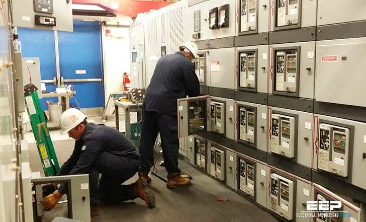

Whether in the design or maintenance of an electrical system, hazards exist if the proper overcurrent protective devices are not selected and applied. Circuit breakers and other electrical equipment also must be maintained and serviced regularly to ensure that they will operate properly when needed.
Why Good Care Of Overcurrent Protective Devices Really Matter
Why Good Care Of Overcurrent Protective Devices Really Matter (photo credit: betest.com)
Unfortunately, in many industries and especially during economic turndowns, the tendency is to limit or eliminate regularly scheduled maintenance on circuit breakers and other electrical equipment.
However, the potential costs associated with OSHA violations, liability lawsuits, workers compensation, equipment replacement, and lost production far exceeds the costs of regular testing and maintenance of circuit breakers and other electrical equipment.
