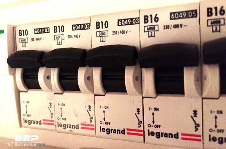

Traditionally, fuses were the main devices chosen for final circuit protection, up until the 1970’s when circuit breaker technology started to become dominant. Today, the three principle circuit protection devices are:
Features of 3 circuit protection devices (MCB, RCCB and RCBO) you have probably forgotten
  1. Miniature Circuit Breakers (MCBs),
  2. Residual Current Circuit Breakers (RCCBs) and
  3. Residual Current Circuit Breakers with Overcurrent protection (RCBOs)
Miniature Circuit Breakers (MCB)
MCBs provide overcurrent and short-circuit protection only and are unable to detect residual current (earth leakage current) unless it is large enough to be classed as an overload or short circuit.
In many applications therefore, RCBOs are a better option, but MCBs are still the most widely used devices not least in older installations.
Also, there are some instances where it may be preferable to use an MCB in conjunction with a separate RCCB rather than an RCBO, as the use of separate devices can give a wider choice of protection characteristics.
