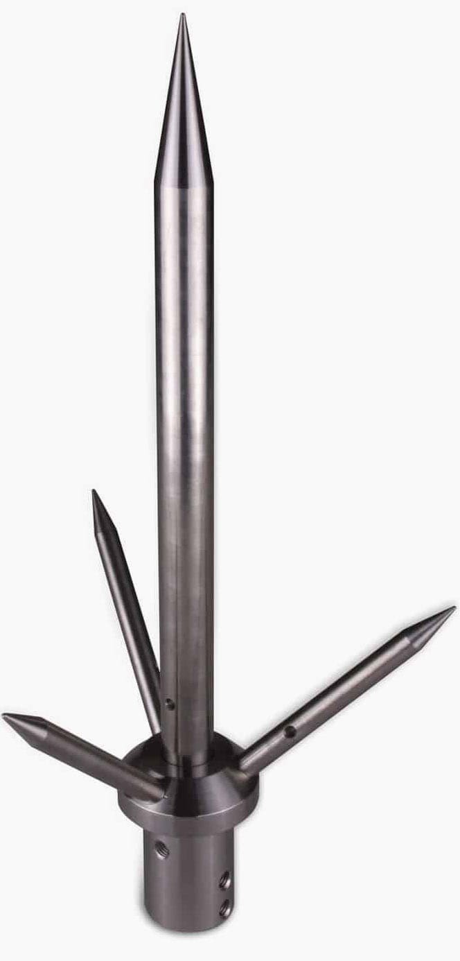

1.1. Single rod lightning conductors (Franklin rods)
These consist of one or more tips, depending on the size of the structure and the downconductors.
They are connected either directly to the earthing electrode of the installation (foundation), or, depending on the type of protection and national work practices, to a special earthing electrode (lightning conductor earthing electrode) which is itself connected to the earth of the installation.

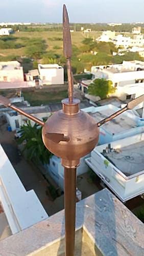

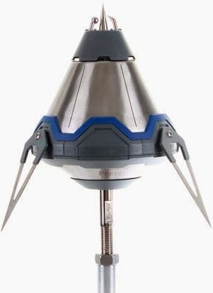

1.2. Lightning conductors with sparkover device
These are a development of the single rod. They are equipped with a sparkover device which creates an electric field at the tip, helping to catch the lightning and improving their effectiveness.
Several lightning conductors can be installed on the same structure. They must be interconnected as well as their earthing electrodes.

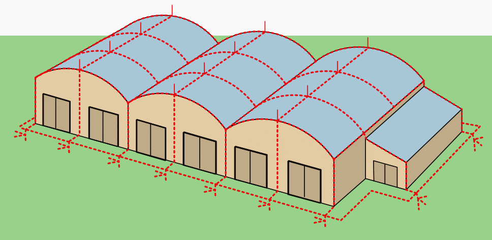

1.3. Lightning conductors with meshed cage
The meshed cage consists of a network of conductors arranged around the outside of the building so that its whole volume is circumscribed. Catcher rods (0.3 to 0.5 m high) are added to this network at regular intervals on projecting points (rooftops, guttering, etc.).
All the conductors are interconnected to the earthing system (foundation) by downconductors.

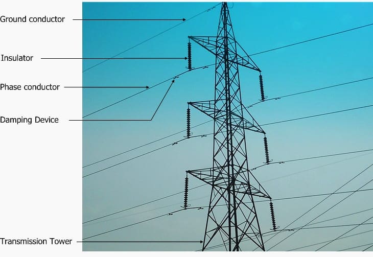

1.4. Lightning conductors with earthing wires
This system is used above certain buildings, outdoor storage areas, electric lines (overhead earth wire), etc. The electrogeometric model of the sphere applies to these.
Transmission tower with ground conductor
Figure 6 – Transmission tower with ground conductor

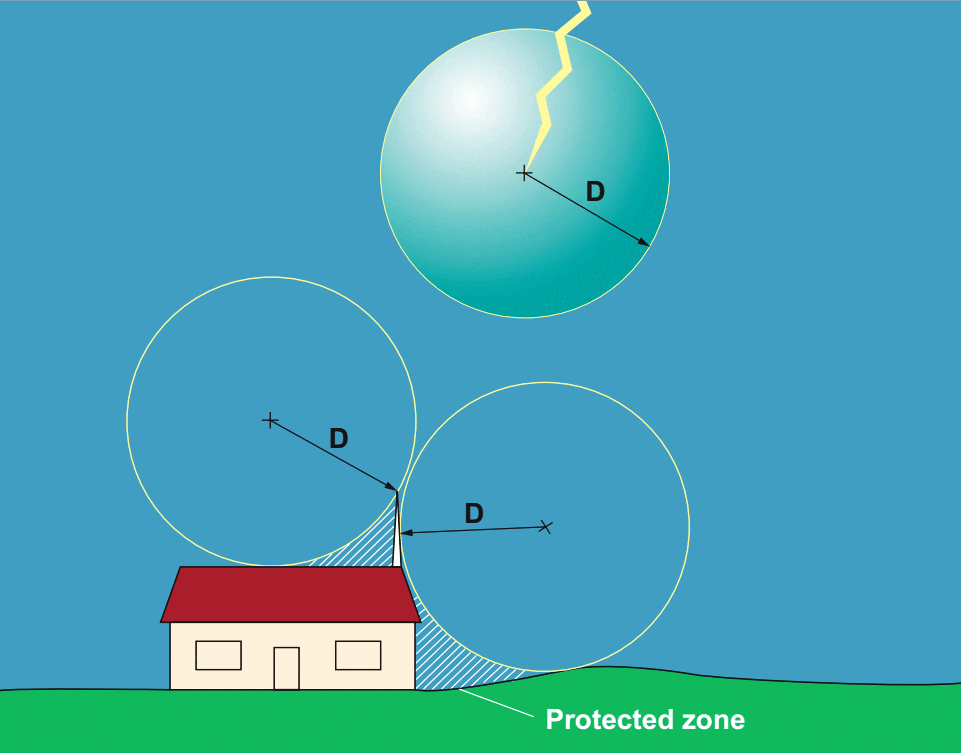

One of these, called the “electrogeometric model” (or imaginary sphere model) method, defines the spherical volume that is theoretically protected by a lightning conductor according to the intensity of the discharge current of the first arc.
General principle of the electrogeometric model
Figure 7 – General principle of the electrogeometric model
The higher this current, the higher the probability of capture and the wider the protected area.
The tip of the leader stroke (or precursor) is deemed to represent the center of an imaginary sphere, with a radius D. This sphere follows the random path of the leader stroke.
The first element to come into contact with this sphere will determine the point at which the lightning will strike: a tree, a roof, the ground or a lightning conductor, if there is one. Beyond the points of tangency of this sphere, protection is no longer provided by the lightning conductor.
The theoretical radius (D) of the sphere is defined by the relationship: D = 10 × I2/3, where D is in metres and I is in kA.

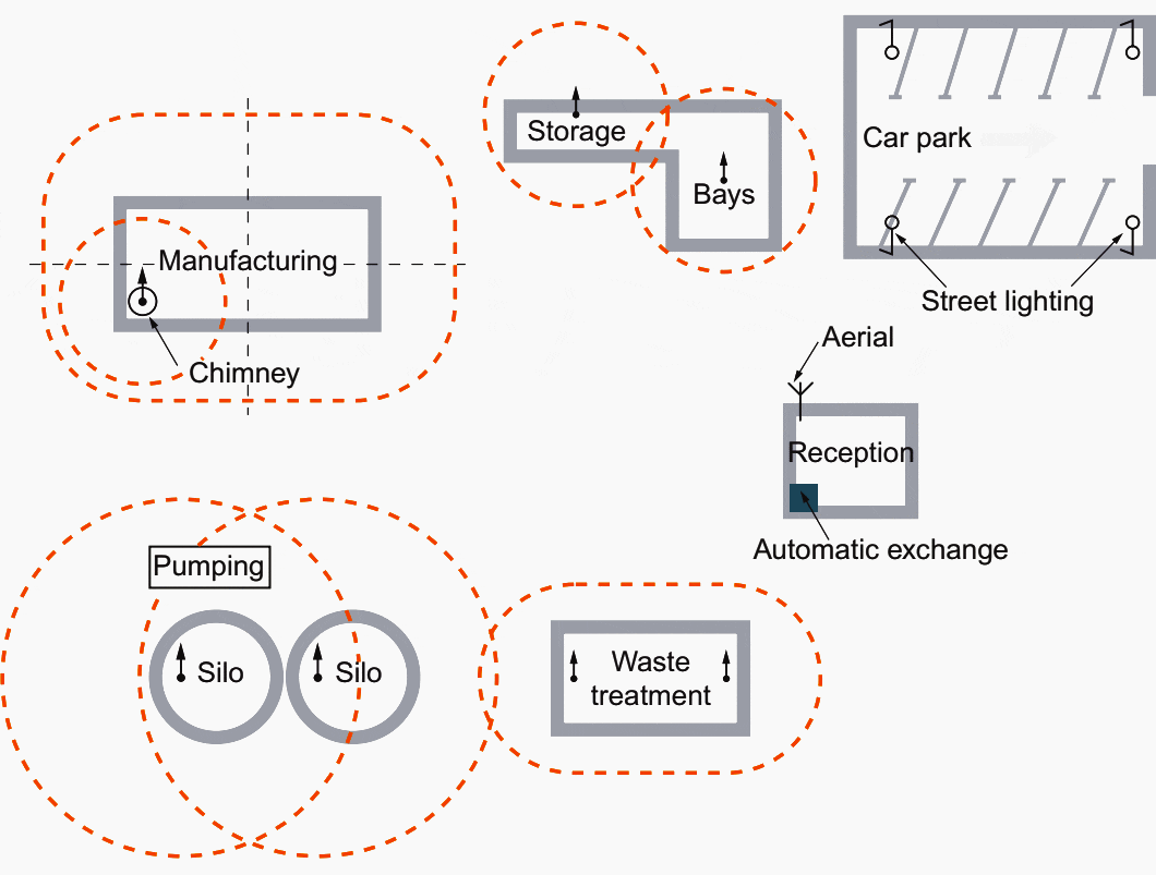

The protection plan must take the buildings and structures to be protected against direct lightning strikes into consideration, but it must also take into account elements or non-built areas for which lightning strikes may cause destructive effects.
Example of a protection plan
Figure 8 – Example of a protection plan
On this (imaginary) site we can see that the sensitive areas: manufacturing, storage, processing etc., have been protected effectively by lightning conductors or by a meshed cage, but that two areas are not protected, as they are considered to be low-risk: reception area and car park.
Further consideration shows that the lamp posts lighting the car park could be struck by lightning and transmit the lightning strike to the installation, and that the reception area which houses the telephone switchboard and the paging aerial (beep) represents an area which is both vulnerable and sensitive.
The pumping station is theoretically protected by the silo lightning conductors which are much higher. A situation which must not however allow us to forget that in this case a sideways lightning strike is possible.

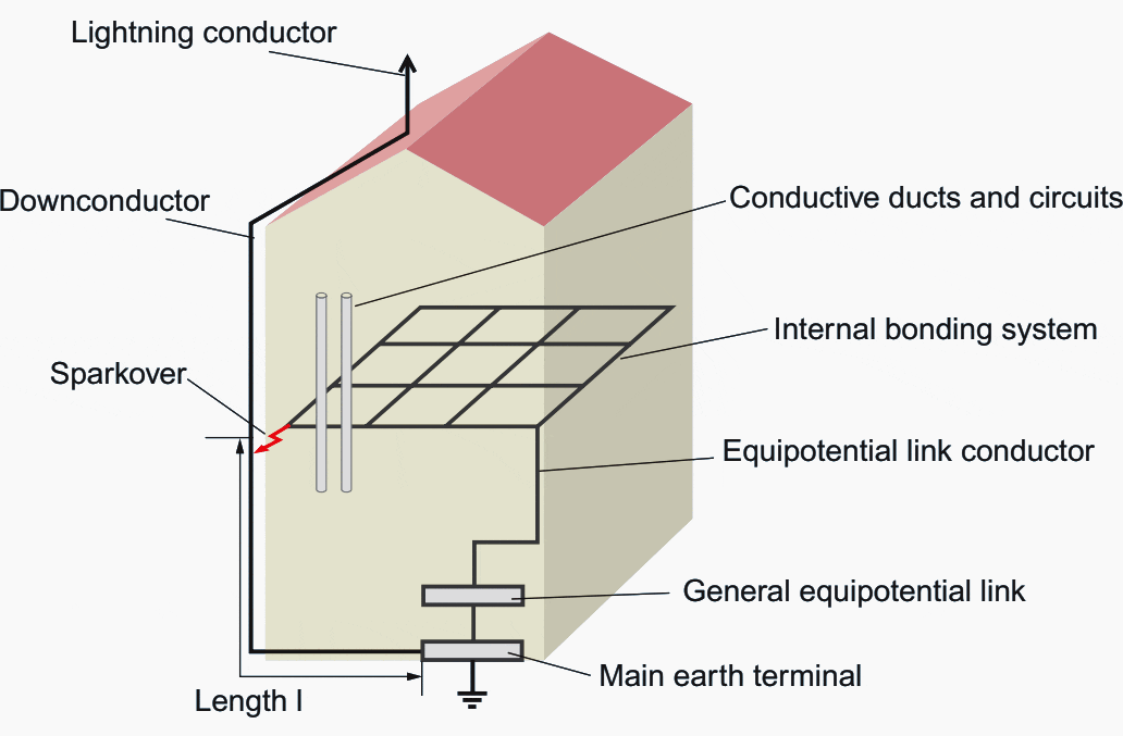

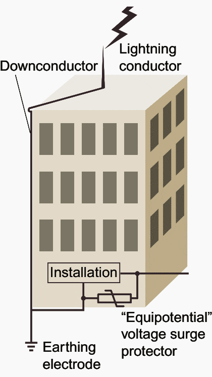

In buildings with several floors, it is recommended that the lightning conductor downconductor(s) are connected to the bonding systems on each floor.
If this is not done, the voltage difference that occurs between the downconductors and the internal exposed conductive parts could cause a sparkover through the walls of the building.
The circulation of the HF lightning current may in fact cause a significant voltage rise in the downconductor (several hundred kV) due to the increase in its high frequency impedance.
