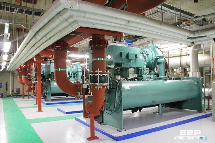

Successful Energy Efficiency In Using Centrifugal Water Chillers Dubai World Trade Center chiller plant retrofit - 39 storey building is air conditioned using (4) four water cooled centrifugal chillers (photo credit: greentechno.com)
