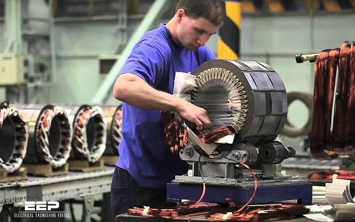

Approximately 300,000 motors are rewound in the UK every year, with an average rating of about 12 kW, so the efficiency of rewound motors is extremely important. The loss in efficiency on rewinding depends on the techniques, processes and skill used to perform the rewind, and is usually between 1 and 2%.

The reasons for increased loss are discussed below. If the choice is between rewinding a standard efficiency motor or purchasing a new high efficiency motor, the difference in efficiency will be 4 to 5% at full load in favour of the high efficiency motor, which will also have a much longer service life.
Generally speaking, there are three factors affecting the efficiency of rewound motors, and let’s talk about each of them //
