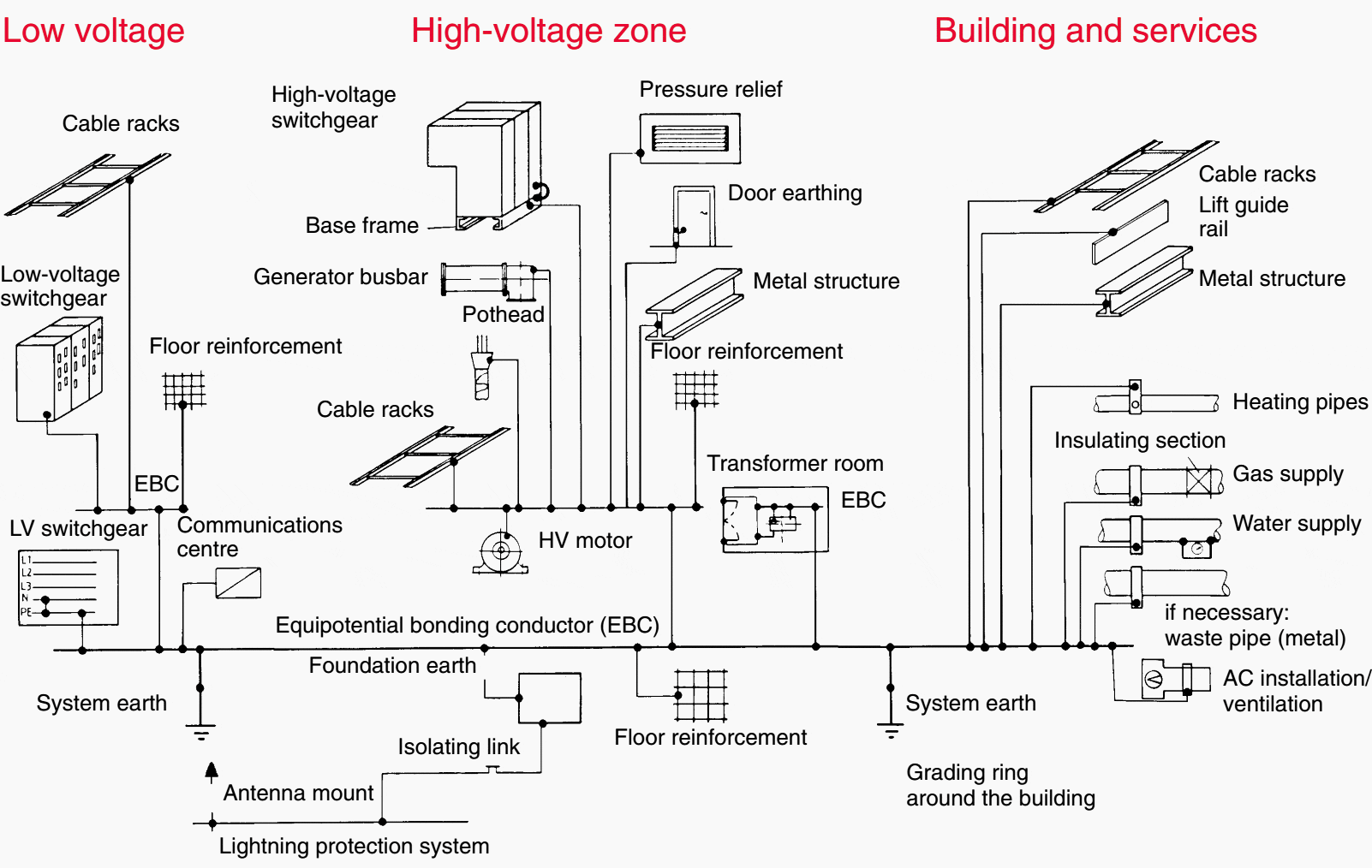

The general layout of a complete earthing system with sections for low voltage, high voltage and buildings and building services is shown in Figure 1. The most important definitions related to earthing are grouped below.

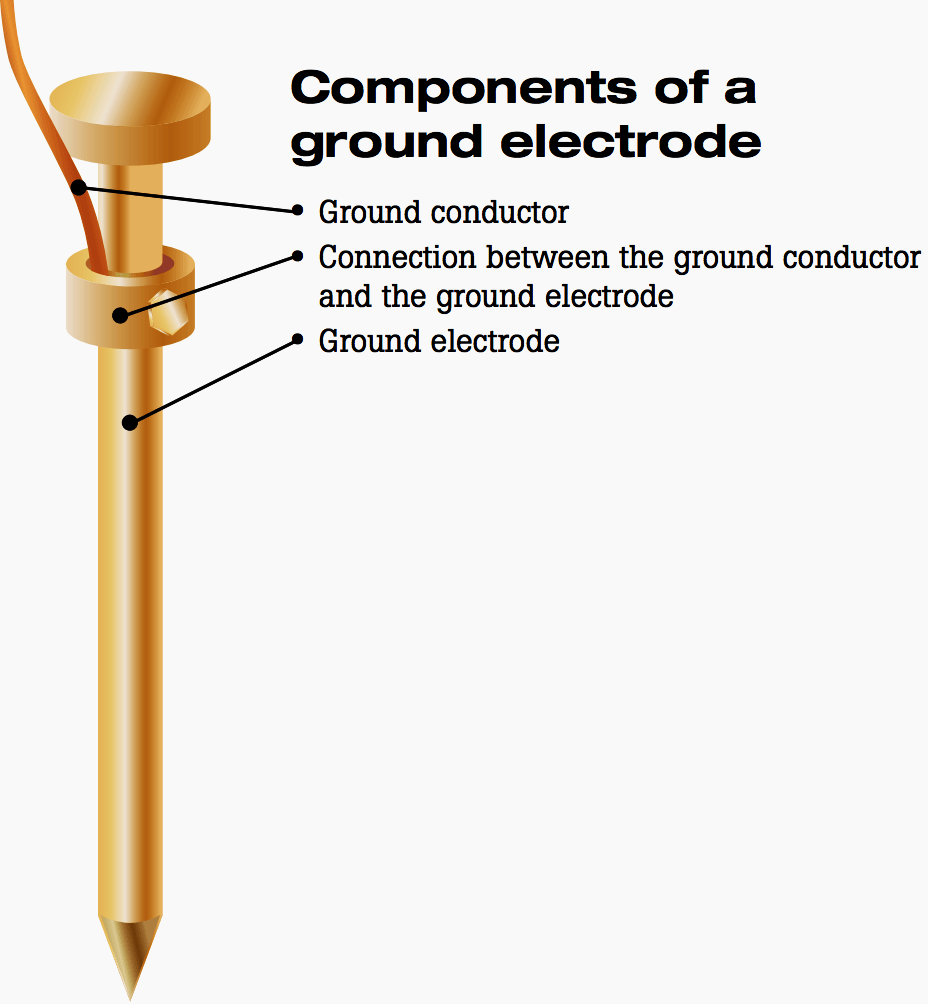

Earth electrode is a conductor embedded in the ground and electrically connected to it, or a conductor embedded in concrete that is in contact with the earth over a large area (e.g. foundation earth).
Components of a ground electrode

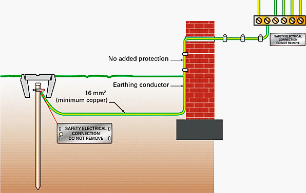

Earthing conductor is a conductor connecting a system part to be earthed to an earth electrode, so long as it is laid out of contact with the ground or is insulated in the ground.
If the connection between a neutral or phase conductor and the earth electrode includes an isolating link, a disconnector switch or an earth-fault coil, only the connection between the earth electrode and the earth-side terminal of the nearest of the above devices is deemed to be an earthing conductor.
Main earthing conductor is an earthing conductor to which a number of earthing conductors are connected.
It does not include:
  1. Earthing conductors joining the earthed parts of the single units of three-phase assemblies (3 instrument transformers, 3 potheads, 3 post insulators etc.),
  2. With compartment-type installations: earthing conductors that connect the earthed parts of several devices of a compartment and are connected to a (continuous) main earthing conductor within this compartment.
Earthing conductor connection

Earthing system with equipotential bonding between HV/LV indoor switchgear and building/building services
Figure 1 – Earthing system with equipotential bonding between HV/LV indoor switchgear and building/building services

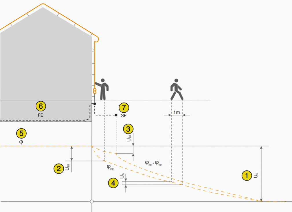

Electrical potential on the earth surface and voltages as current passes through the foundation earth electrode (FE) and control earth electrode (CE)
Where:
  1. UE – Earthing voltage
  2. UB1 – Touch voltage without potential control (on foundation earth electrode)
  3. UB2 – Touch voltage with potential control (foundation earth electrode and control earth electrode)
  4. US – Step voltage (without control earth electrode)
  5. φ – Earth surface potential
  6. FE – Foundation earth electrode
  7. CE – Control earth electrode (ring earth electrode)
Earthing voltage UE is the voltage occurring between an earthing system and the reference earth.
Earth surface potential φ is the voltage between a point on the surface of the earth and the reference earth.
Touch voltage UB is the part of the earthing voltage that can be shunted through the human body, the current path being through the human body from hand to foot (horizontal distance from exposed part about 1 m) or from hand to hand.
If there is a lightning stroke, the lightning current is routed through the down-conductors into the earthing system and the earth. The resistance of the down-conductor and the earth causes a voltage drop, which can lead to so-called touch voltage.
The touch voltage is the voltage between a component (e.g. the down-conductor) and earth potential. The current flows from the hand to the foot through the body. The potential hazard must be reduced by technical measures, e.g. a control earth electrode.
Step voltage US is that part of the earthing voltage that can be shunted by a person with a stride of 1 m, with the current path being through the human body from foot to foot.
Potential control consists in influencing the earth potential, particularly the earth surface potential, by earth electrodes to reduce the step and touch voltage in the outer area of the earthing system.

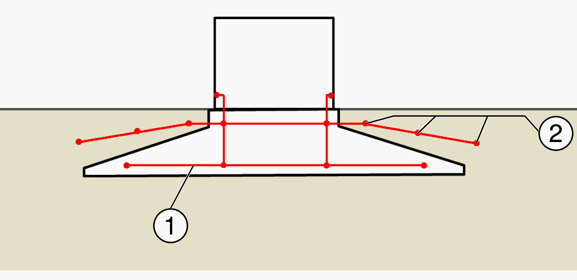

Foundation earths are conductors embedded in concrete that is in contact with the ground over a large area . Foundation earths may be treated as if the conductor were laid in the surrounding soil.
Foundation and ring earth electrodes of a wind power plant
Where:
  1. Foundation earth electrode
  2. Ring earth electrode
Control earth electrodes are earth electrodes that by their shape and arrangement are more for potential control than for retaining a specific dissipation resistance.

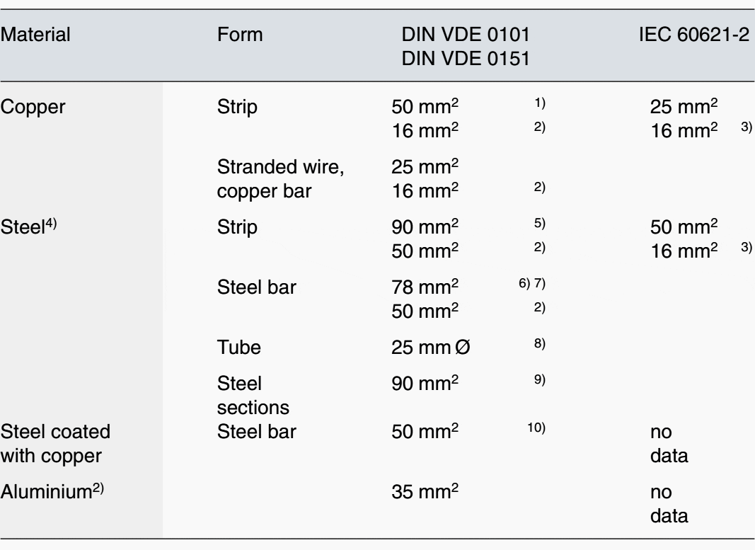

Earthing material
Earth electrodes (under ground) and earthing conductors (above ground) must conform to specific minimum dimensions regarding mechanical stability and possible corrosion resistance as listed in Table 1.
Table 1 Minimum dimensions for earth electrodes and earthing conductors
Where:
    1. Minimum thickness 2 mm
    2. For above-ground earthing conductors only
    3. For conductors protected against corrosion
    4. When laid in the soil: hot-dip galvanized (minimum coating 70 µm)
    5. Minimum thickness 3 mm (3.5 mm as per DIN 48801 and DIN VDE 0185)
    6. Equivalent to 10 mm diameter
    7. With composite deep ground electrodes: at least 16 mm diameter.
    8. Minimum wall thickness 2 mm
    9. Minimum thickness 3 mm
    10. For steel wire, copper coating: 20 % of the steel cross section (min. 35 mm2), for composite deep ground electrodes: minimum 15 mm diameter
